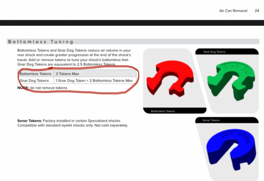

I pulled up the manual and it does not appear that the shock has tokens installed necessarily. It does say “certain Specialized shocks have Sonar tokens“. Can anyone confirm this? It would seem that I would want to add tokens and not remove them though?:unsure:

I have the exact specs on mine, but can't find where I got them. I had to enter the serial # for my shock - ahh, found it. Mine is a deluxe select+. If you look just below SPECIFICATIONS there is a place to enter serial #. If you have a different model, you should be able to find your own way (or cry :rolleyes: ) Deluxe Select+ - RS-DLX-SELP-B2 - RockShox
If you're running 40% sag - take the tokens out. I did, then I ran higher pressure and it was good, more linear. You will need more pressure once the tokens are out but you will still use more or all of your shock and have correct sag!
Then I started playing on small jumps and drops. Started adding more and more psi and ended up at 20% sag. I put the tokens back in and did a long overdue service :LOL:. I'm probably at 25% sag now but have about 7mm free after my little jumps etc. I like that buffer - I'm sure I'll use it soon enough on a bigger jump or when I have poor form. I've been doing a rowdy black downhill run without giving the change any thought - everything felt the same. That's on a trail bike (130 rear, 135 front).
If you rarely play on jumps, flipping the compression lever to stop pedal bob is very effective at adding some bottom out protection. On the 35 gold rl forks, 3 clicks of compression damping is equivalent - any more and it stops being a suspension fork (on mine) :rolleyes:. I have since pressured up my forks too now, at about 25% sag too. I may look at tokens for it, but it feels OK.
Forget about whatever anything (or anyone) says, and set the shock to what is right for YOU. I suggested removing tokens because you said you did not have an 'acceptable ride'. I don't know if you have tokens in your shock or not, all I know is that my Deluxe had 3 in it. It was very harsh, I struggled to use anything like the 160mm wheel travel and the rate of progression was massive.
In a nutshell, you want to use nearly all the available travel for the type of riding you do. If you are not getting anywhere near to bottoming out (set with the correct sag) then remove tokens. It really is that simple :)
The description of the performance you were getting is an exact to what I have found. I’ll open up the shock this weekend and see what I find And take it from there.
