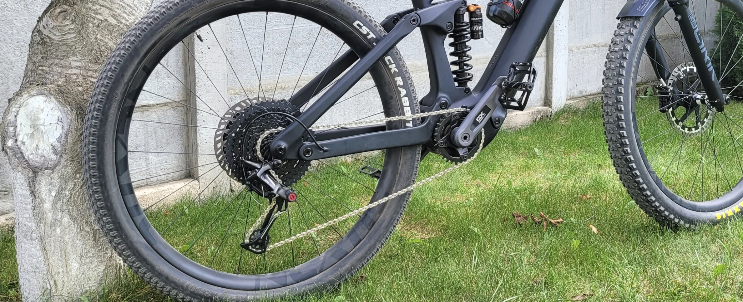

In 2020 I assembled my Dengfu e10 gen1(switched to cef50) with 9-speed 11-50 Box components, box2 ver. Also a compatible cassette is a Sunringle 11-50
Prove me I am wrong :)View attachment 187270
I think you mean SunRace, not SunRingle. SunRingle only makes wheels, not cassettes. The Box Components cassettes are very reasonably priced, but I had hoped that with only 9 cogs they'd be lighter weight just due to less material, so I was disappointed to see they weigh 600+ grams. That is similar weight to Linkglide, but with 2 less cogs, and I would guess that Linkglide would also have better durability.
