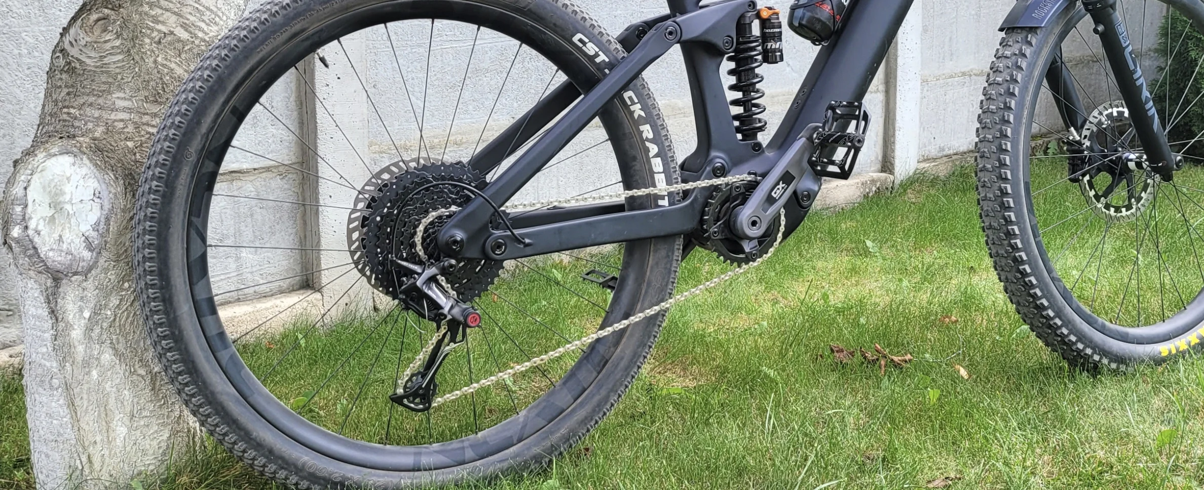

I have an Avinox motor, and I use all of the gears!
We live in the swiss alps, with a lot of very steep trails in the mountains. For longer trails, you cant always use turbo for the climbs, so I definetely use the smallest gear a lot.
I had a gen2 Levo befor, with "only" 11 gears, and I struggled a lot, by not having a real small gear...
Daily trip around 1000m of elevation by 20km distance
Weekend trips 1500-2000m of elevation, 30-40km
