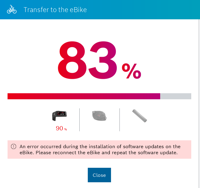

BDT with the patch works offline and allows programming. I managed to activate the lighting. If anyone has the US software, please upload it and maybe the topic of removing the restrictions will become publicly available.
This patch doesn't work for me. And even with a correct 1.2.3 crack, this version cannot connect to gen5 bikes. And you can't do anything else other than turning on/off the lights, activating power ports, other small changes. That is IBD programming, almost all the stuff you can already do on the display or in the app.
For newer versions (16.x, 17.x, etc.), even if you have an OEM crack and configuration container files (.cff4, .bpc, .db), you still need a private key stored on the OEM dongle (YubiKey) to sign the configuration sent to the bike. After sending a valid config that is incorrectly signed, because you don't have a certificate+private key, the bike will reject it. Bosch is such an anti-consumer brand that they place certificate checks on the bike itself, preventing you from repairing the bike yourself

It is impossible to flash the configuration file in production without an OEM dongle or a legitimate OEM account, because applying the configuration is cryptographically signed. Game Over!
So the software is good for diagnostics, clearing errors and basic settings...similar to what Bosch dealers have, but OEM production features cannot be used.
