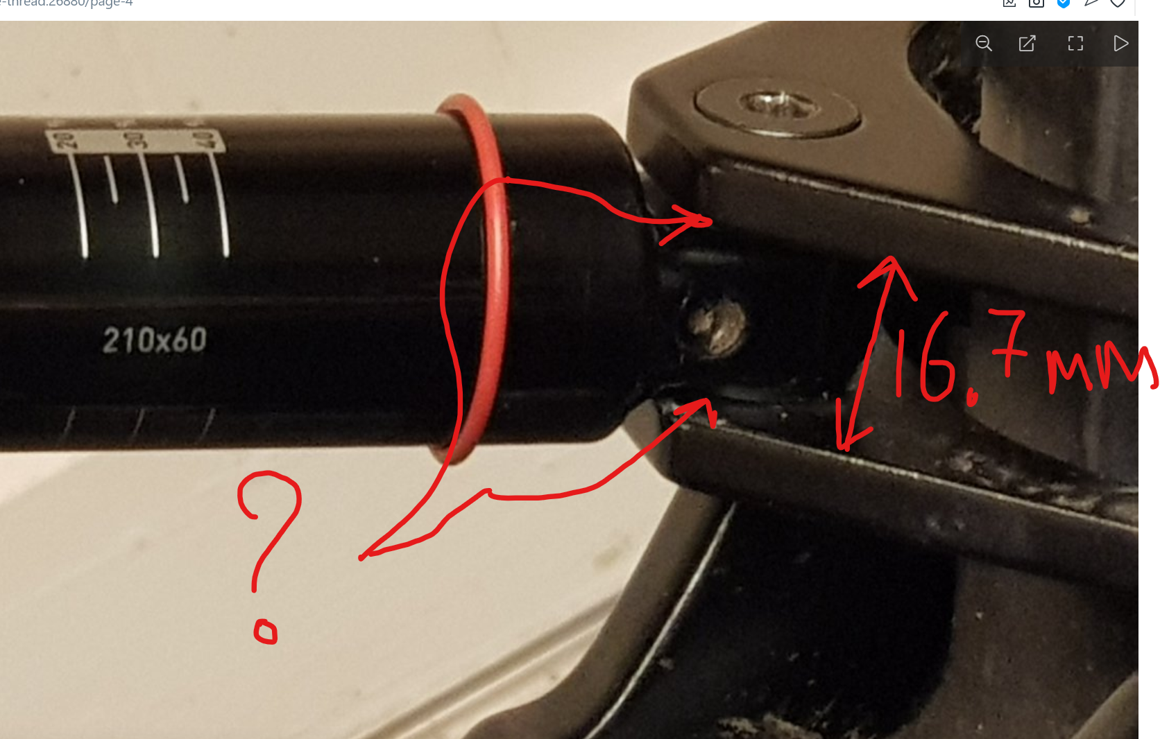

What kind of the rear shock bushing you used here? I measured the space and it is 16.7mm. But I can not find any rear shock bushings for 16.7mm, they all start from 22mm.

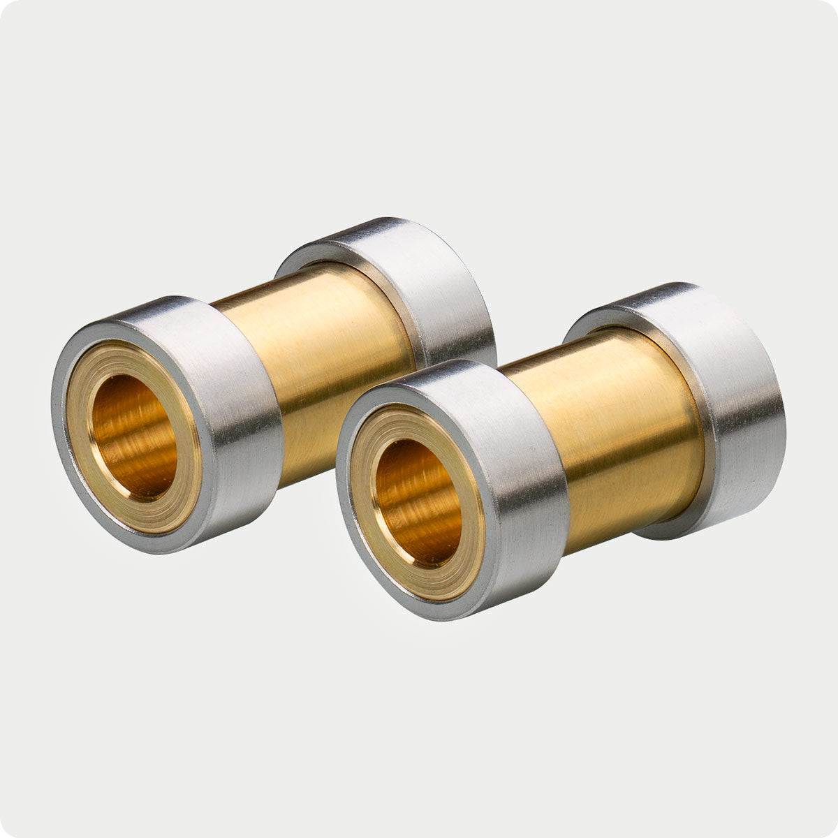

In addition, once you've sourced your rear shock (230x60), be sure to reach out to @Offset. They have recently a dedicated page for bushings for the E22 frame.

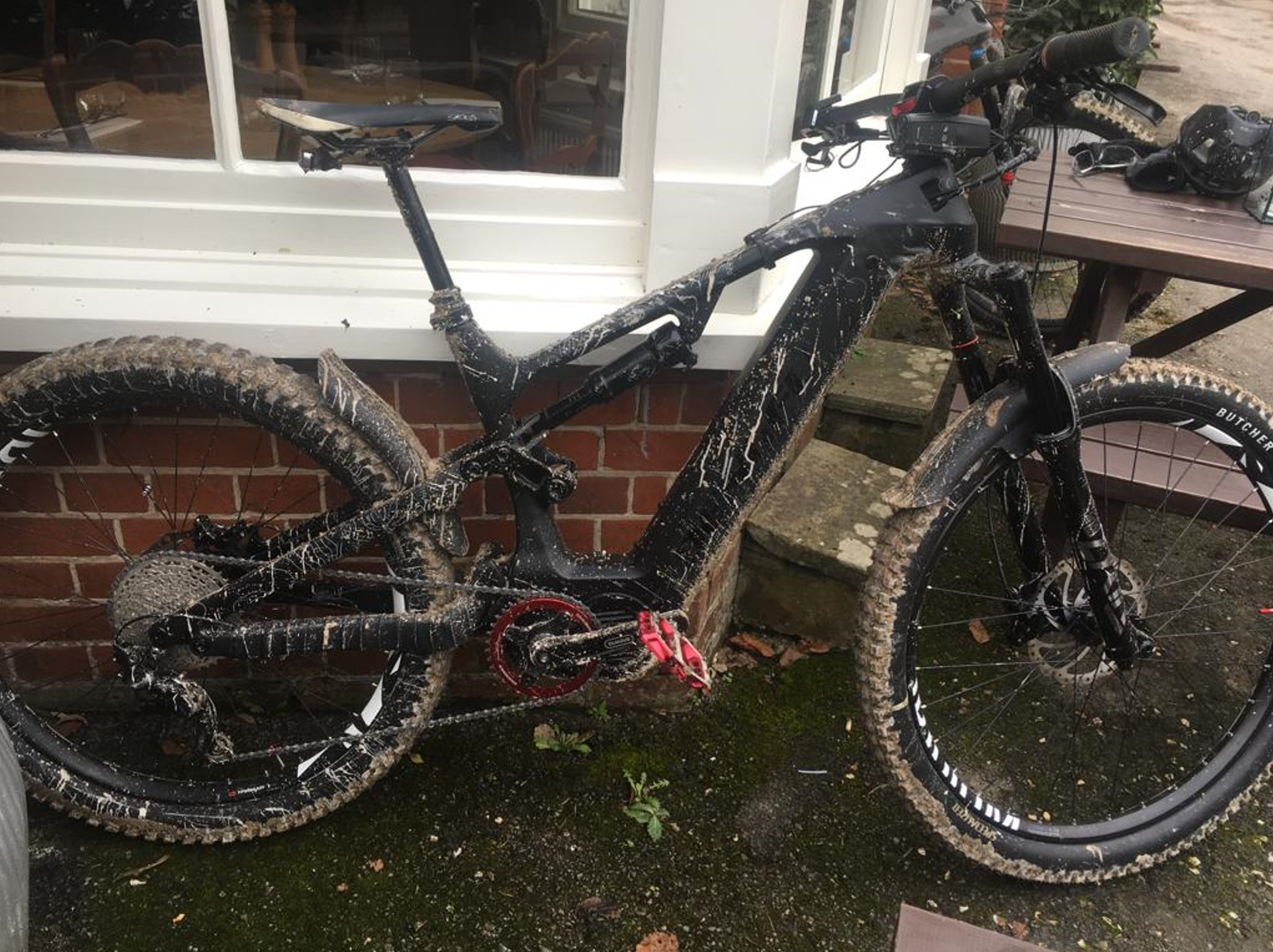

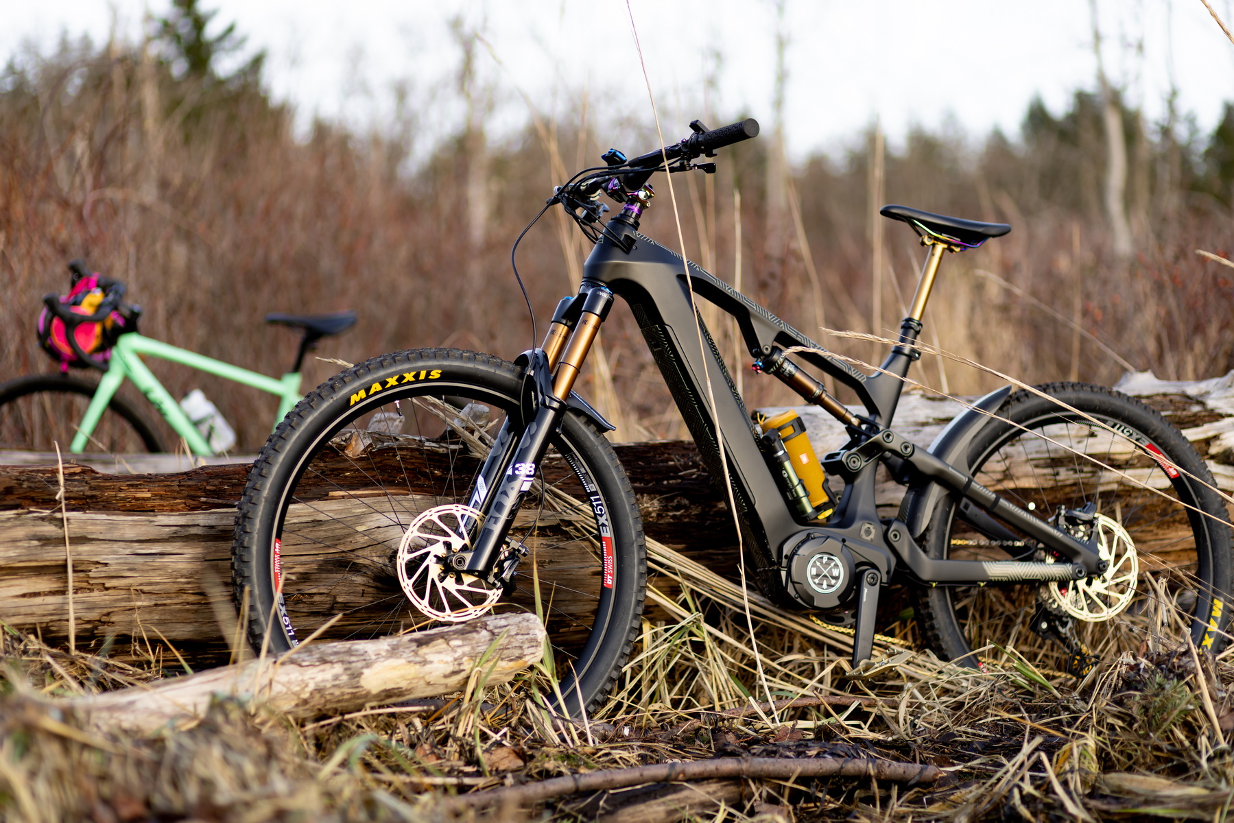

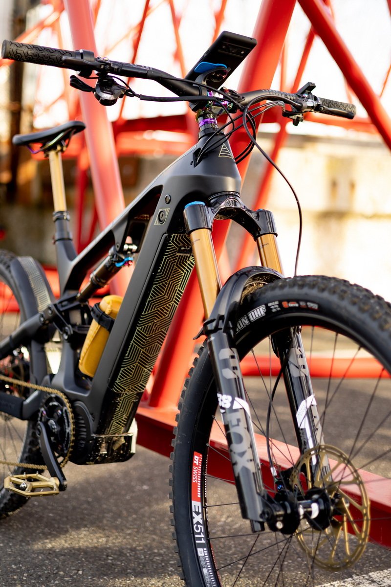

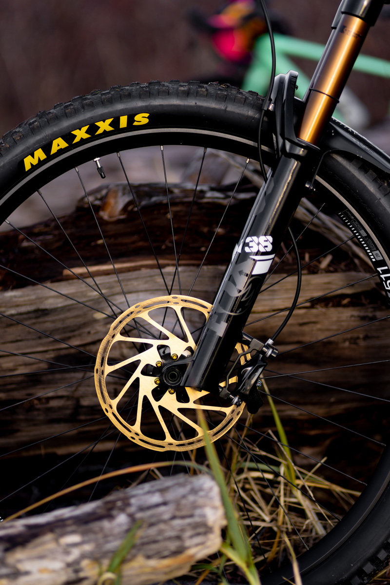

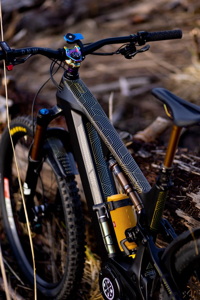

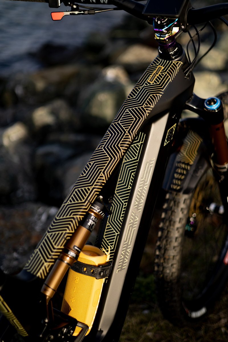

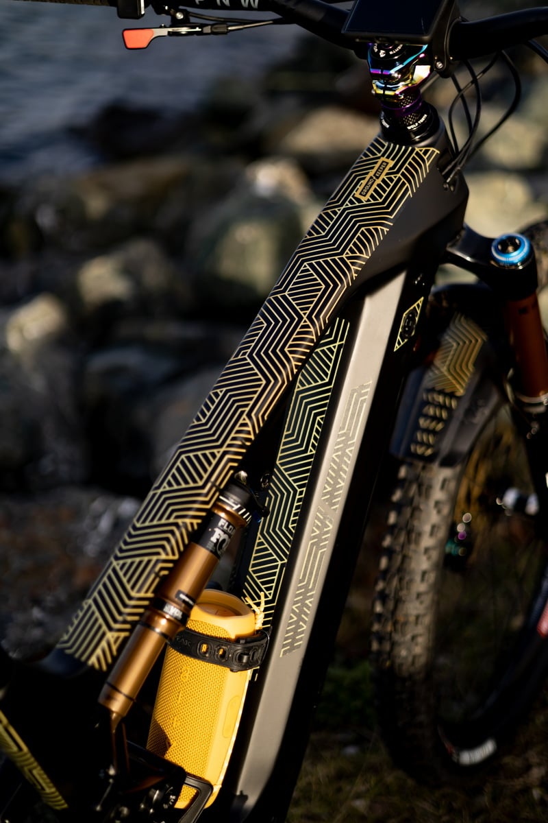

Gave my bike is first proper ride at the weekend - and an interesting new paint job...
The weather has been awful here, but couldn't wait any more, so decided to brave the cold and avoid the mud.
Overall I'm super-impressed, the bike is brilliant, composed and comfortable.
Not the biggest ride, 23 miles and 1900' of climb, mainly off road. Battery was just a touch under 60% when I got home (peddled hard but wasn't shy with the juice).
Defo a few tweaks to make, but overall really happy.

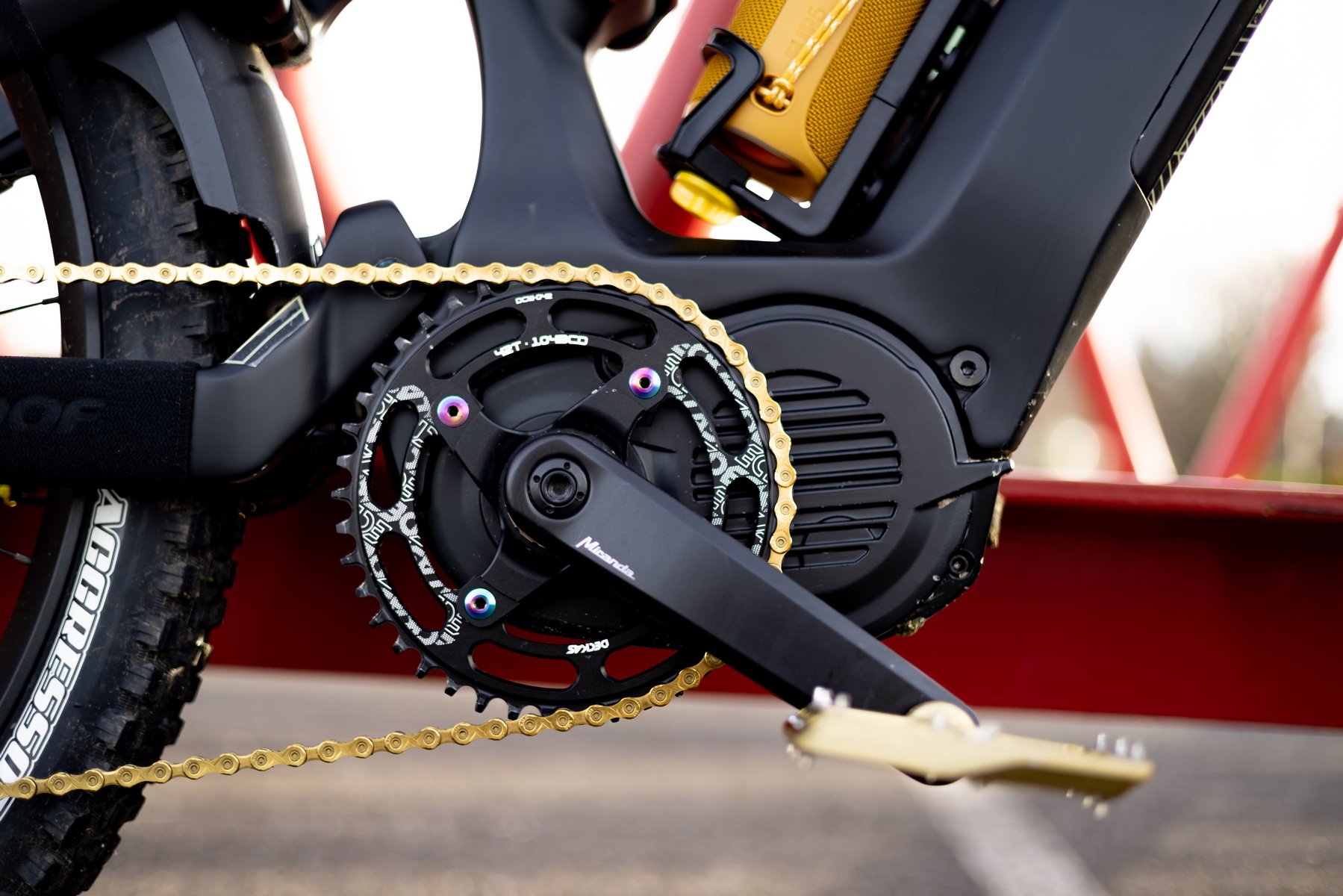

An aside: The M620 is REALLY loud compared to my BBSHD, I'm sure I'll get used to it. I've read that the stock grease is a bit crap and interested if anybody has serviced their motor and whether that made a difference.

I have an Innotrace M620 with I think Motul grease (an option when ordering) and I have to say the motor is just slightly louder than Bosch, I was surprised in this regard.
