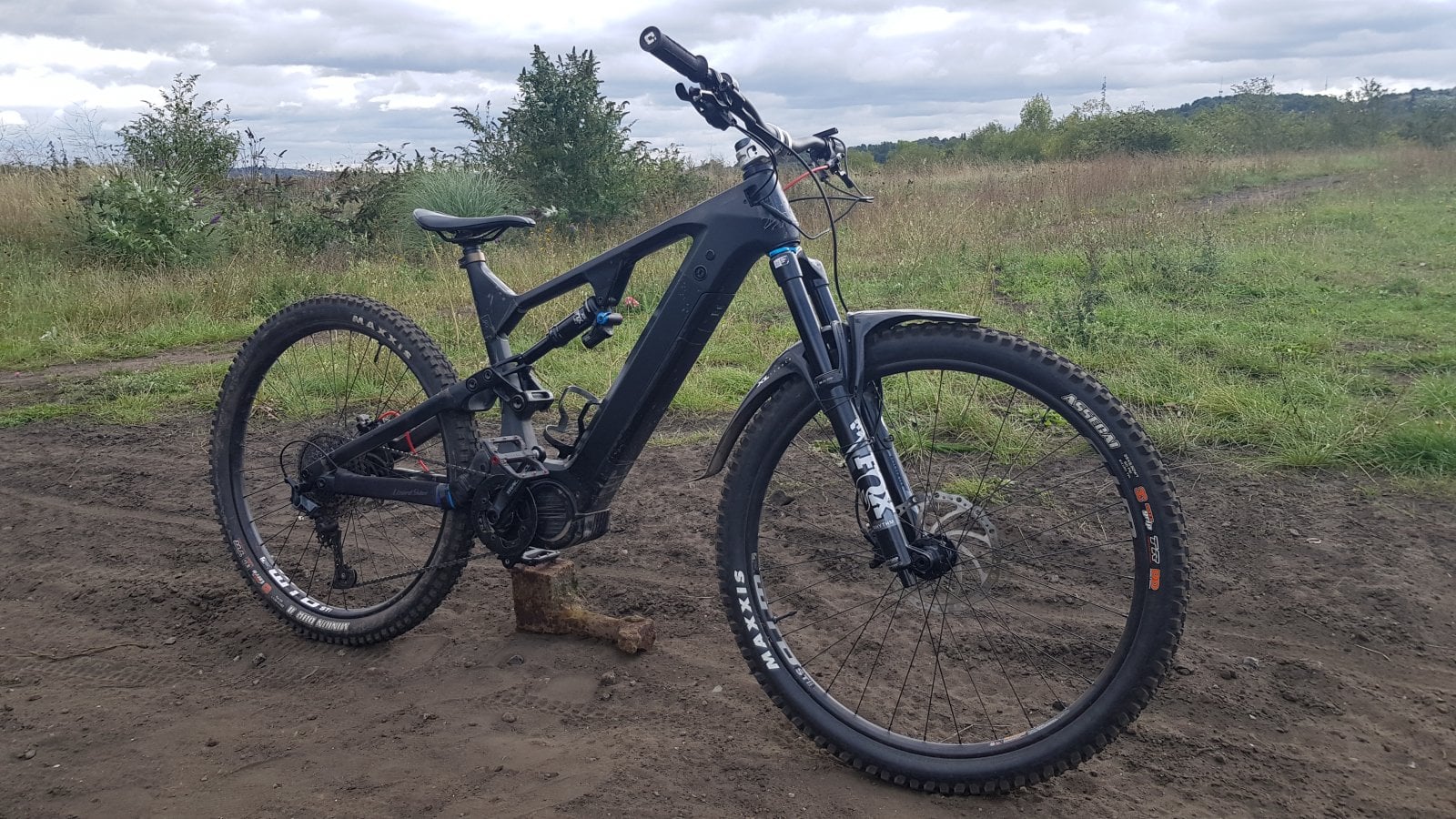

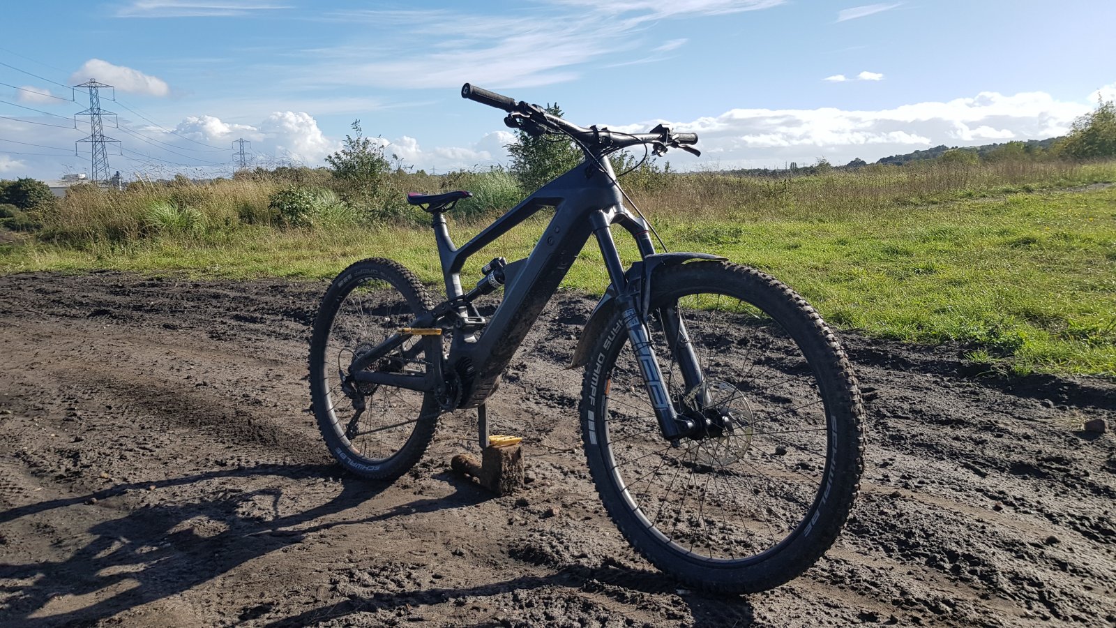

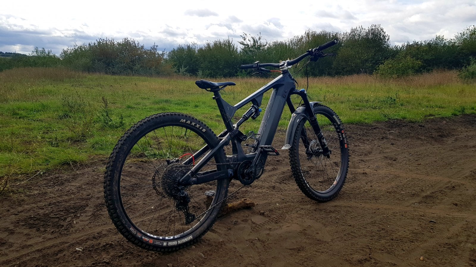

My E22 build so far
1. Fox 36 44mm offset 170mm travel 29er with 2 volume spacers at 90psi
2. Fox DPX2 230x62.5 Metric rear shock with 0.8 volume spacer at 270psi (30% sag)
3. One Up 210 dropper seatpost (31.6mm diameter) with Giant Forward saddle
4. WTB STI30 29er wheelset 15x110 & 12x148 boost (shimano HG)
5. Maxxis Assergai 29x2.5 front tyre
6. Maxxis Minion DHR2 29x2.4 rear tyre
7. Shimano M7100 drivetrain 12spd (11x52t) with 32t chainring with Christini 104bcd adapter
8. Bontrager Line Handlebars 820mm wide 35mm diameter with 25mm rise
9. DMR Defy stem 35x50
10. ODI Elite Pro grips
11. Meroco 4pot brakes with sintered pads (using Shimano M420 levers and 203mm) rotors front and rear
12. Raceface Aeffect cranks 165mm with Funn Magic pedals
13. Works Components 2° angle headset (44x56)
14. Eggrider v2 display
15. Crud guard xl mudguard
16. M620 motor (UART) custom programmed but still using stock controller
17. Nukeproof rear axle
I may have missed something. But I know some have asked about my E22 build. So hopefully, this post will be helpful 👍🏿

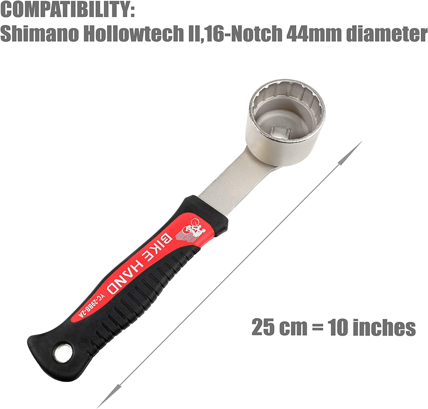

as for all tools I (remember) needed.
metric allen keys
cassette socket
diy headset installer made from 2x4 wood and all-thread
brake bleed kit
small hammer (crank arms may need a few taps)
hacksaw (steerer tube)
sidecutters (cables/hose)
the BIKEHAND tool I posted about:
Neeko's first assembly pics are more than enough once you get the parts in hand!
just make sure you get
uart motor + program cable
shock bushings 1/2"x8x16 and 1/2"x8x32
headset spacers
shifter cable housing
rimtape
spare chains you may even have to join them to make it long enough

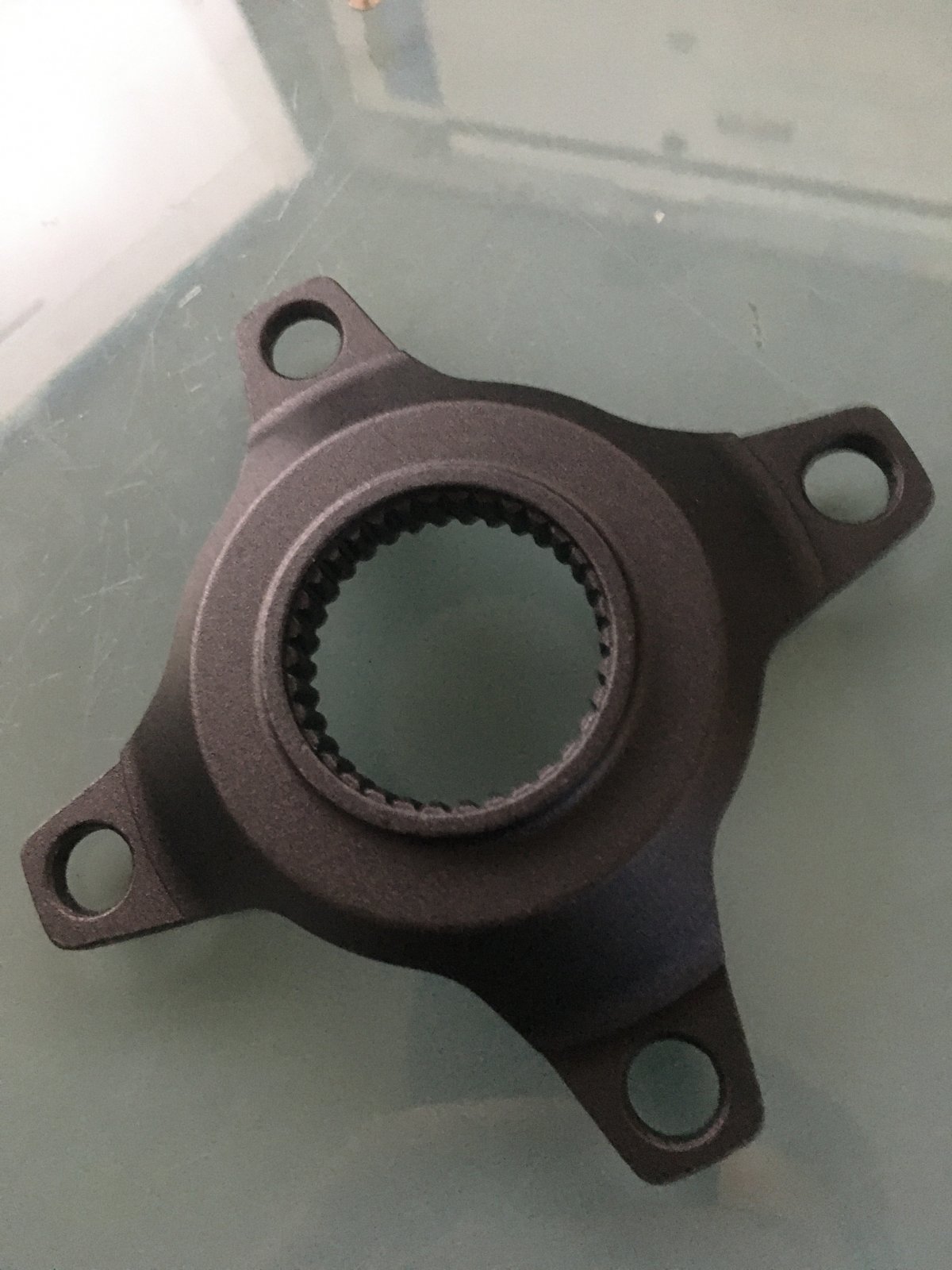

Watch my video regarding the spider from greenbikekit for a surefire way to get your chainlength.

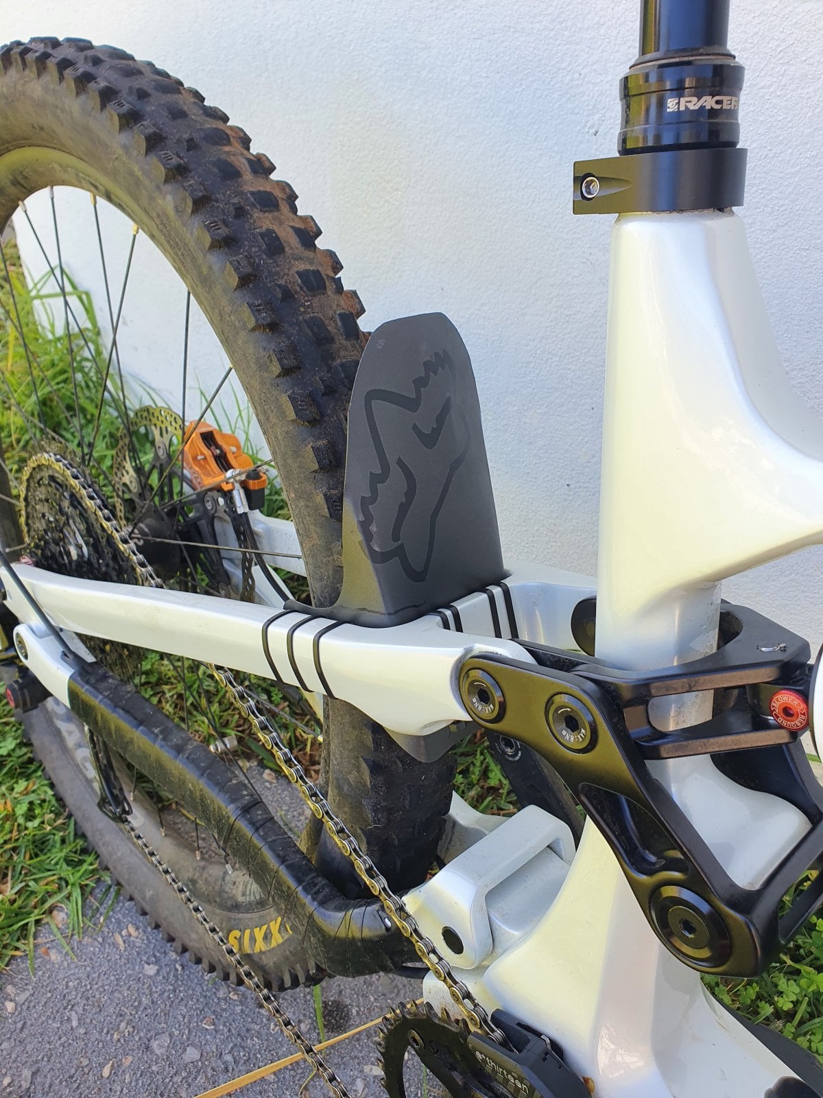

A few little mods.
E13 chain guide and some old mudguards. The chainguide works brilliantly. Haven't dropped a chain since I fitted it. The mudguards not so such. I'm sure they do something, but you still end up coated it mud.
If you look closely through the chainring, you can see some damage caused by dropped chains.
Hi Mate, where did you get the chain guide ? How did you managed to fix it? Thanks a lot

Just received my 104BCD spider from GreenBikeKit,, what size chainrings are you guys using (I have an 11-42 cassette on my bike)?

I use 36t front on the greenbikekit 104 spider with 1 spacer of approx 2mm. I have only a small amount of clearance to the chainstay makes some contact during ride but nothing the protector cant shrug off.
