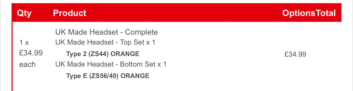

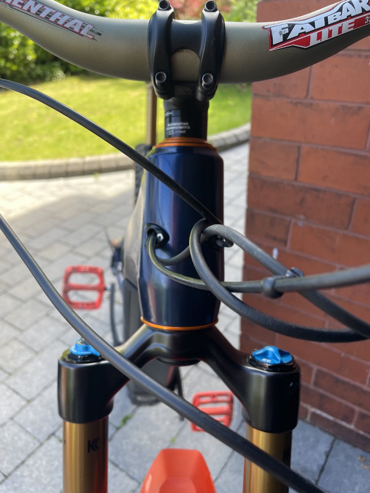

Can anyone recommend a low profile compatible top headset to replace the fsa one … having a too short steerer tube scenario..
Something like this? What have you done? Cut the steerer??
Thanks man , will give that a try, took a punt on a second hand fork without throughly thinking through measurements …. Amateur hour ??
superstar components upper headset is slightly lower profile. Just changed myself
Type 2 ZS44 for the upper

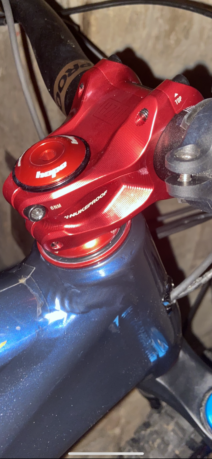

We fitted mine with no press, slightly scary , hammer and chunk of wood scenario ? got my headset on , stem very tight fit .. with a 1 mm spacer . All clamped well and feels grand .

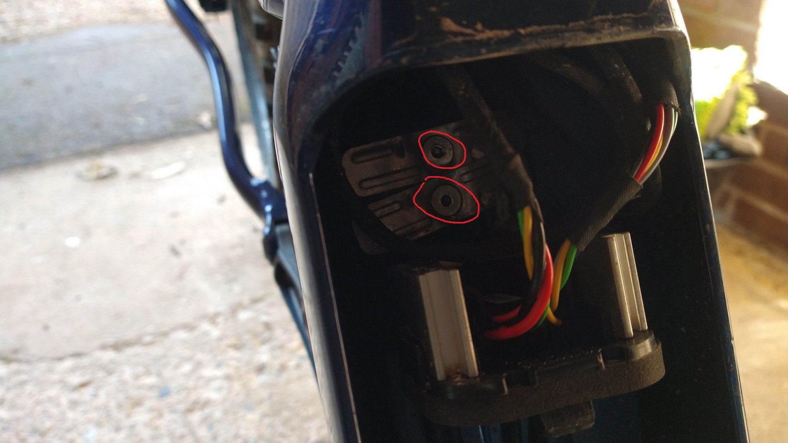

Can anyone with a 625 battery fitted give me a measurement of the bottom plate to top . Shop that fitted my 625 battery have done it to loose and the battery rattles now ..
Can probably measure up for you tomorrow but you should be able to get a snug fit by loosening off the two allen bolts on the lower bracket, moving it up a bit & nipping them up. From memory, this trial & error method is how I fitted mine & it hasn't fallen out yet...
Thanks man will do that .
Not much of a picture but this is what needs loosening. To fit the longer battery, the LBS would have had to rotate this bracket 180 degrees & do it up again. It will be obvious when you take the battery out.

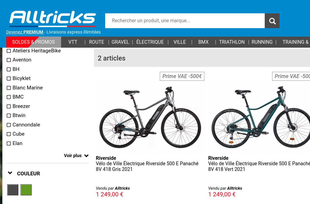

Interestingly, Alltricks have started stocking a couple of Decathlon bikes. Not sure if this is a sign of things to come where others might stock/sell some decathlon bikes. Might make buying future Stilus type bargains easier if it ever happens again like that ..
