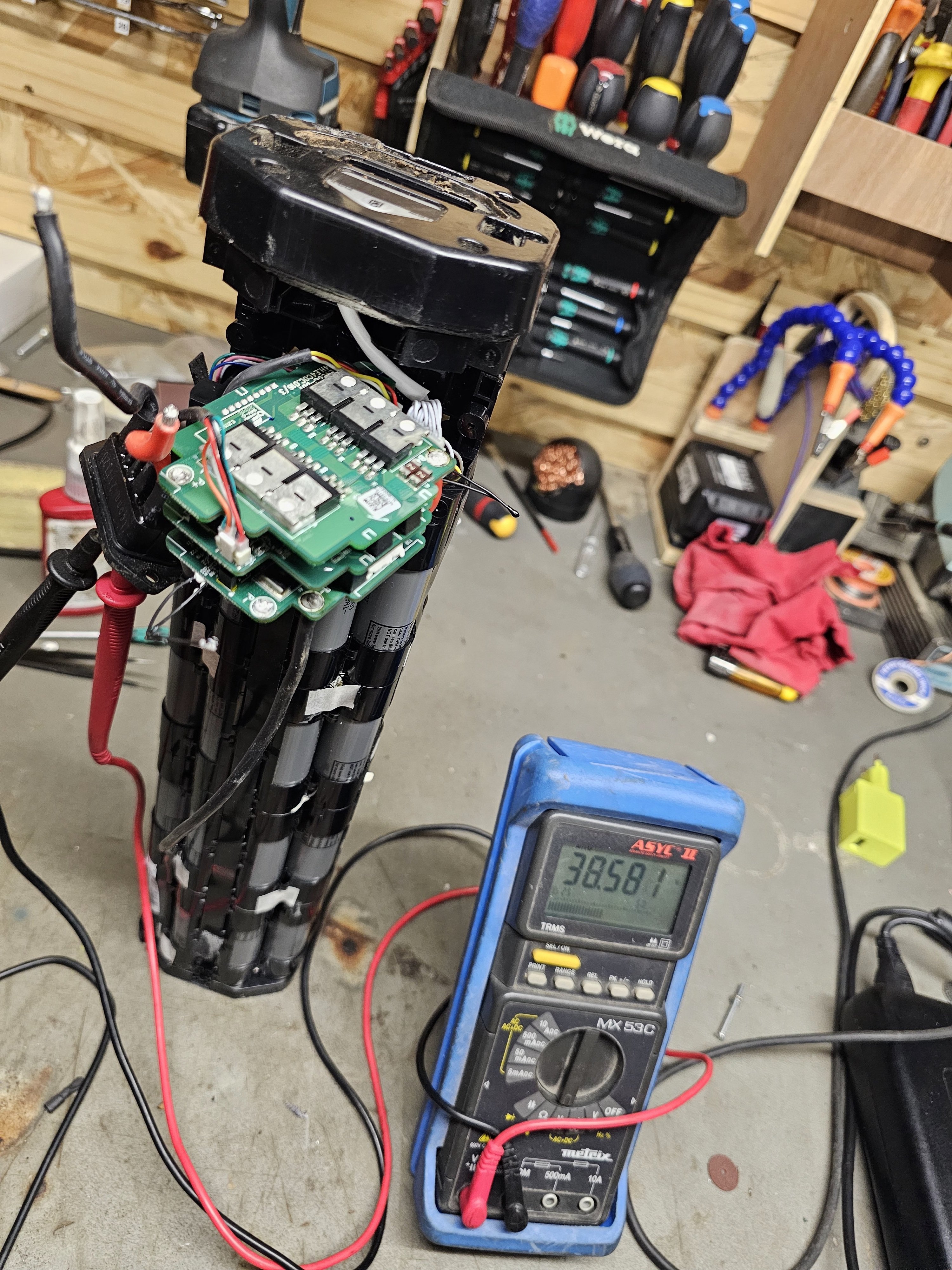

Hello everyone,
I'm posting here about an issue with my Darfon E4C0G battery (Shimano EP8 version), which fell off my Scor bike and is now not working.
Only one of the two thyristor wires was cut; I’ve resoldered it, but the battery still doesn’t function. Everything else seems fine — the pack voltage reads 41V, but there is no output.
At the On/Off button pins, I measure 38V. When I press the button, I hear what sounds like a relay click, but the output voltage remains at 0V.
It seems like the BMS may have gone into a protection mode due to the battery casing being opened.
Is there a way to perform some kind of reset, or communicate with the battery other than through the E-Tube app (which doesn’t work since there are no signs of life)?
Do you have any suggestions or ideas on what else I could check?
Any help would be greatly appreciated.
