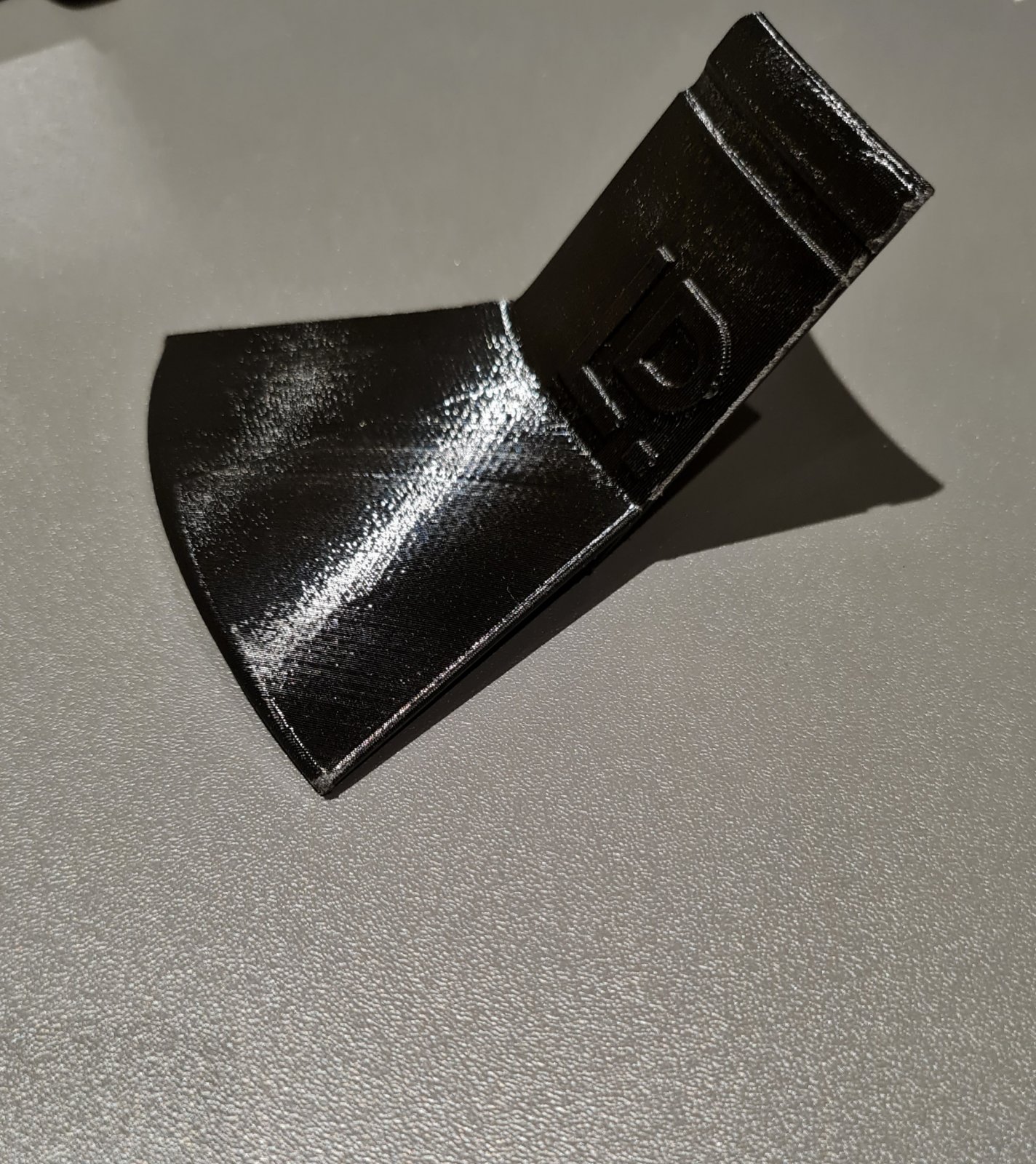

For those infested I have made some tweaks, changed the logo to my own from Trek so I don't get sued ?. And have made it from a stronger and more weather and heat resistant plastic.
I like the new design. Could also keep in-line with my Lady-Gaga theme. (Jk).

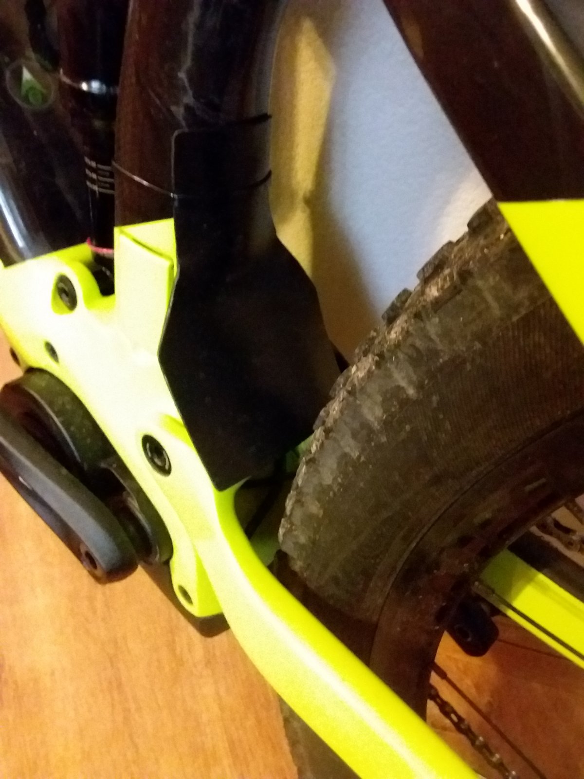

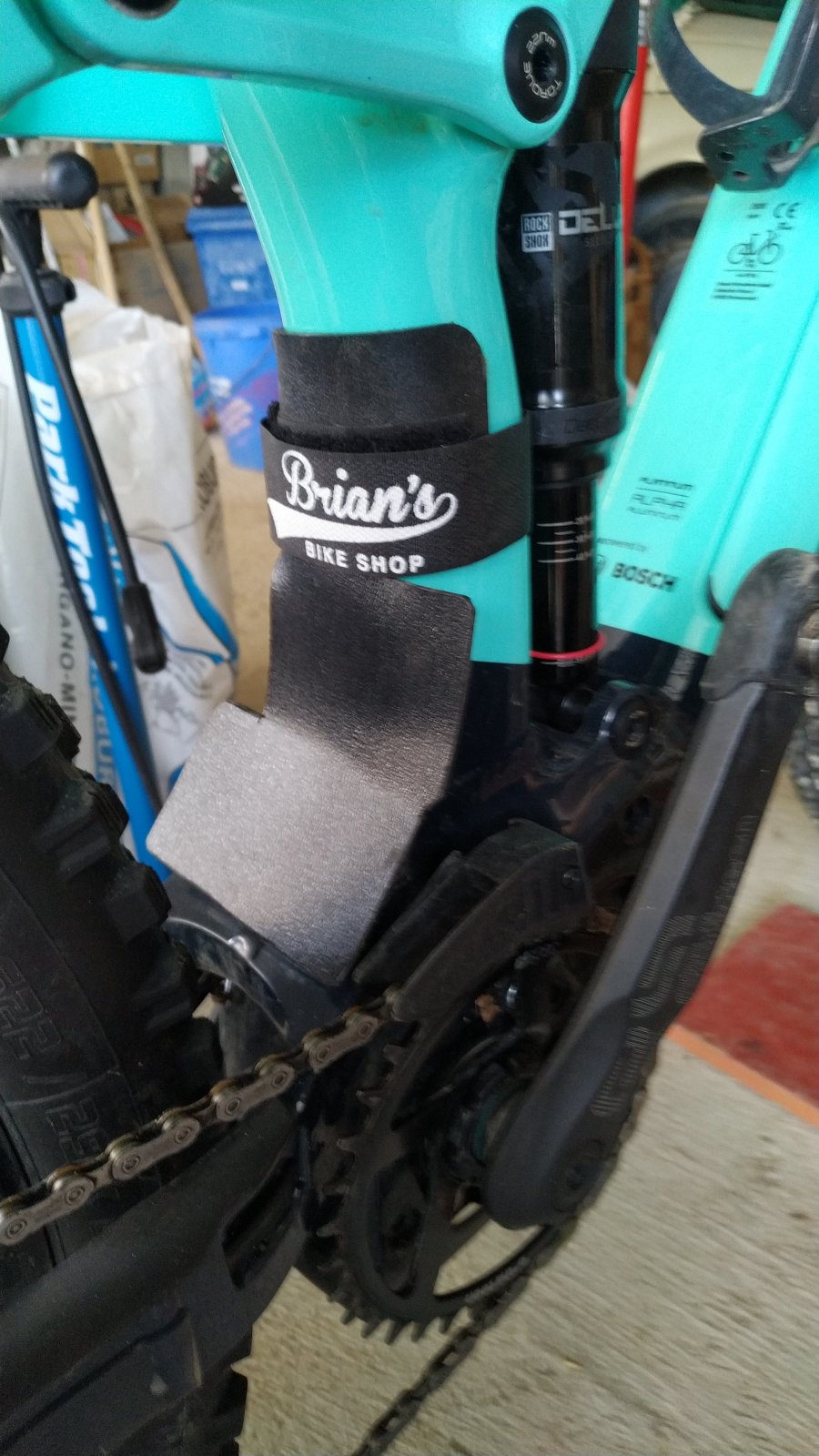

Here's my solution to the mud collection on the pivot. Not as slick as the 3D printer version, but it was easy and can be customized any way you like it. Its made from Kydex sheeting, which is easily formed with a heat gun.
Cost $10US on Amazon for two sheets, which gives you lots of extra for many uses.
Here's a photo. I have it attached with double stick tape, so the cable tie is probably redundant, but i like the security. Blocks mud perfectly.

Very nice. Never thought of that. Is that .60 or .80 thickness?

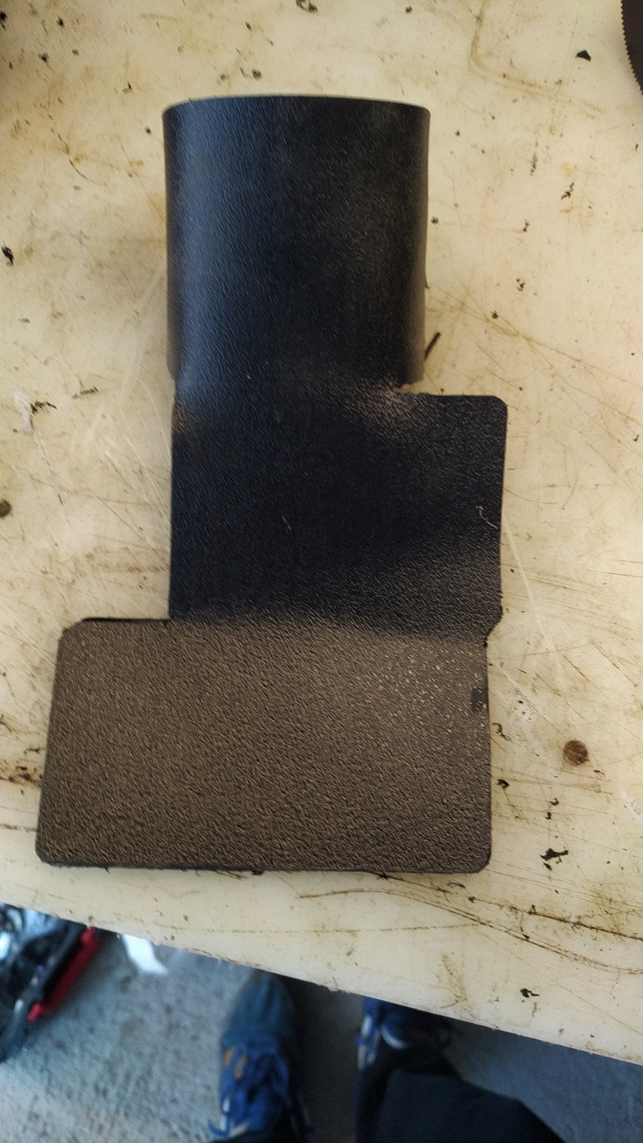

Tried the Kydex. Works very well. Ugly as sin. Held on tight with a cable tie and some tape for now.
Put the kydex in the oven for 10 minutes at 180C and then shaped it in the garage by laying it on a metal pole and leaving to cool for 10 minutes. Took 30 minutes or so from start to finish.
I might buy another 2mm thick sheet from ebay for £4 to create a better looking version that is better shaped to the frame and then attach it with double sided 3M tape but will see. I will probably keep this version on for the time being as it works.

View attachment 56268View attachment 56269
You can use a file and some sandpaper to smooth the edges and round the corners. Also , when its warm and pliable you can form it on the seat post so you get a custom fit with no edges sticking out. The stuff is cheap, so its easy to experiment with different molds and shapes. Good luck!

Decided to design my own cover for the pivot link to stop stones and mud getting stuck, quite happy with how it came out, looks more OEM than the mud guards i have tried to adapt. Should do exactly what is needed and look minimal.
What do people think ?

That is a good one! There must be some room(as in the picture) between the link and the guard, right? Otherwise it will rub the paint off?
How much (in mm) link raises when air is taken off from the shock?

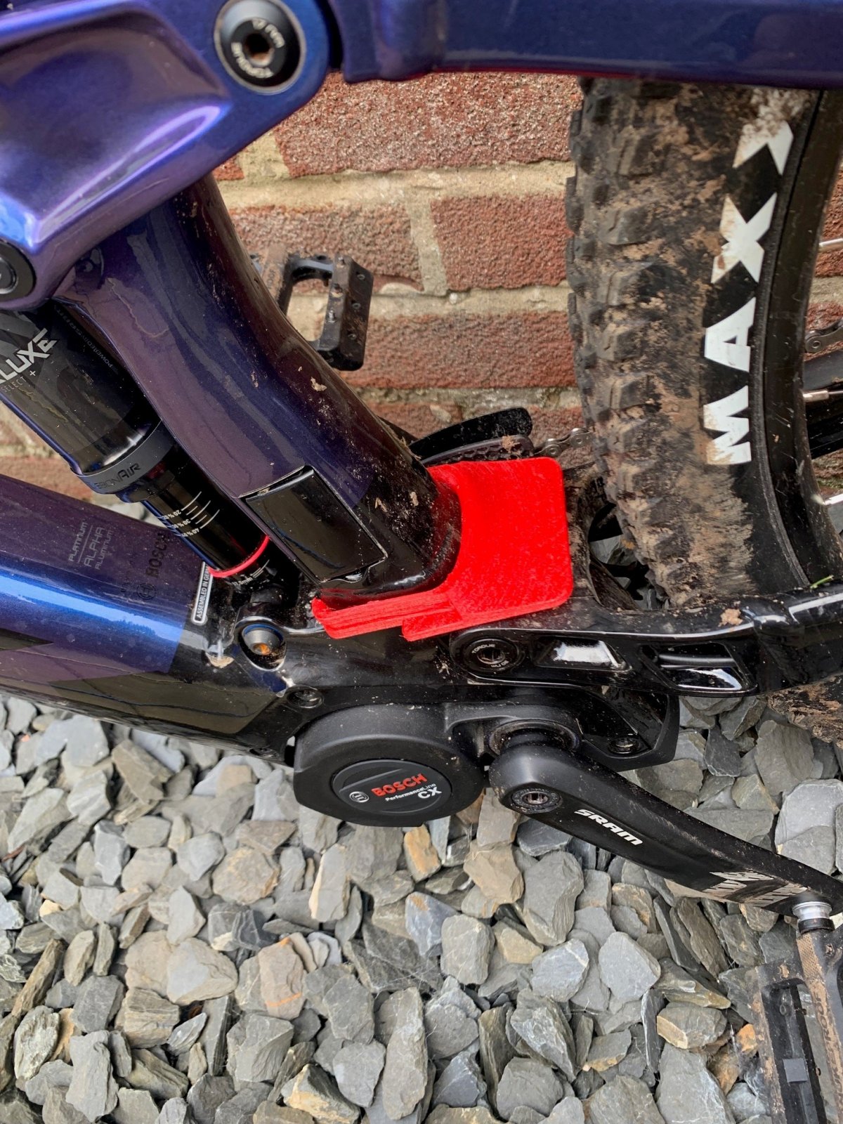

I found a file on thingyverse and printed a design out someone had done on there.
One option for you is to put it on myminifactory and charge for the download. You cant stop it being reproduced and sold after that but at least your getting something for your time!
The one i printed was for mine and a mates bike, Excuse the red its the only flexible filament i had. I will be getting some black to do one for my bike but from the rides we have done since then it seems to work mint!
