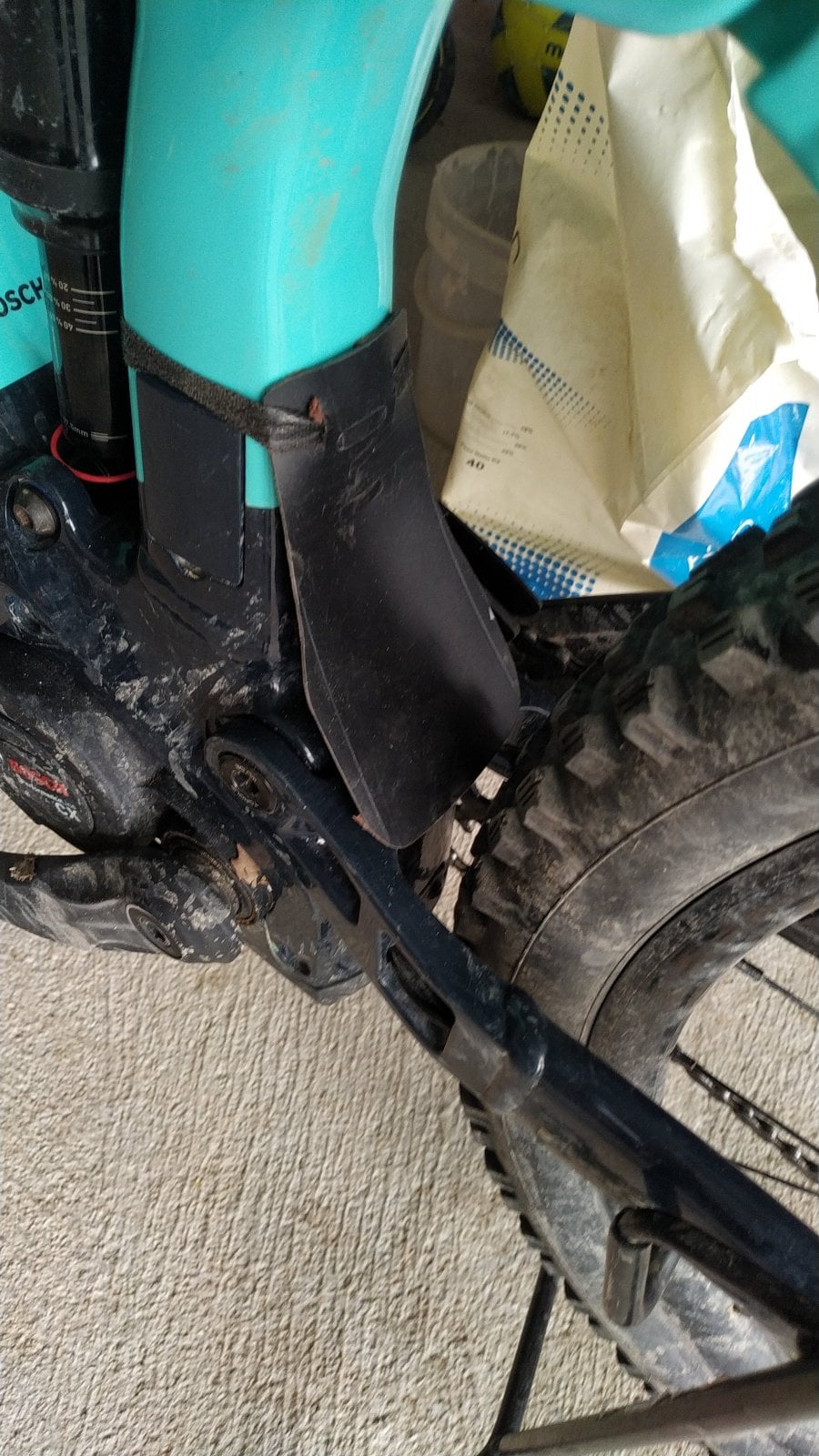

Custom pivot link protector

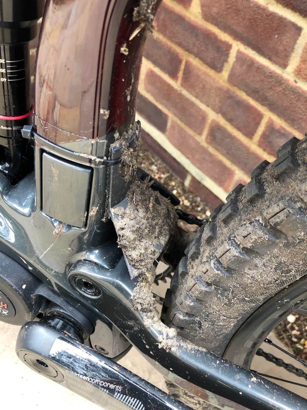

Can you or do you have any plans for designing ans making something like this for the Levo ?
Well, seemed to work really well, didn't clean it off once during a 3 hour muddy ride so a lot of the mud and water falls off of it's own accord.
Will get another ride in tomorrow but looking good so far.

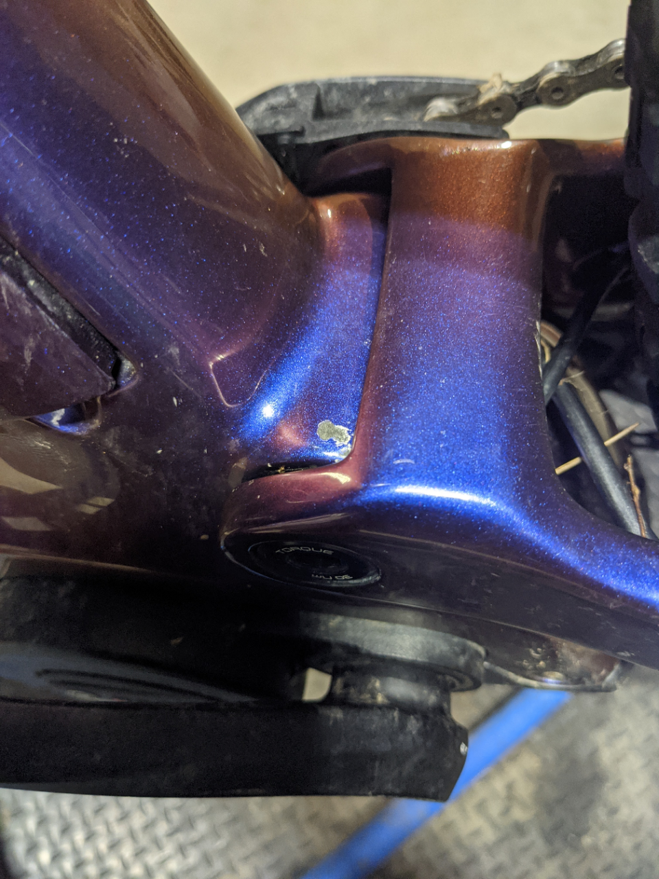

Im gonna try and foresee any potential problems with this so I’m open to criticism.

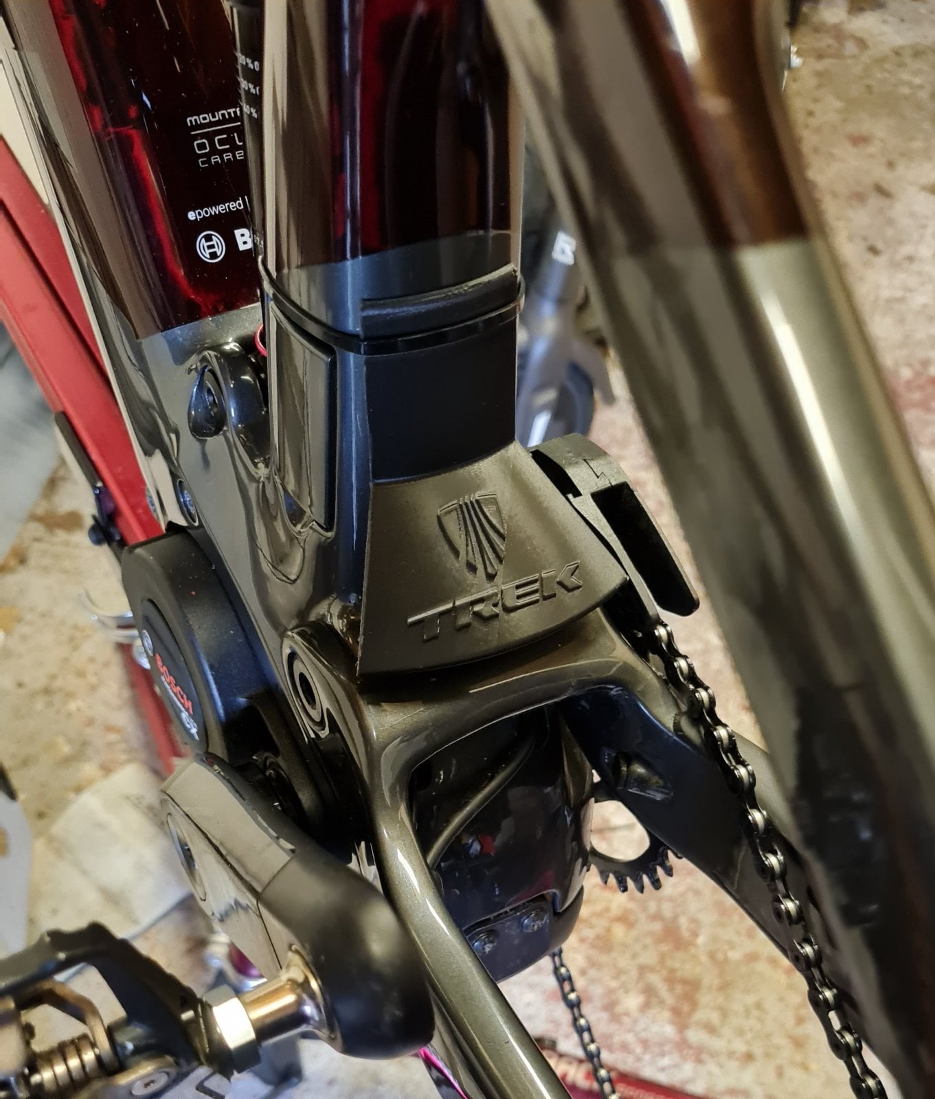

One of the main purposes of this is to deflect rocks or pebbles away from the bottom pivot. A rock or small stick finding its way into the bottom pivot can be a showstopper until it’s removed. A rock or stick can also help build up even more debris in this area. Keeping this area clean before each ride is important and fairly easy as long as nothing is wedged in there. This deflector seems to do the job.
Small granulated sand can act as sandpaper when it’s wedged between two surfaces. Some of my concern is with the placement of the zip-tie and the flat surface or the deflector against the post. I wonder if there’s a way for small debris to escape or fall off during a ride? Invisa-frame helps sometimes.
My front fender wore off some paint until I removed it for good. A zip-tie on the lower rear triangle, keeping the hydraulic line out of the spokes, wore thru the paint and slightly into the carbon. Replaced that.

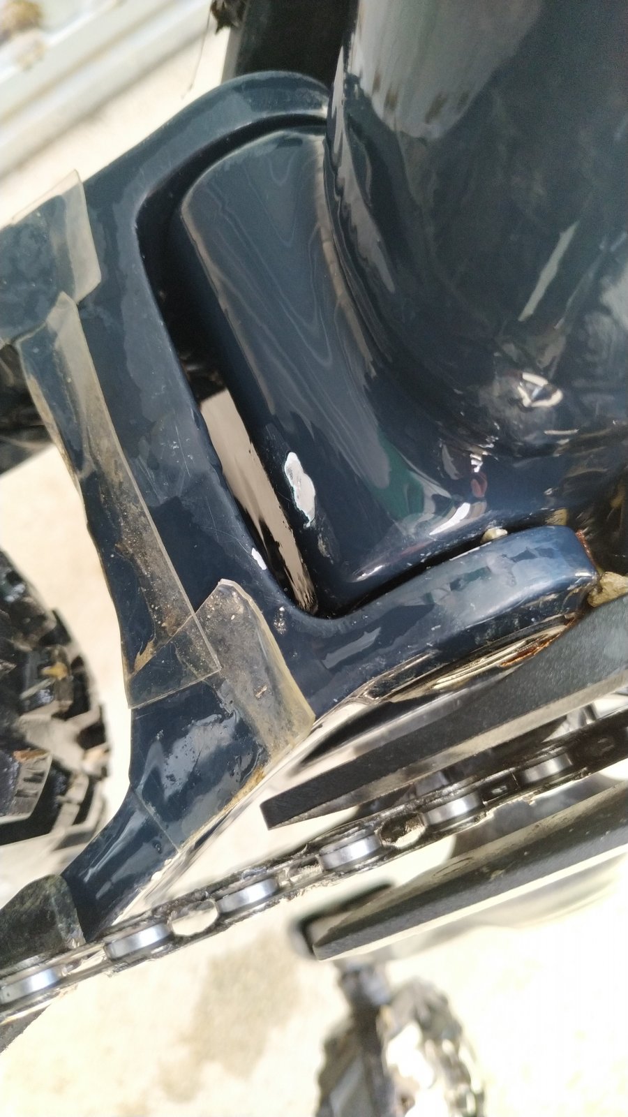

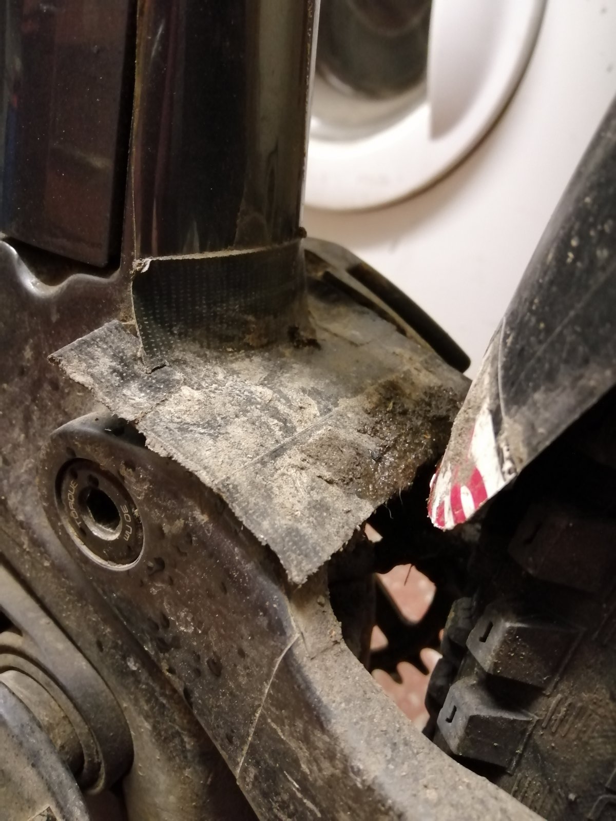

I have a piece of anti slip rubber cut to size between the bracket and the frame so it can't slip but also won't rub and nothing can get between both surfaces. I also ran a strip of frame protector tape all the way round under the cable tie. Nothing will rub the paint. That is always a concern for me. ??

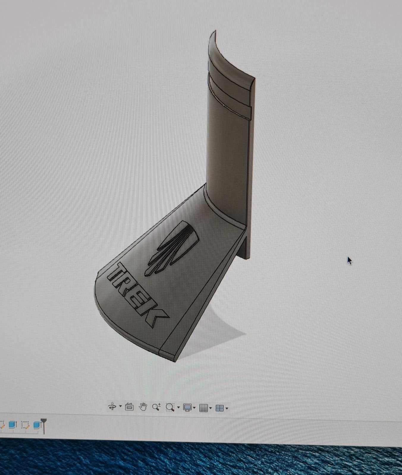

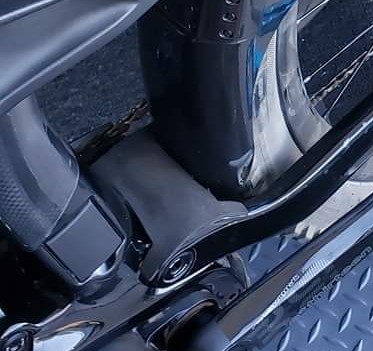

Decided to design my own cover for the pivot link to stop stones and mud getting stuck, quite happy with how it came out, looks more OEM than the mud guards i have tried to adapt. Should do exactly what is needed and look minimal.
What do people think ?

Thanks for all the positive feedback all !, I made the original post to see what people thought and it's certainly struck a chord with many.
I have sent one to Rob to check how it fits on a larger frame size (mine is medium).
I am obviously not a manufacturer so each one is made one at a time (takes about an hour to print). With this in mind i am interested to understand what people feel these are worth paying for. Not so i can maximise profit (far from it), but obviously for me there is a point where the time, expense and effort to print, package, go to the post office etc etc don't make sense and it becomes a hassle and a loss maker (i also have a day job :p )

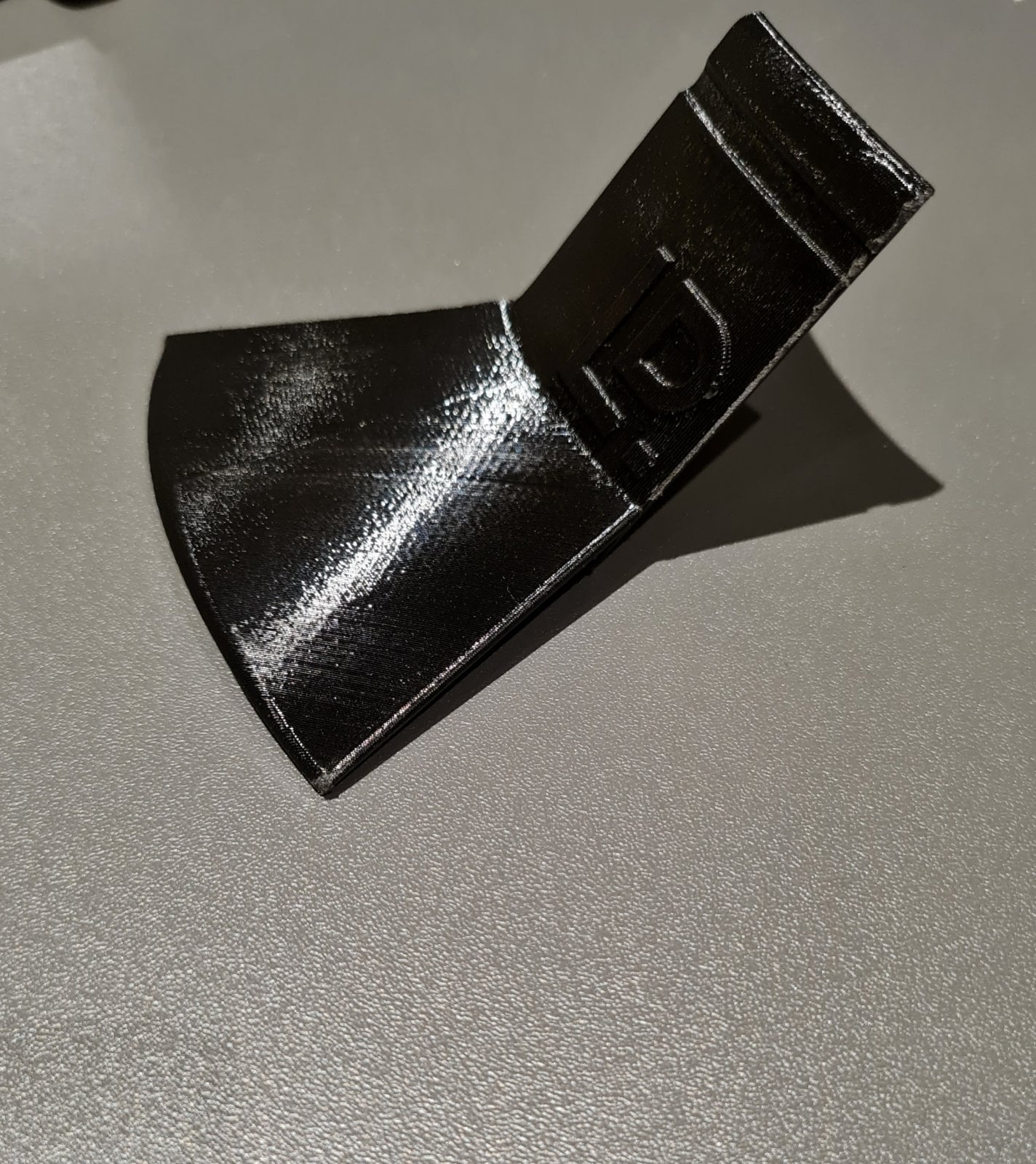

For those infested I have made some tweaks, changed the logo to my own from Trek so I don't get sued ?. And have made it from a stronger and more weather and heat resistant plastic.
