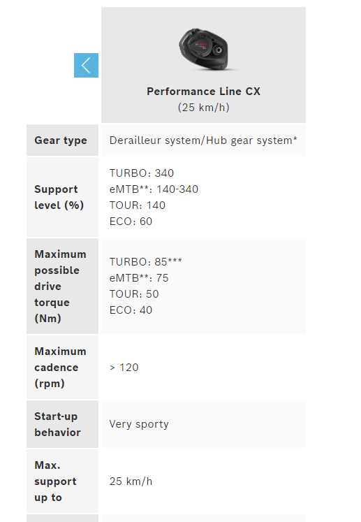

I did not know that the torque changed with the modes, just the % assistance. Do you have a link with the Nm of eco & tour ?
system/Hub gear system*
Support level (%)TURBO: 340
eMTB**: 140-340
TOUR: 140
ECO: 60
Maximum possible drive torque (Nm)TURBO: 85***
eMTB**: 75
TOUR: 50
ECO: 40
Maximum cadence (rpm)> 120
Start-up behaviorVery sporty
Max. support up to25 km/h
Backpedal functionno
Gear shift detectionyes
(dynamic)
Weight ca. 2,9 kg
csm_Bosch-eBike_systemuebersicht_thumbnail_PerformanceLineCX-MY2020-p1_b043ff1d78.png
Gear type
Support level (%)
