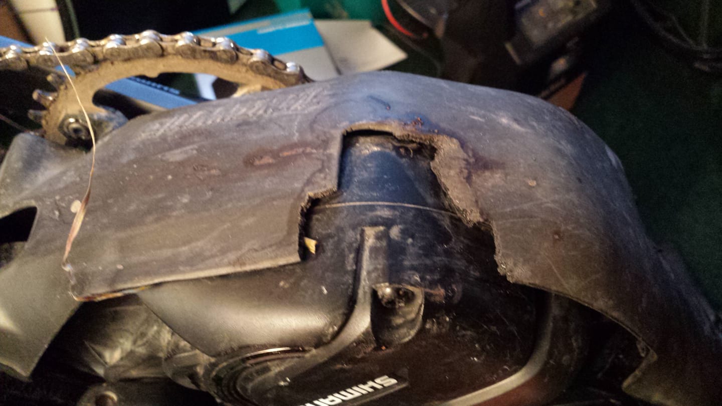

Engine guard after 3 months. Replaced with another flimsy one that was sent. Everything about the bike is A+ except for this. How are you'alls bashguards holding up.
Kernow
Jan 18, 2018
1,436
1,149
Cornwall uk
Not whacked it anything like I thought I would ,there a few small scrapes in the motor casing .
Iam often amazed that it’s not bottomed out at times ,as I expect to hear a crunch . It’s fair to say I bottom out about as often as I used to hit the chainring on my normal bike , and last time I hit the chainring not the motor .
I guess it depends where you ride , there’s one bit in the woods that’s like riding over a stony hedge , we usually just stop and push over as it catches all bikes

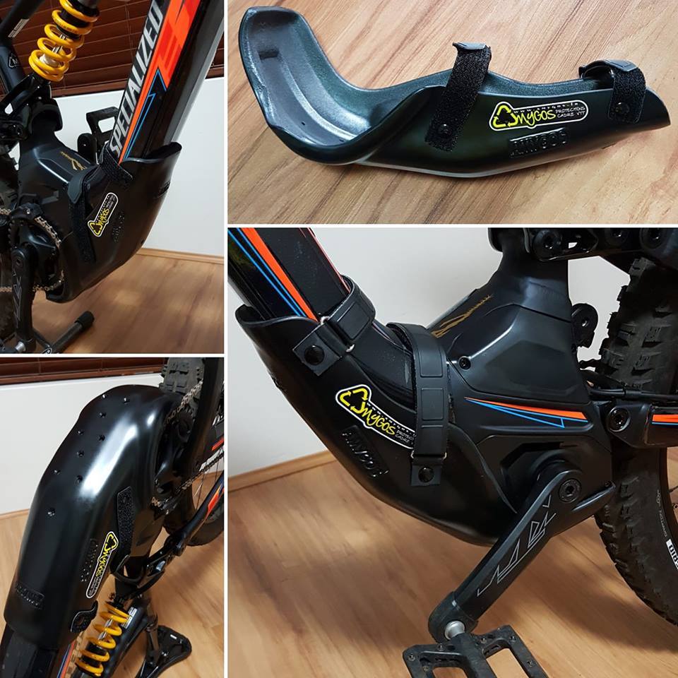

Found this solution for the Commencal's flimsy engine guard. The pic is on a Levo, but in the link they have for over 20 brands, link is the Meta Power one. Not sure where they ship to, but the pic will give you an ideal if making your own. AMYGOS - carter META POWER View attachment 4813
That looks good , but not cheap . However by the time I mess about trying to make my own I had just as well go to work for a few hours and buy that , I doubt I could make anything that good

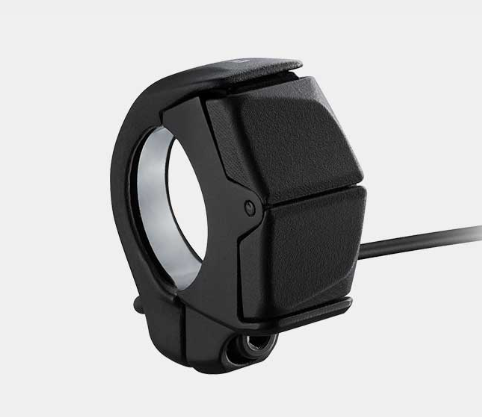

Hit 1300 miles today since mid April, the swap from 8 speed to 11 speed was a success. I'm liking the 11-46 Sunrace cassette. and can't beat the price if it ever needs replacing ($52). Next thing that I'm waiting for is the E7000 switch to become available, nice and small. I'm be able to put my dropper lever back where I like it.
Kernow
Jan 18, 2018
1,436
1,149
Cornwall uk
We’re on about the same miles , there’s no real wear in my ex1 yet but Iam keen to try 11 speed
That switch looks easier to use than the e600 switch , but no button for the computer . Still no perfect solution for me .
jsalas2
Apr 6, 2018
195
118
San antonio, Tx
Is the button for the computer to get to the menu on the display? That would be more convenient, than having to hold down the button on the bottom of the display for a few seconds to get to the menu.
