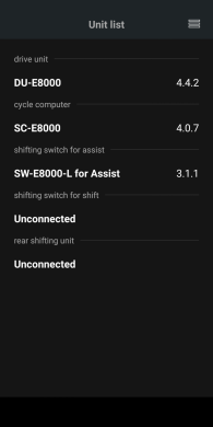

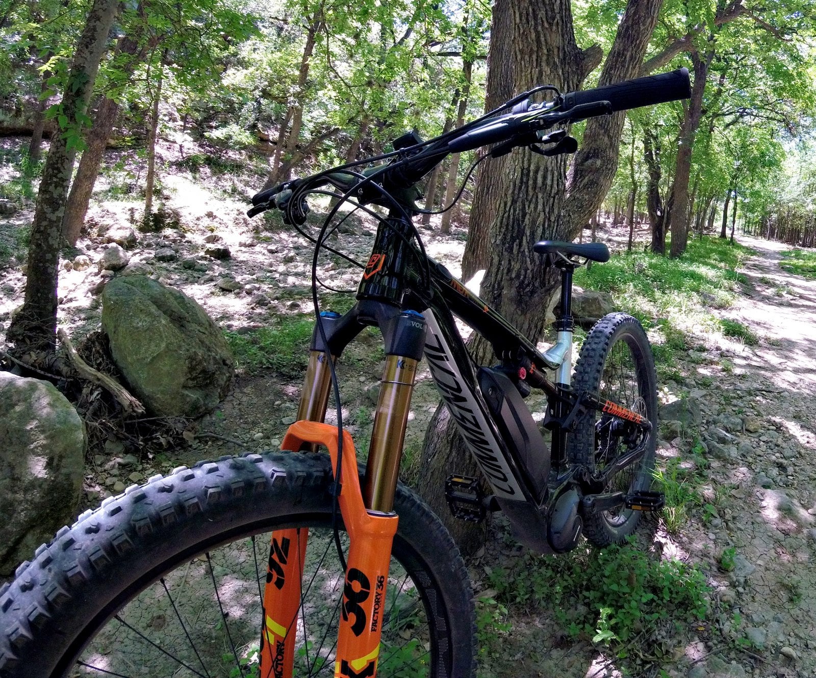

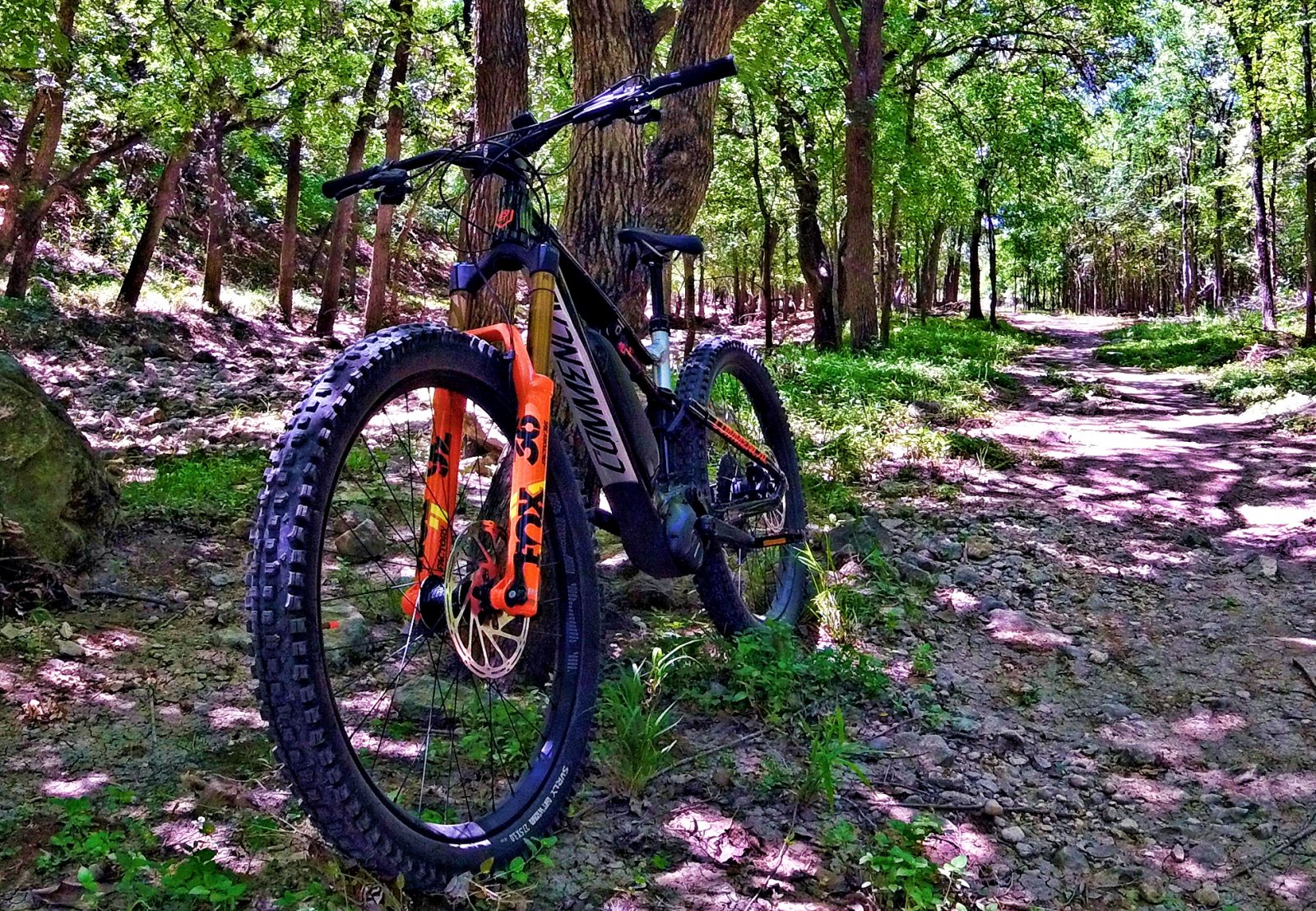

First ride dialed in. The 3.0 Dirt Wizards really woke it up and I did the firmware update that made the trail mode like the Bosch EMTB mode which I have on my Haibike and really like it. I was able to leave in trail mode the whole ride. The bike is amazing.
Has Shimano released new firmware for the E8000 that alters the assist levels? As far as I can tell only 3 FW versions exists. 4.0.7 from dec/17 is the latest, description says "bug fix". Or are you talking about tuning the motor, which can be done with the eTube app?
I'm in the US and recently updated the firmware. Full assist up to 18mph then partial assist all the way up to 20mph. Before, it seemed to have no assist above 18mph.
I have the bosch also and rode it before and after the emtb mode update. I rode the meta for a day before and missed having the emtb mode. The next day I updated the firmware and as it was updating was giving the description of what it was doing. And the description was similar to the emtb description, which is this - Depending on the pedal pressure, the progressive motor support automatically adapts to the individual riding style. Without changing gear, the motor always provides support at the ideal power level, even at low cadences. Not word for word, but similar. I wasn't sure until I rode it the next day and it was almost just like the emtb mode of the bosch and definitely different than the day before. Does not change the 20mph limit. It just allows for less shifting between modes. just my opinion of what I experienced.
Has anyone else tried the PearTune de-restricter for E8000? I find it works well on shimano - only drawback is that the speed displayed is 50% - so it show 10mph when you are doing 20 But who really looks at their speedo when hurling down though a forest? I also used PearTune on my Bosch and that was superb Both Available on e-bay.
Shimano doesn't report this upgrade. I was wrong in my previous post, there are 10 FW updates for the motor. Update 4.1.0 from july/17 could be relevant, description:
Adopting for USA specifications

I rode E8000 for the first time in sept/17 and I'm pretty sure that bike had at least 4.1.0, a bit surprising that you can buy an E8000 bike today with over a year old FW. I've ridden 5 different E8000 bikes since, and they were all at least 4.1.0, maybe the dealers updated them.

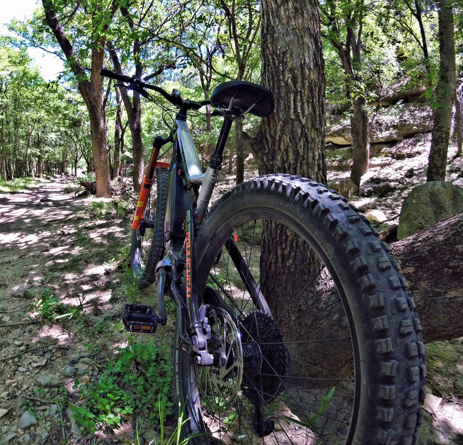

What tyres did yours come with , they look different to the uk bikes in that pic , I presume you’ve changed them
The bike came with 2.5 Maxxis hi roller in front and Agressor in back. Good knobby tires, I just prefer plus tires, I put 27.5x3.0 Surly Dirt Wizards, Mad traction now.

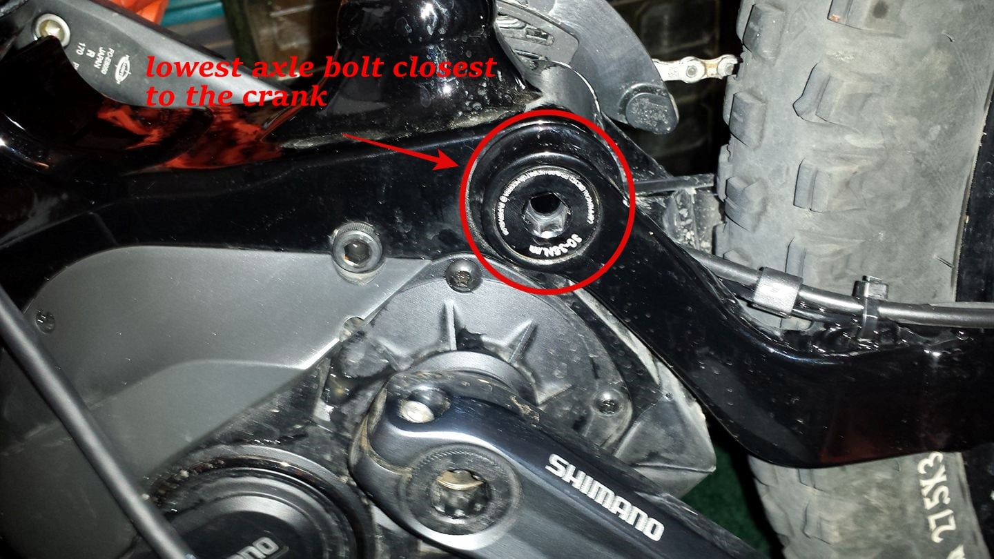

Just a heads up, check you axle pivot bolt. Mine came unbolted today, it was a third of the way out, before I noticed my rear end wobbling. Luckily the nut on the other side didn't fall off, the chain guide kept it from falling out. Glad I was on regular trail and not coming down a dh section, would've of probably ended badly. Be safe.

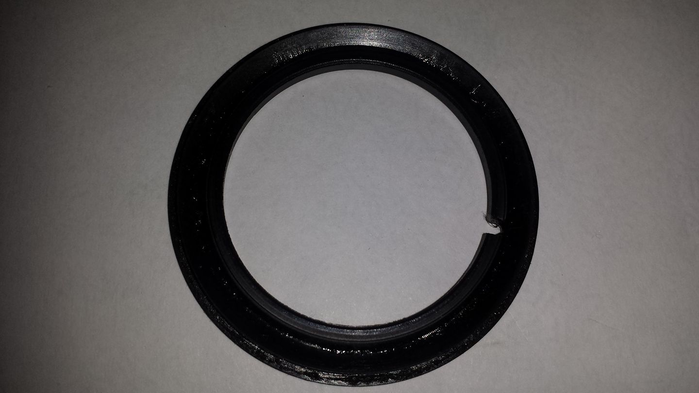

Ok, got it sorted out. This is only for you with the E-Thirteen wheelset. This seal was the cause of all the problems. It's the seal after you pull off the cassette and hub body. It is too thick or wide and was causing drag on the cassette, which was pulling the front freewheel with the chainring causing it not to engage. As soon as he took it out and put it back together it was all working fine. Anyway, solution mechanic said, in this instance just take it out. He had seen this before on other wheels also. This is a well respected and knowledgeable mechanic. Was worried about dirt, He said shouldn't be a problem, showed me how to clean it and to check once a month. Just took 5 min. I can do that. Luckily all we have here is dust, no mud or rain for months. So it was a good day, just cost me $16 and got a free lesson on freehub maintenance. If your not having problems yet, I wouldn't worry, I probably just got one out of spec.

If that type of seal is fitted upside down it will drag only a little at first until it gets dry it’s easily done and often when you look at it when re fitting it appears the right way is the wrong way round
Although from new it should be right
