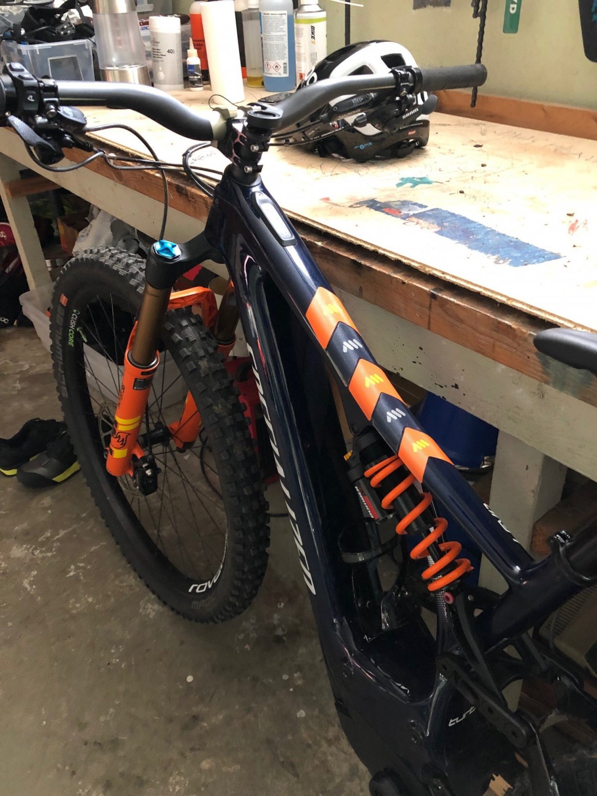

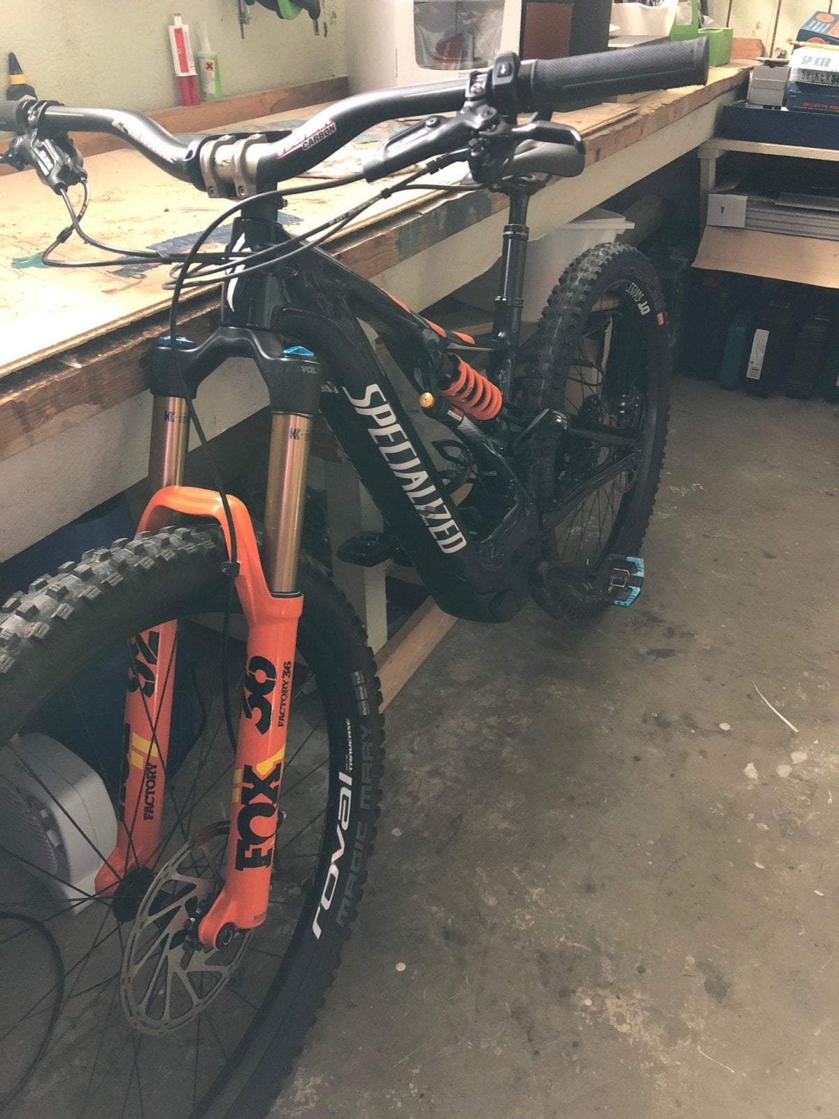

I'v been riding with the 550 spring for a while now, mullet setup with DT swiss H1700 wheel out bak MM tires 2,6 front and back. Also switched to Fox Factory Grip2 160mm. These modifications really made the bike an even better descender than original. The Coil is plush as hell and no bottom outs till now. Think i do not need the new Kenevo.... Time will show ;)

Hi, I'm happy with the shock, however you can really feel how linear the rear suspension is with the coil option. would be very interresting to hear from you if you go for the progressive springrate.
What spring rate did you get and what do you weigh? i ended up getting 640lb spring and are 92kg, bang on 30% sag with 2mm preload
also, does your ohlins have a bearing in the top? mine doesn't. It has a DLC coated pin in a bore that i can't get to spin
I’m 101kg and same spring, seems perfect and my god totally transform the bike from very good to god dam amazing. I’ll check and get back to you

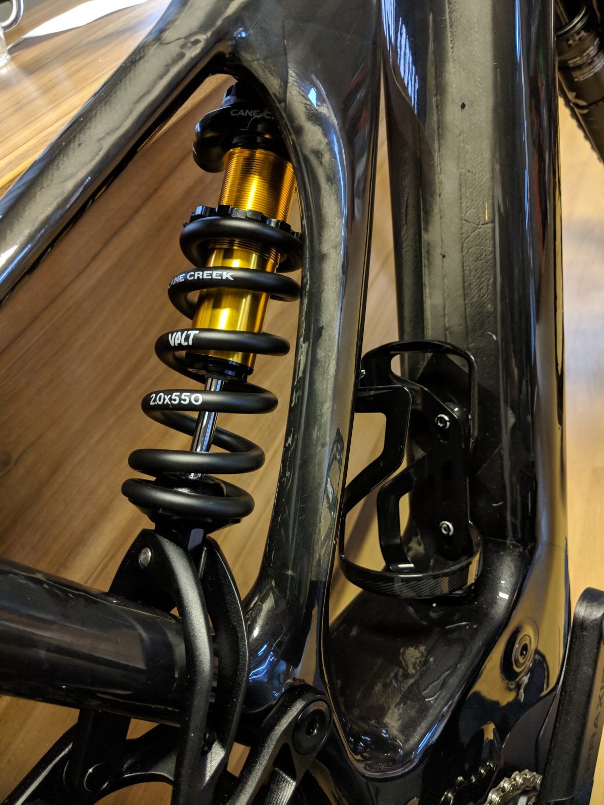

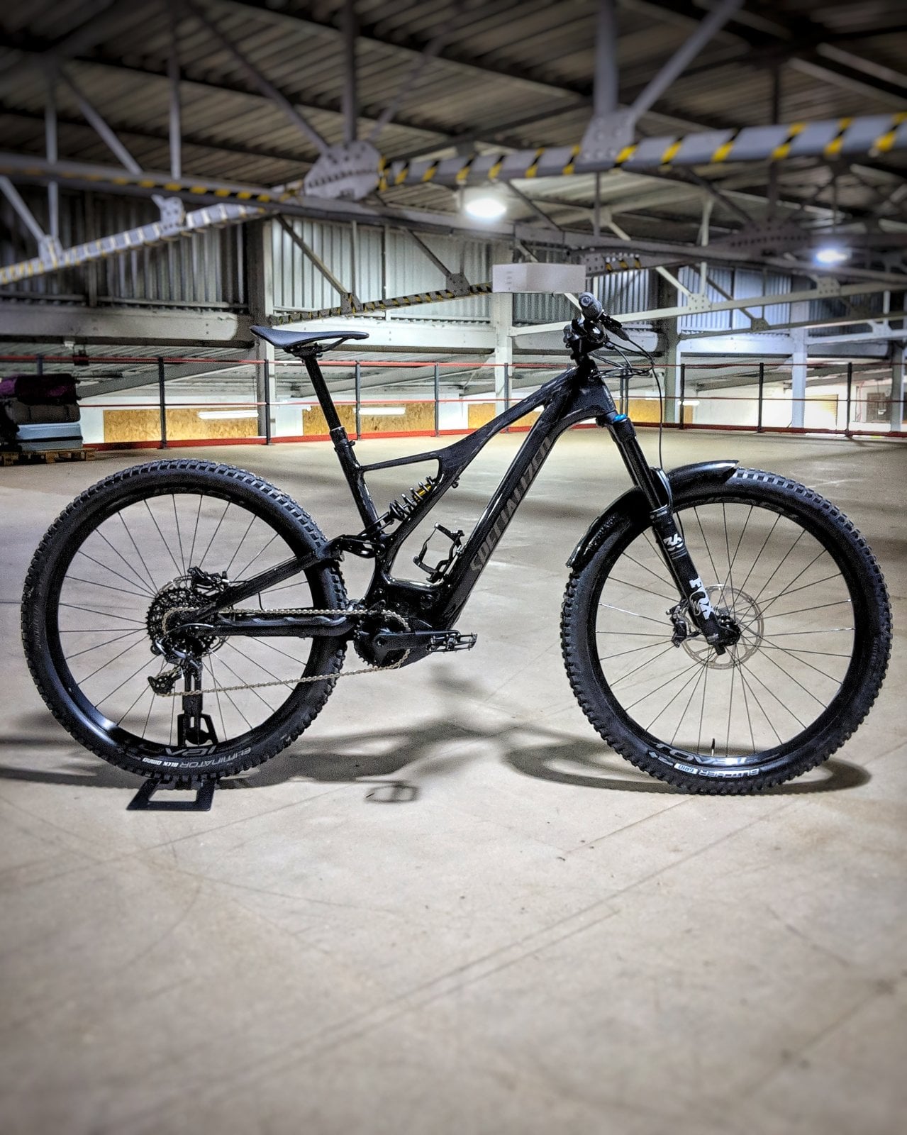

Hi everyone,
Just wanted to add to the discussion - today was my first ride on my 2019 Levo with a coil shock. It has been a very long time since I had a coil shock, (and back then it was a DH bike) but I was blown away by the way it has transformed the bike. The rear suspension now works so well that it has made the forks feel a bit rubbish! Also, the bike seems way more playful and it definitely has a noticeable amount more grip. I was also surprised how much more comfortable the bike is when climbing- again the rear suspension is able to take out trail chatter so well.
I was unsure which shock to go for, but ultimately I decided that I really want to be able to use my bottle cage so a piggyback shock was out. I went with a 210 x 55 Cane creek dB in-line coil because I can run a bottle, they’re well reviewed, well priced and because I’ve had good experiences with their air shocks in the past. I like that the tech in then is designed by Ohlins too.
The extra 7mm of travel this shock gives the bike is nice too, especially as there are no downsides in terms of clearance etc.
Big shout out to Recoil suspension in Leicestershire for sorting it all out for me. Currently running a 550 spring which is too soft, but I’ve got a few stiffer ones to try next week.
To anyone who is thinking of getting a coil, I HIGHLY recommend doing it and the CC dB in-line coil is a great choice- especially now CC offer a version specifically for the Levo so the valving and set up is spot on out of the box (and the shock won’t break) - make sure you get the correct shock if you do this (they have a sticker on the shock to identify them)

Hey! How much you weight? And how much sag did you get with de 550 spring? Thanks
I’m about 95kgs and get about 40%sag with the 550 - going to try a 650, 674 and 708 spring next week (worth noting that CC springs only go up to 550 - the heavier springs are all Ohlins). I’m actually really surprised how well the bike still rode with such a soft spring for my weight - guess it is a testament to the damping.

Just a quick update - I’ve ended up with a 650lb Cane Creek VAULT lightweight steel spring and it is perfect for me at about 95kgs. It is still super plush without wallowing but there is no noticeable harsh bottoming out even over fairly big drops to flat. Just to reiterate I’m running the 55mm stroke shock with zero clearance issues too.
Can’t recommend the 210 x 55 Cane Creek DB in-line coil for the 2019 Levo enough. It does everything I wanted it to do and I can still run a water bottle. Just make sure if you buy one it is the updated version specifically for Specialized StumpJumpers / Levos.

Hi mate,
Sure! Speak to Dom at https://www.recoilsuspension.co.uk/ - He was super helpful at sourcing the shock, fitting it and cocking around trying different spring weights, all for a very competitive price (he's also one of only a few Cane Creek certified service centres so he knows his stuff), but no reason you couldn't do it all via the post. He replies very quickly if you message him via their facebook page.
He also sorted all the mounting hardware and made the whole process super easy. He also supplied a Vorsprung "Smashpot" coil conversion for me... also highly recommended but that's another story!
Hope this helps!
James

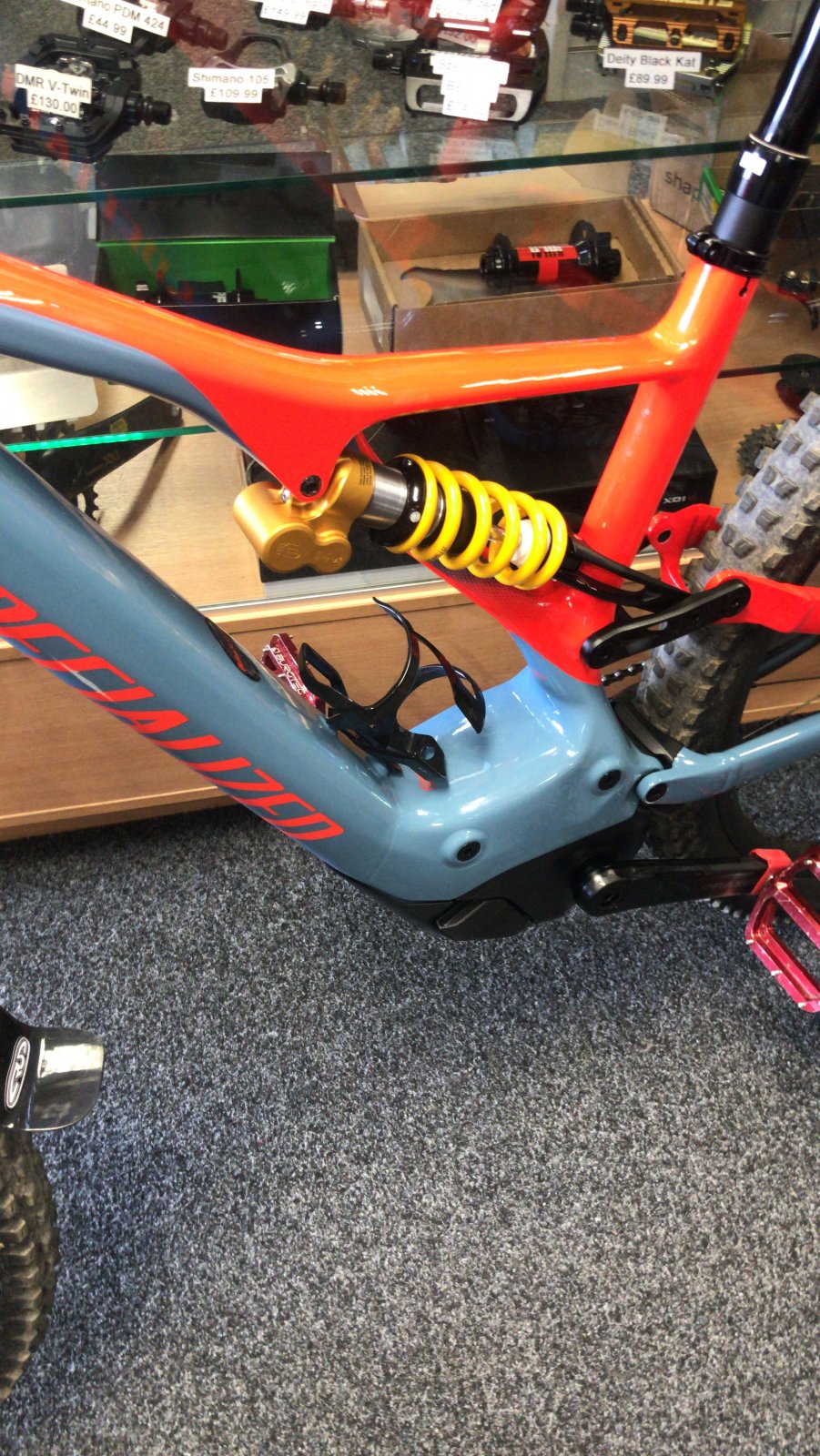

I could have an Ohlins TTX 22M 210 x 55 for sale in the next week or two as I am about to try a custom made Frankenshock from my very good friends at TF tuned
Hi Kiwi, can I have first dibs on it? just sold my Ohlins coil Enduro 29 to move to a Levo and desperately want to go back to a TTX22. How much would you want for it?
PM me and we can discuss further. Not in a hurry to sell it yet as I need to try the Frankenshock out for a couple of weeks first.
