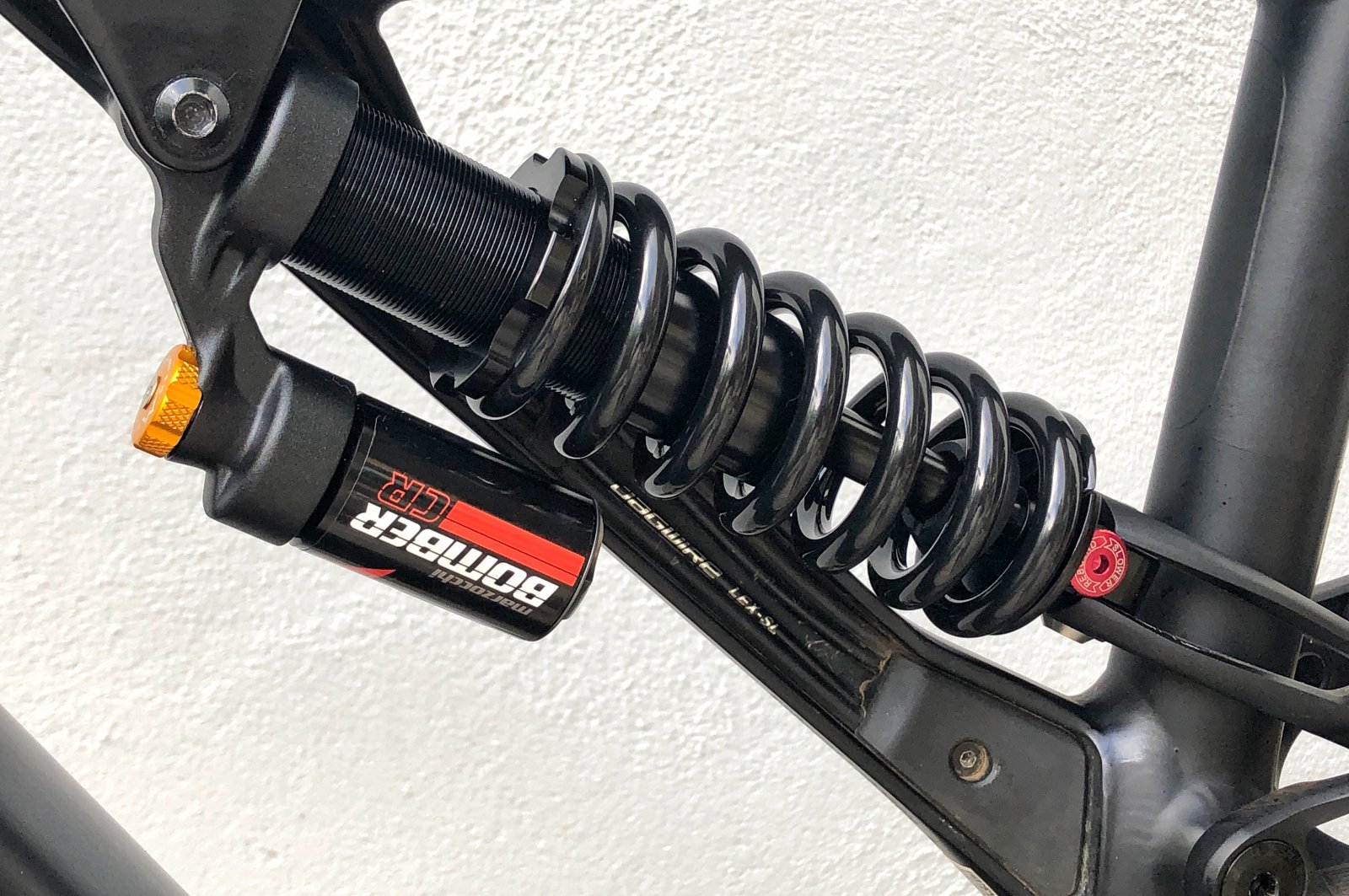

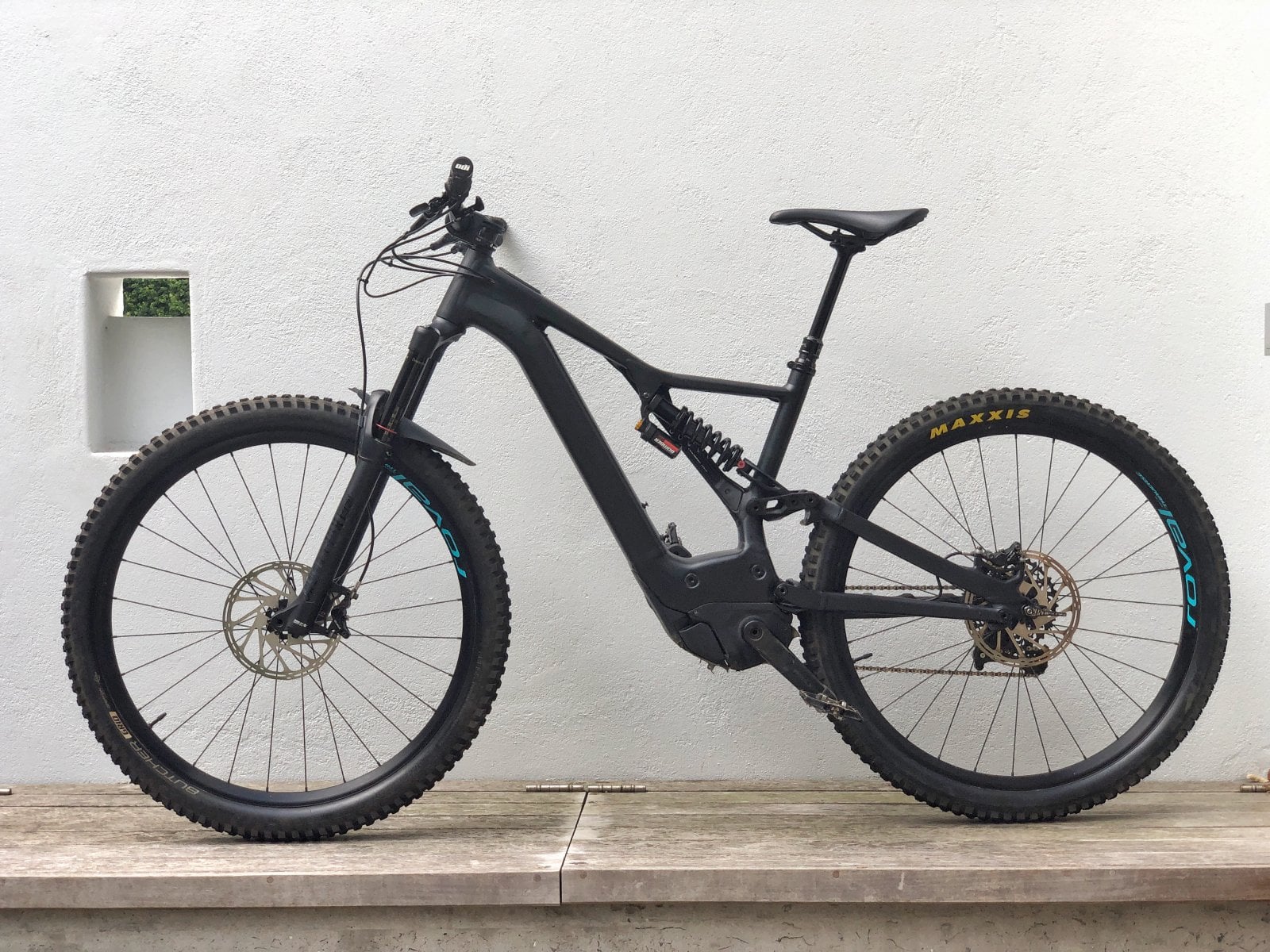

Well I rode the bike at FoD yesterday and I can say the bottoming out issue using an air shock has been resolved. Over jumps the bike is a lot more supple and of course, doesn’t bottom out. I will be taking the bike to windmill bike park soon as that’s my local spot really and that will be the test of its suitability.

I am also planning on using this Marzocchi shock - rebuilt and custom revalve by Avalanche suspension (US). Did you have any issues with the 55mm stroke - did you set the flip chip to high? I was planning to use a spacer to shorten stroke to 52.5mm but extra travel would be good! Thanks.
55mm works perfectly. More travel more fun! Flip chip set on low.
The only issue is if you want to set the rebound to “extremely” slow - the rebound adjuster knob if screwed all the way in (the red knob at the bottom next to the yolk) sits very close to the gap between the yolk.
It will make contact the yolk if you need to dial it right down. Two clicks from the bottom is not a problem.
If you wanted to run your rebound that low you would need to change the flip chip to high.
But then your rebound would be so slow you would finish your ride before the shock returned to normal.
It’s a non-issue but thought I would mention it.

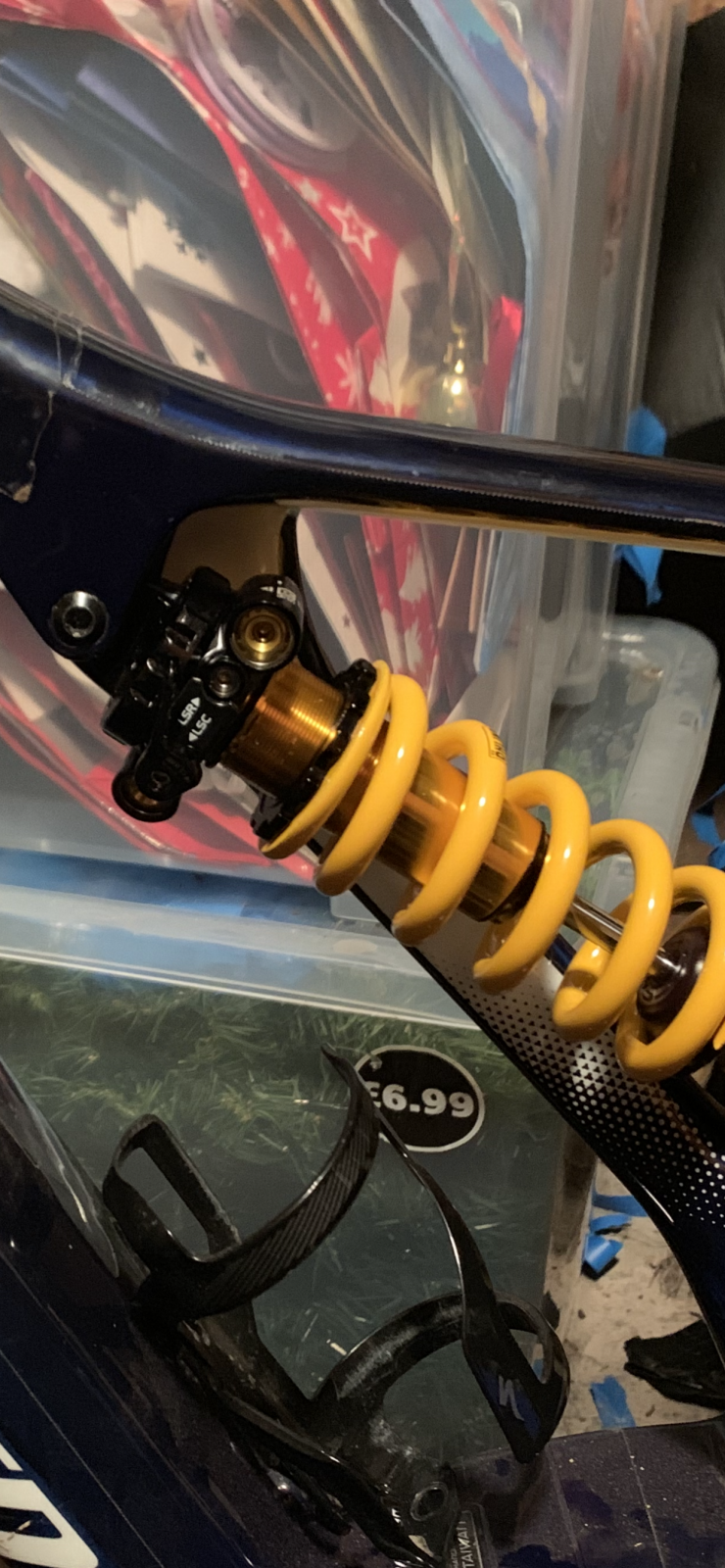

who of you is driving the one Öhlins TTX in the 2019 Levo with which spring hardness and riderweight?
At 88kg I drive a 548 Öhlins spring

I actually got TFTuned to send me a Ohlins TTX22M, they recommended that for my weight - 700lbs coils are readily available. #inbeforebrexit

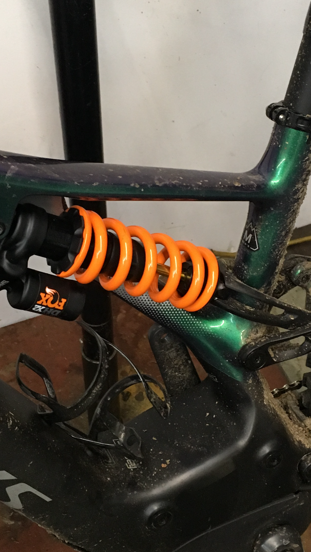

Is anyone running a Fox DHX2 in 55mm? I see that the Marzocchi CR fits with a 55mm stroke. Does anyone have direct experience confirming that the DHX2 does?

The stuntjumper uses the Fox DHX2 in 210 x 52.5 size but i cant find that size listed anywhere. Anyone got any experience with this or see any issue? Im getting the urge to upgrade my Fox DPS.
Potentially although that seems expensive and it says 27.5? Could it not be used with 29?
I inquired once. Yes it is expensive, and yes it is the correct shock.

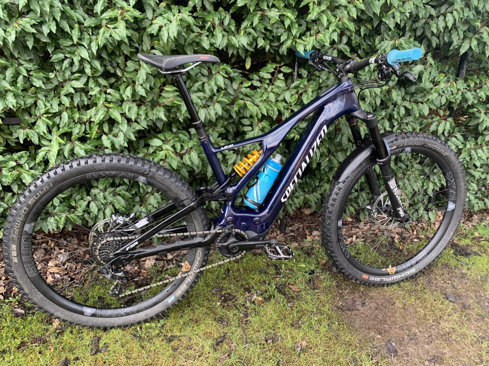

In the end I got an Ohlins TTX22M.
How does the ride compare to the standard air shock? The ohlins is also pricey, is it worth the cost?
I'm not sure how to answer that. I'm 100 kg and had the 'comp' version with the RS deluxe shock. I had to ride it maxed out on pressure to get anywhere near the correct sag. I found it a lifeless dull turd.
The Ohlins (700lbs spring) a nice and plush where it matters without bottoming out. I love it. I get much more comfort on gravel roads with lots of debris, (small bumps are gone) much, much more downhill confidence somehow and well, subjectively the bike is much more fun to ride.
Is it worth it? I find it somehow crazy the first thing needed to bring a EUR 5900 bike to life is spend another EUR 700 on a shock. My significant other doesn't think it's worth it, I can tell you that.

To clarify. Marzocchi fits perfectly. No need to change anything. It’s been a great shock.
210x55 works perfectly. No need to change flip chip.
You get extra travel (156/7mm travel) without any frame issues whatsoever.
Any 210x55mm shock will work.
The 55mm is the amount the shock travels. And there is plenty of space for the extra travel within the frame.
With 160mm fork and almost 160mm rear coil travel the Levo is now a perfect trail/enduro bike.
Wouldn’t be surprised if Specialized markets the next Levo as a 160mm travel bike just by adding longer travel fork/shock with little or no frame change.
