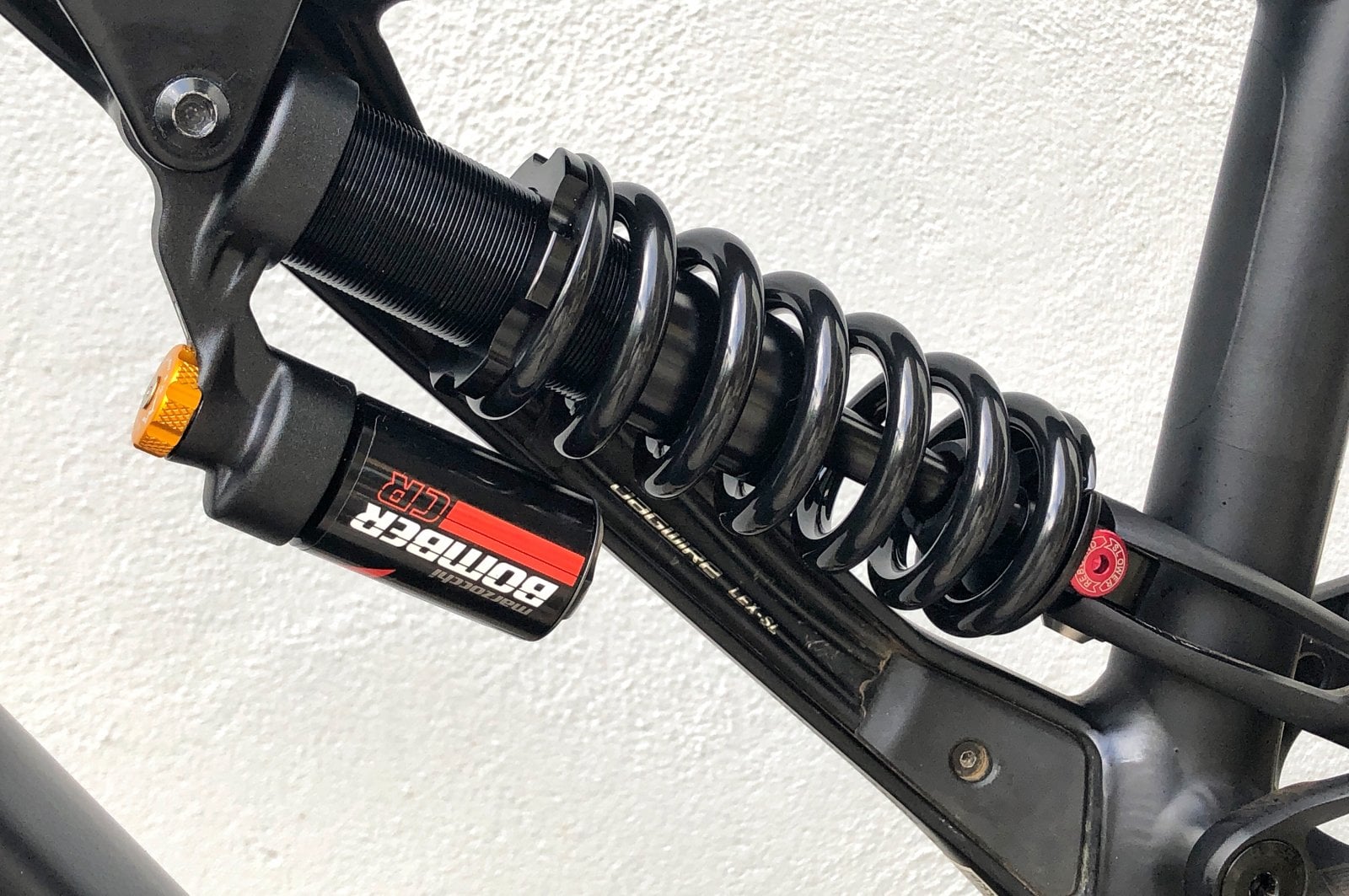

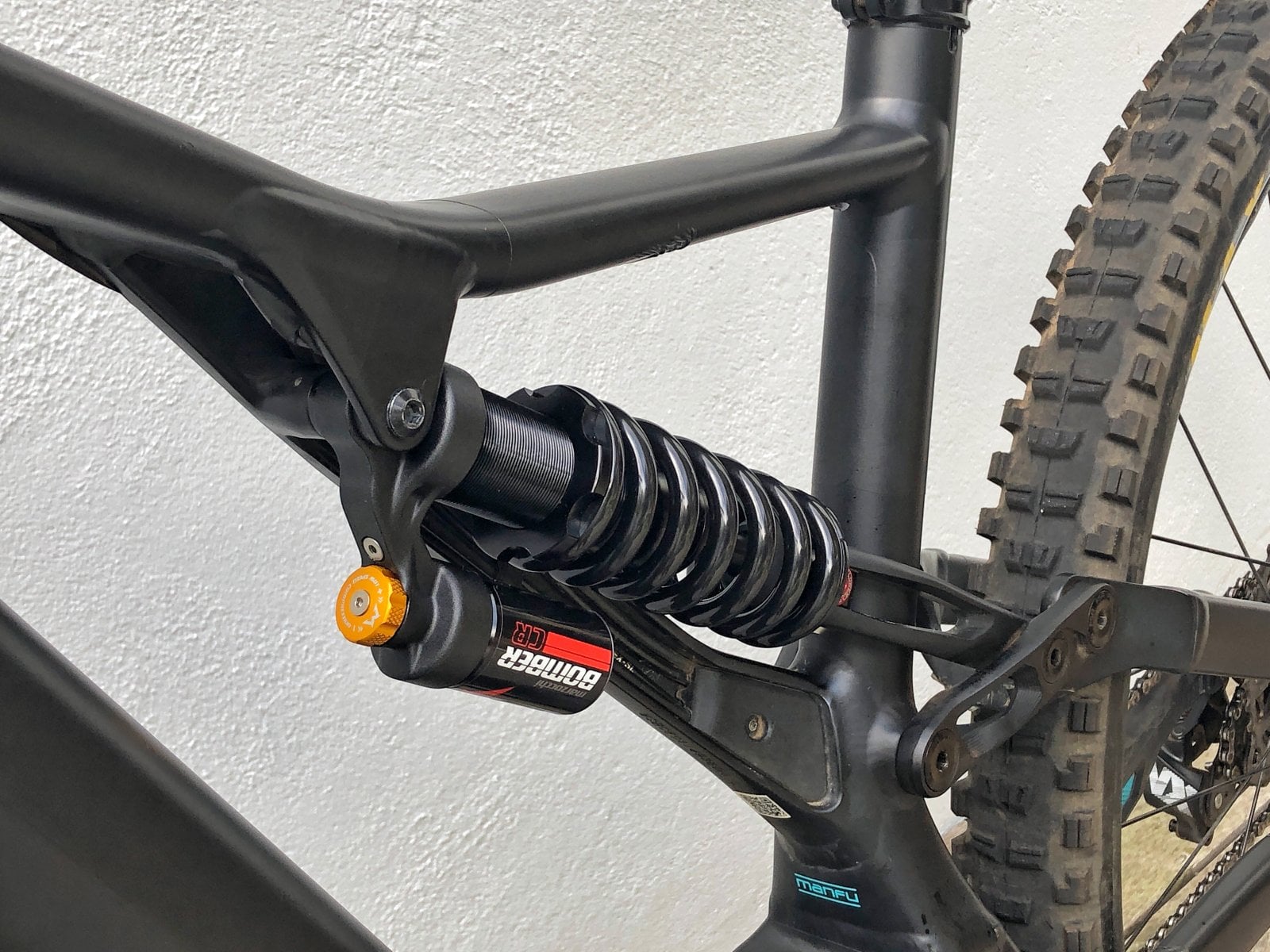

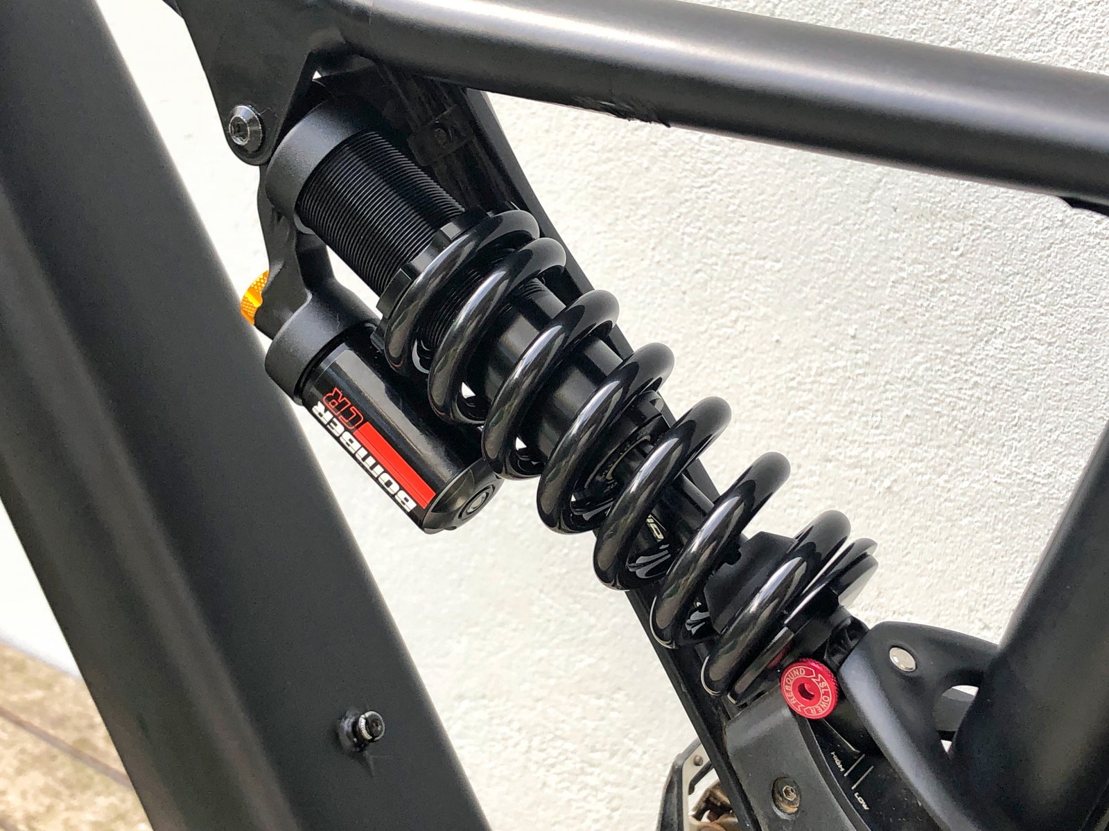

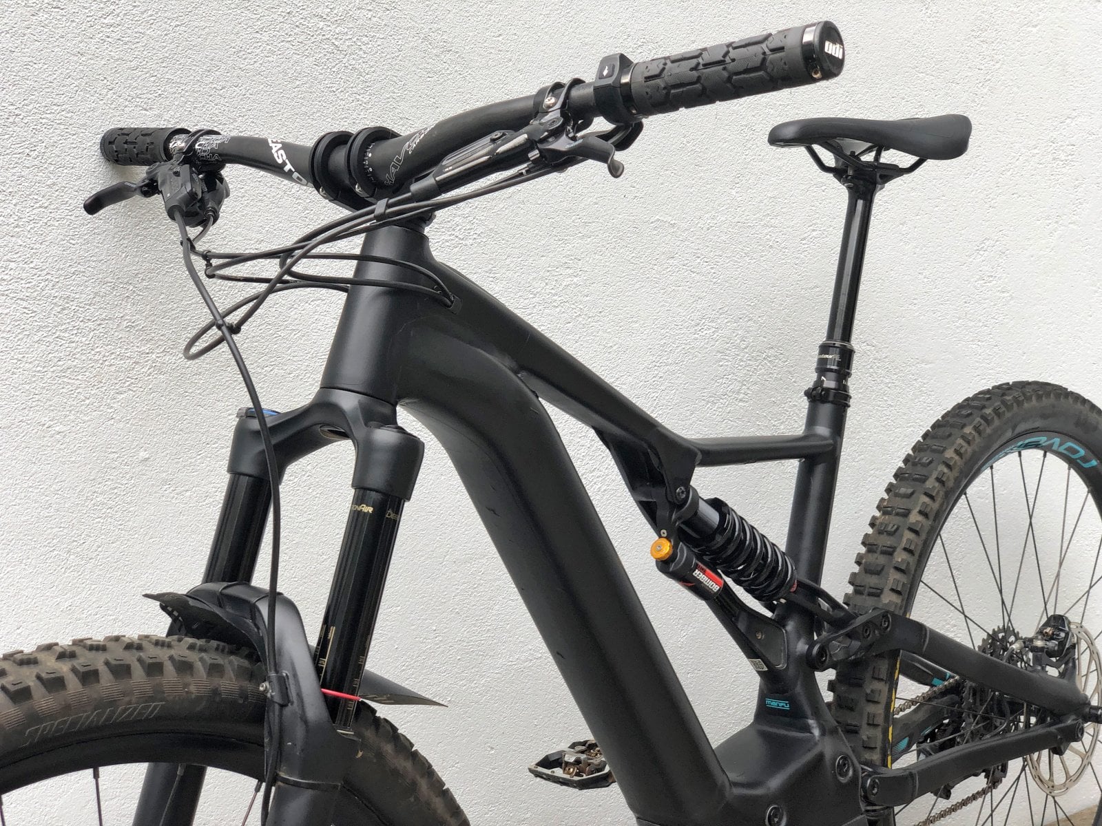

Marzocchi Bomber CR 210x55 with 550lb spring. Only needed a basic mount kit to replace bushings. Took about 30 minutes.
Makes it roughly a 156mm rear travel bike. Have a 160mm Yari on the front.
Just fitted the rear shock - riding tomorrow. View attachment 11622View attachment 11623View attachment 11624View attachment 11625

Got this from fox Factory support for the Marzocchi:
FOX-Stahlfeder 122mm TLG 35mm ID: 600 x 2.350"
tried three others before to find the right one.
Got 180lbs trail ready and with the 600 it works superb...

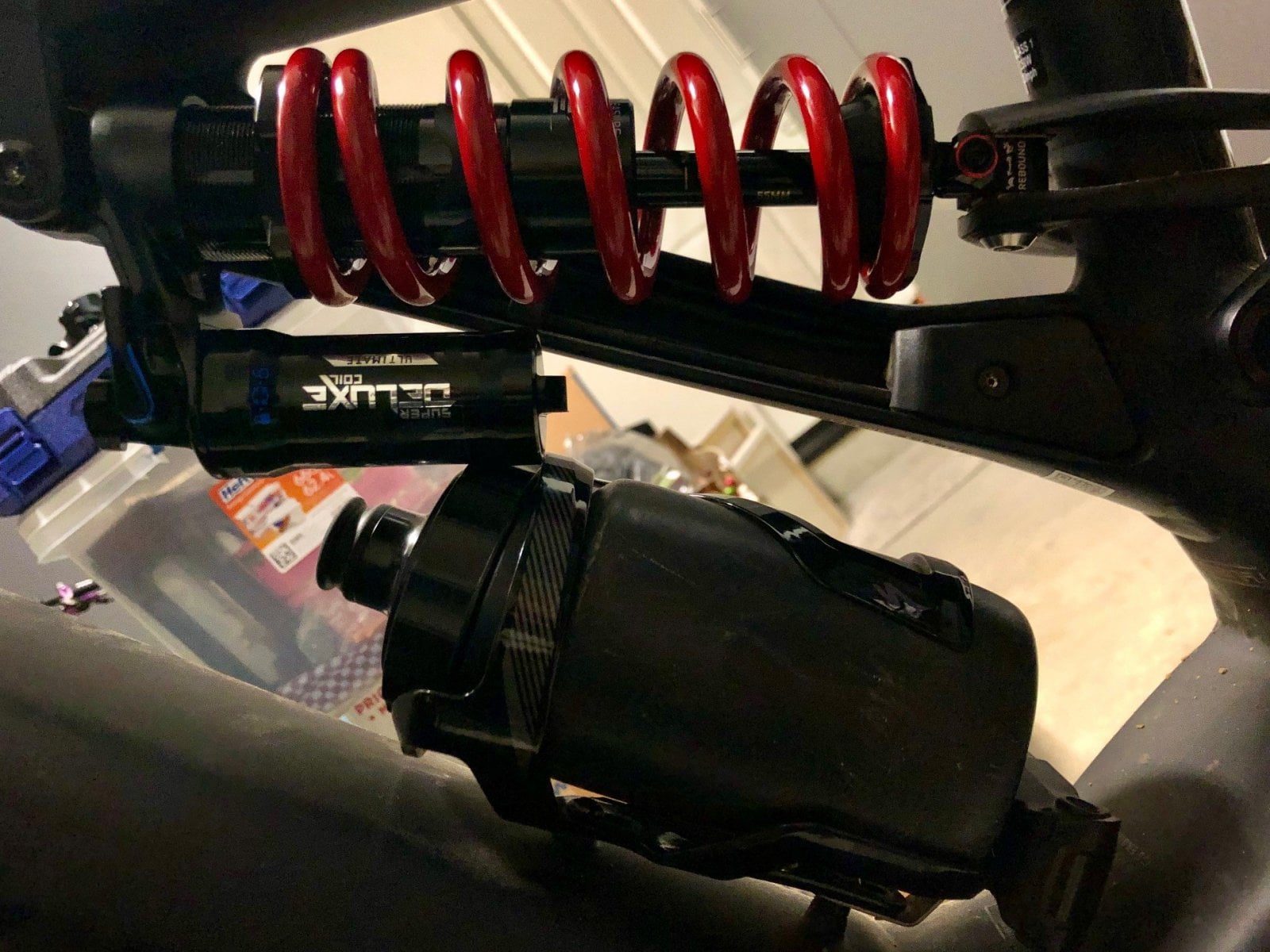

Hello
Just got a levo aluminum. I plan to put a rockshox ultimate deluxe 210x55 since its available locally. Anyone whos uses this shock did u order additional hardware or stock hardware for the stock shock work? Plan to get 550 spring 155 lbs naked... Looking at different reviews hopefully will a right size...
Hello
I did the same to my aluminum Levo, the only extra tools was this one 1/2" x 1/2" Rear Shock Bushing Tool to take out the factory bushings from the coil shock, that and Allen keys will do the work... I put Loctite threadlocker just to be sure ...

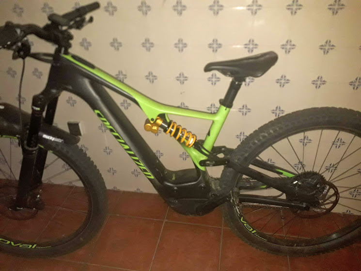

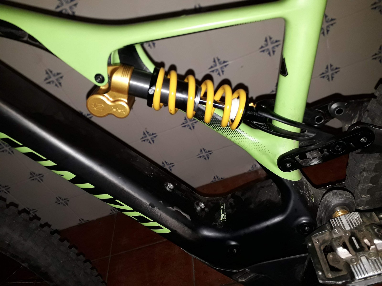

New coil shock
Ohlins TTX 22M Coil 2019+ Stumpjumper/Levo 210x52.5 (OSBC1979) ...
haven´t tried yet

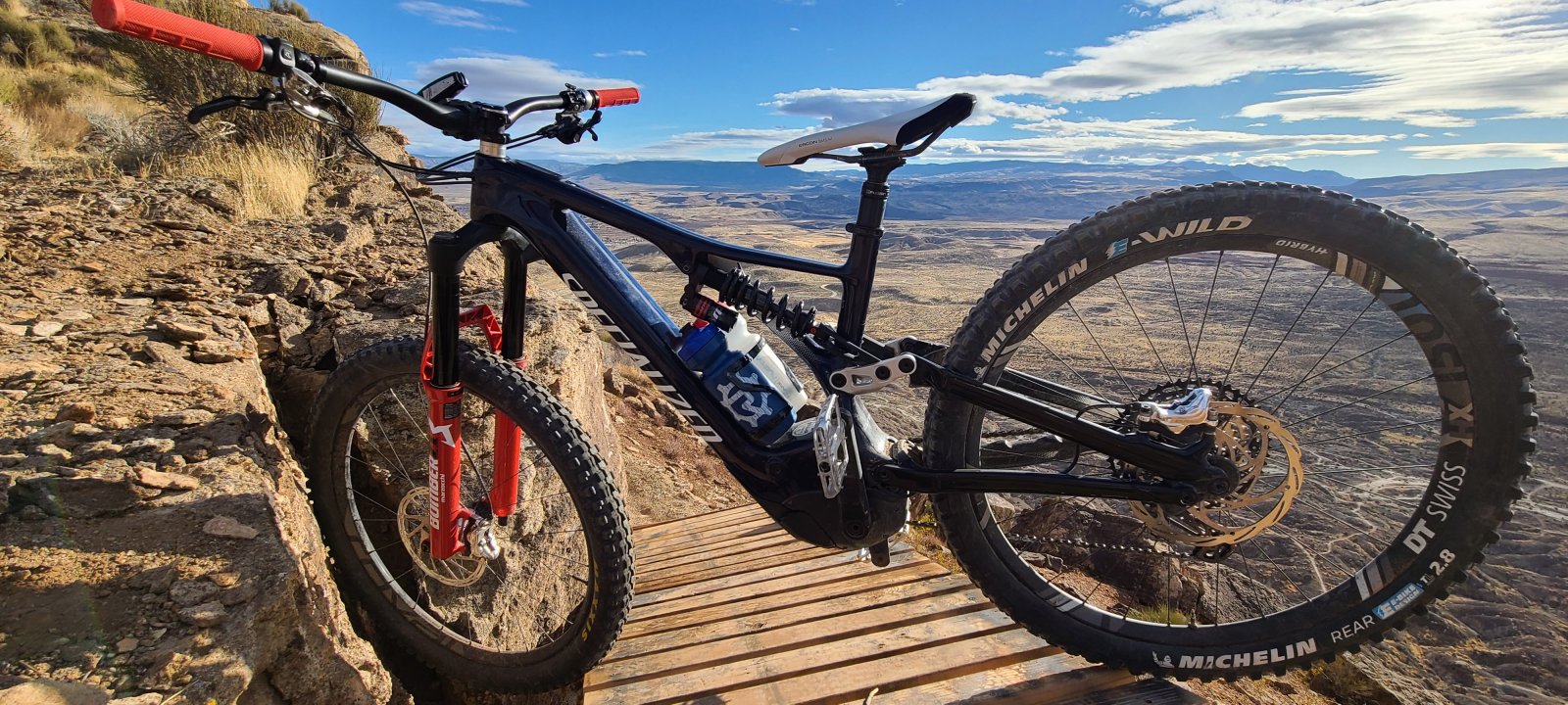

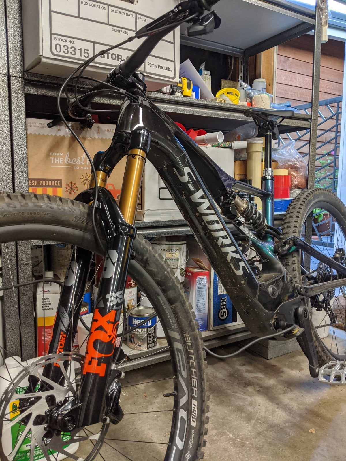

I went with the EXT Storia Lok 3 and have no regrets. Have the new fox 38 up front in 160mm. Luckily I got the 19' S-Works for close to half off in late February 20 just before Covid-19 hit the US and before all the bike shops sold out of E bikes so I could splurge on some components.
I went with the EXT Storia Lok 3 and have no regrets. Have the new fox 38 up front in 160mm. Luckily I got the 19' S-Works for close to half off in late February 20 just before Covid-19 hit the US and before all the bike shops sold out of E bikes so I could splurge on some components. View attachment 43332

Yes I love the Storia it's pretty progressive and paired with the cascade link and the correct spring it works really well. The 38 is so much better than the 36.
