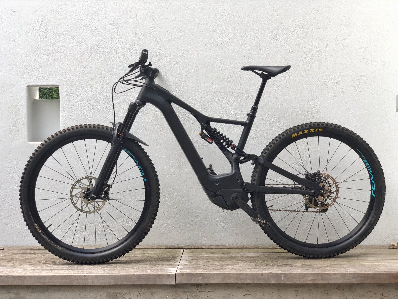

Hi there. I flipped the flip chip to lower positiom.
And made an offset insert ring to go with that flip chip since ohlins shock id is slightly bigger than original equipped rockshock to make a bit of clearance between seattube and u shaped link connecting to lower eyelet of the shock.
Which ohlins shock is that?
And what eye to eye and stroke length did you use?
Looks great!

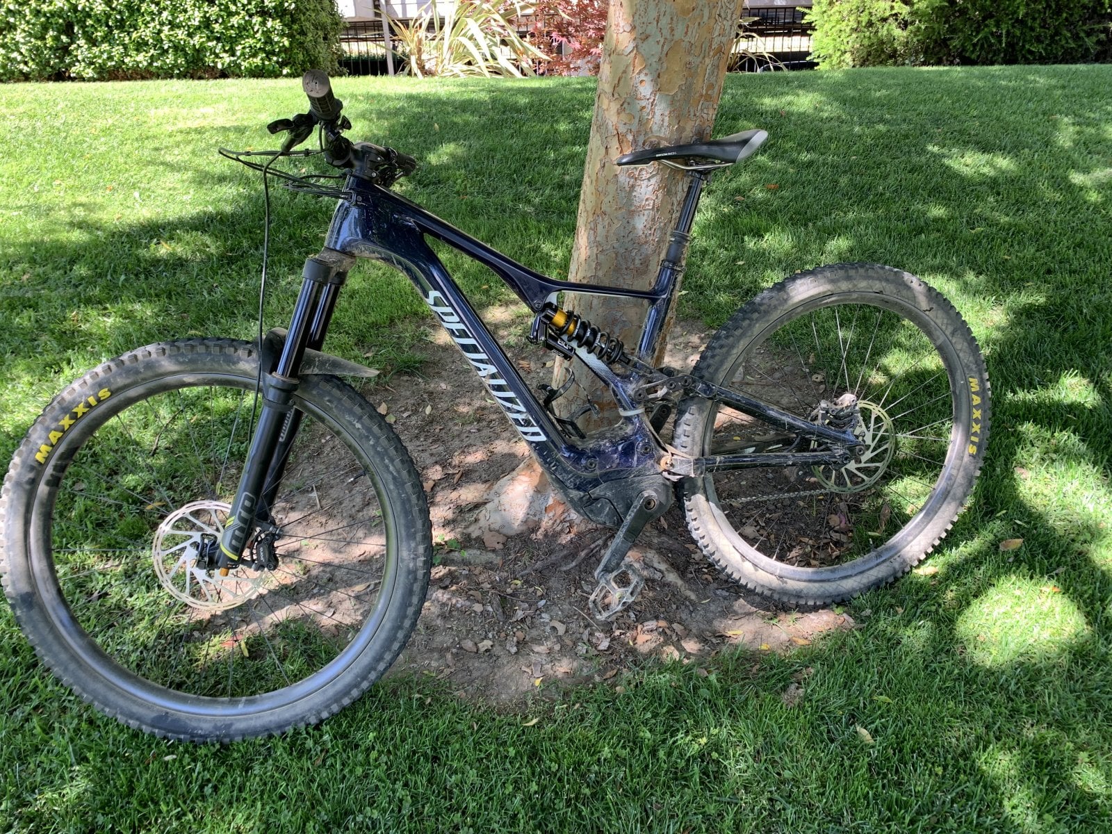

So I got the cane creek dB coil CS, and it’s amazing. I paired it with the 160mm MRP ribbon coil fork and I have to say the small bump compliance is pretty incredible. The CS version of the dB is ok to use on the levo after extensive conversations with cane creek since it has a larger shaft than the inline coil. Such a huge improvement. Love the looks of those other coils as well!
To clarify. Marzocchi fits perfectly. No need to change anything. It’s been a great shock.
210x55 works perfectly. No need to change flip chip.
You get extra travel (156/7mm travel) without any frame issues whatsoever.
Any 210x55mm shock will work.
The 55mm is the amount the shock travels. And there is plenty of space for the extra travel within the frame.
With 160mm fork and almost 160mm rear coil travel the Levo is now a perfect trail/enduro bike.
Wouldn’t be surprised if Specialized markets the next Levo as a 160mm travel bike just by adding longer travel fork/shock with little or no frame change.

The 55mm shock stroke doesn't affect the clearances of the tires significantly.
If your tire fits in the rear triangle it should work.
If you've got an air shock take all the air out and see how close the tire gets to the frame.
I've been running Butcher 2.6's and then Maxis Minion DHR II 2.4"
Diameter/Circumference of the 2.6's is pretty consistent across 29" tires.
The volume change is mostly in the width not the height, but it does vary.
Rim width also affects the height.
