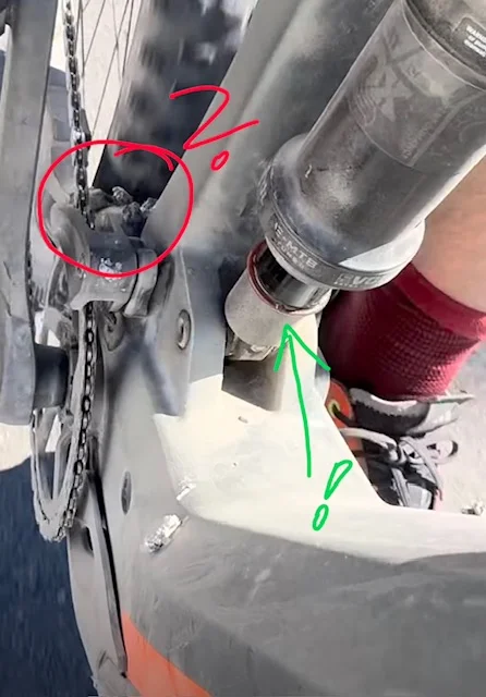

I had a question about your rear hub previously, but no response. Do you run a Industry 9, Hydra 2? I had a problem with mine and it was making the clicking noise also when pedaling. If you are not running this rear hub, please disregard. :-)
Sorry for the late reply, the bike is a cube hybrid stereo 140S from 2022, it has all original parts nothing has been changed or replaced. I am not sure of the make of the rear hub. Did yours make this noise?
Try pedalling the bike whist in a bike stand. If necessary cover the rear brake slightly so that more pressure on the cranks is needed.
When you pedal whilst on the bike you also cause movement in the suspension and apply pressure to the seat post and bars. You would eliminate those as potential causes of the click by rotating the cranks without being sat on the bike.
It sounds to me that the click coincides with the the power part of the crank rotation 2oclock through 5 o'clock. That is when the shock gets compressed. I have to say the bike looks very dusty..including the shock shaft below the o ring. Try removing and cleaning the shock mounting bolts and shaft
Thanks will try cleaning and removing shock. Its not seat post or headset.

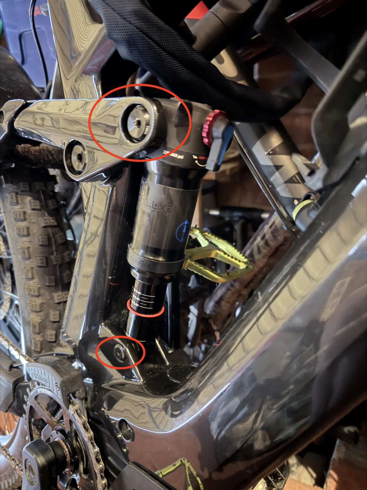

Hi, I have the same noise and have also re-mounted the motor, serviced the pedals and replaced bearings, cleaned and remounted seat post, re-seated rear wheel and so on. Next two things for me are to remove and reseat rear shock and then I guess try to rebuild the dropper/seat post assembly? No idea how to do that so research starts soon.
@GrahamA did you need any special tools to remove the rear shock? Mine's a RockShox Deluxe Select+ (on a 2022 Cube Stereo Hybrid 140R).

No worries, I jumped in and did it this afternoon. If yours is the same as mine, it's really straightforward. Two 5mm hex bolts either side of the top of the shock and a bolt that fits into a socket on the other side of the shock at the bottom. Removing the top bolts first, the frame lowers easily onto the rear tyre.
Cleaned and lightly greased. Didn't stop the creak 🤦 New chain next, then the drop post/seatpost 'rebuild'.

What is that gravel there? BTW in the video, there seems to be to much pressure in the damper. There is lots of unused suspension, i.e. covered by dust.
I live in a place where it never rains so there is always lots of dust on the trials. Even when the bike is clean it still makes the noise. Could too much pressure in the damper be causing this clicking?
Do not think the damper makes the noise but the setup is to hard.
Please check your shoes / laces, if these are hitting the frame. You wouldn‘t need the first one with that causing ticks.
