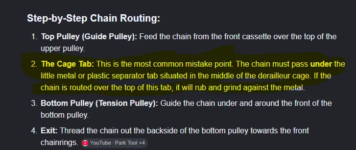

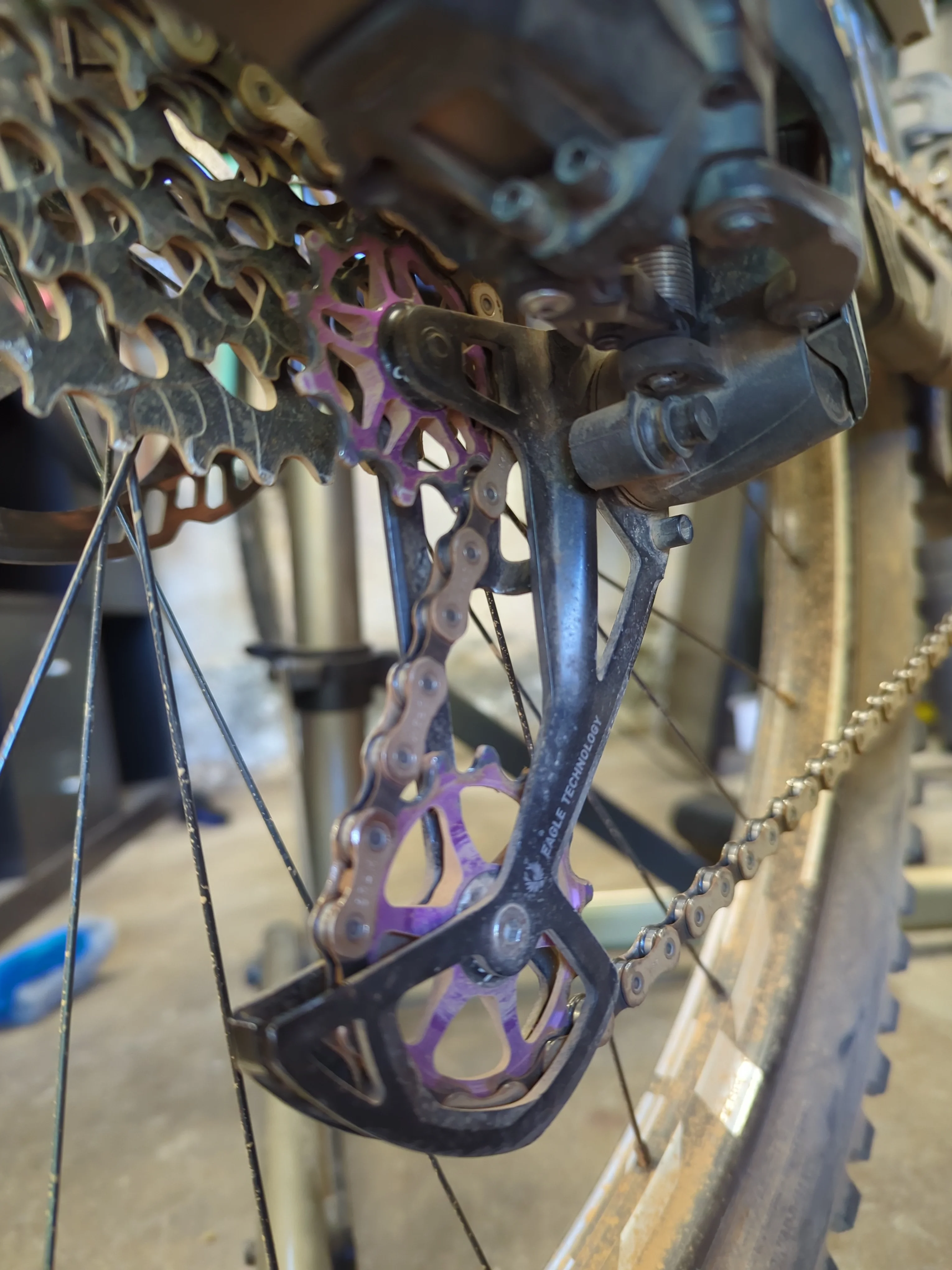

You've fed the chain through the derailleur incorrectly. Check it and do it again.
