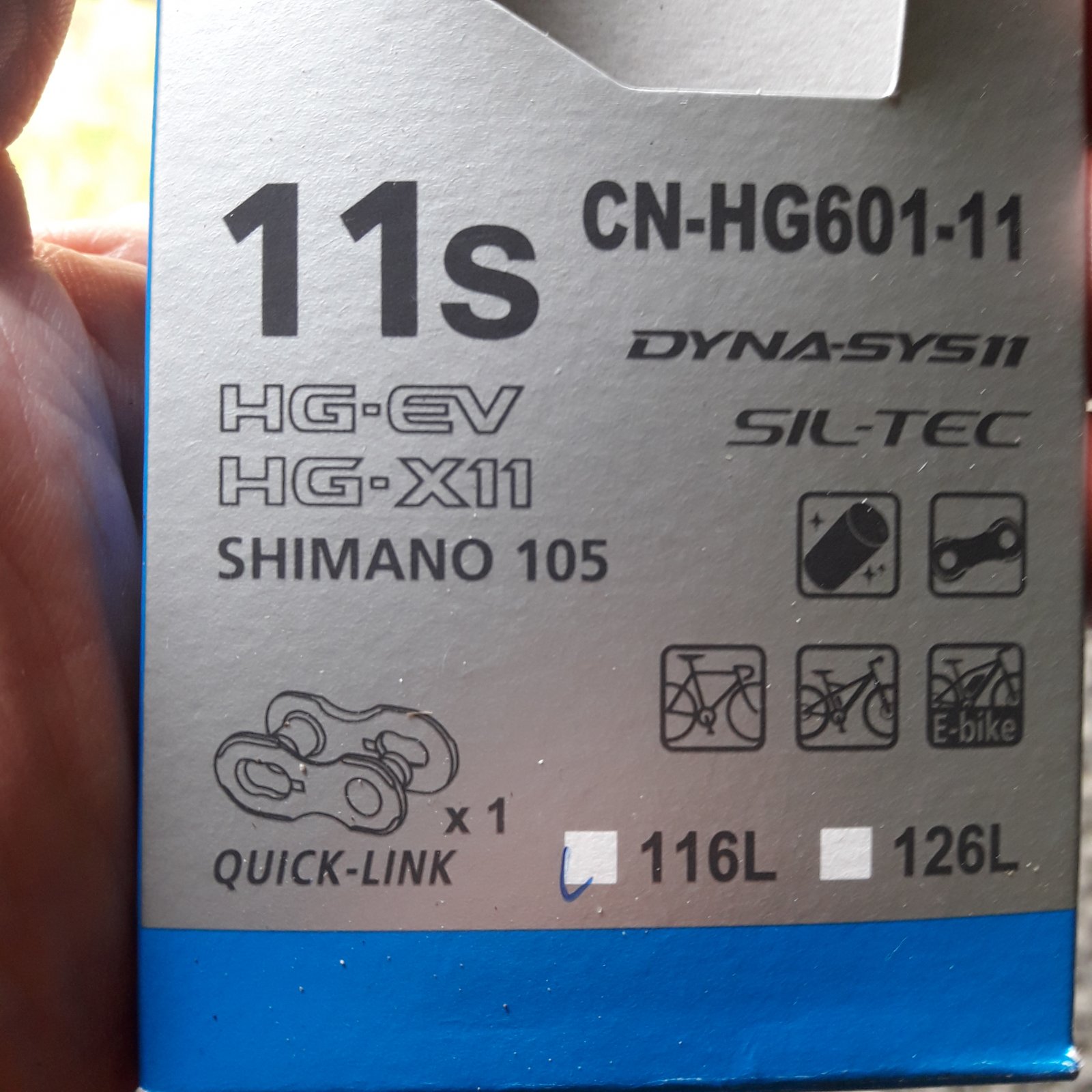

Just changed original chain from Levo Comp Alu, GX group. At bang on 1mm stretch. 1060km ridden only in the Alps. Replaced with 116 link Shimano 'e' slx/105 chain as I find these work well on road bikes. 116 links exactly as supplied from original. Not ridden yet so no idea if it works correctly on the pistes. 18€ from bikecomponents.de
Update to the above. The Shimano HG601 is working perfectly. I took 500hm yesterday and can report no slipping, shifts are crisper and faster. The original was very clunky and slow in comparison. Shimano has my vote!
