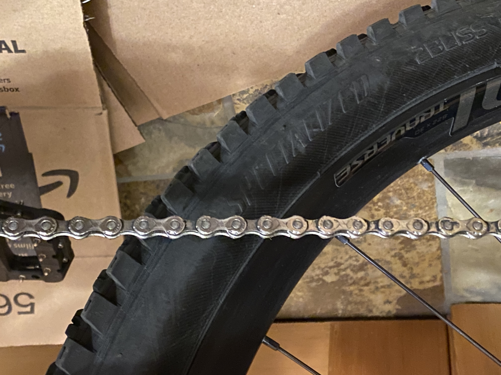

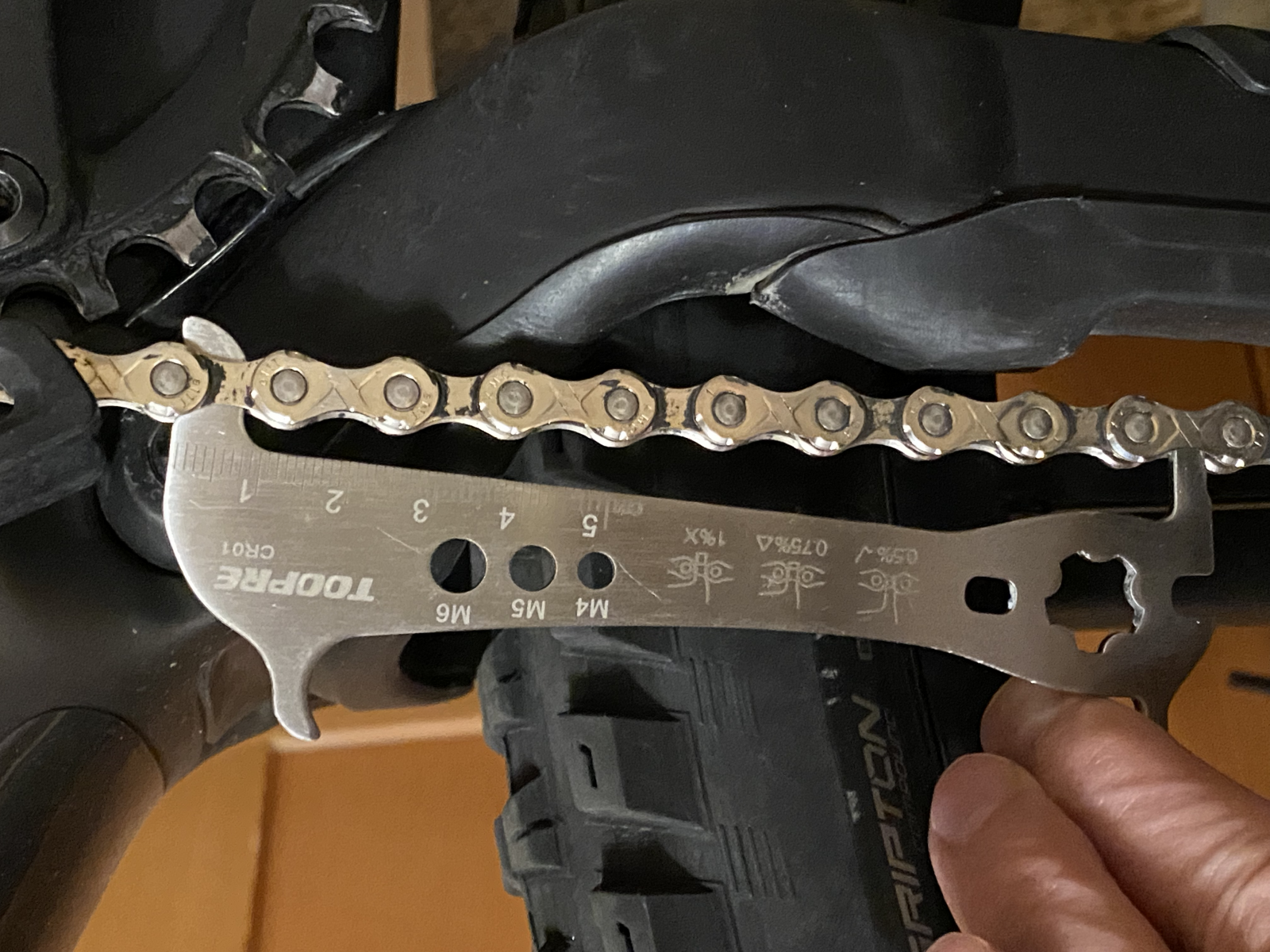

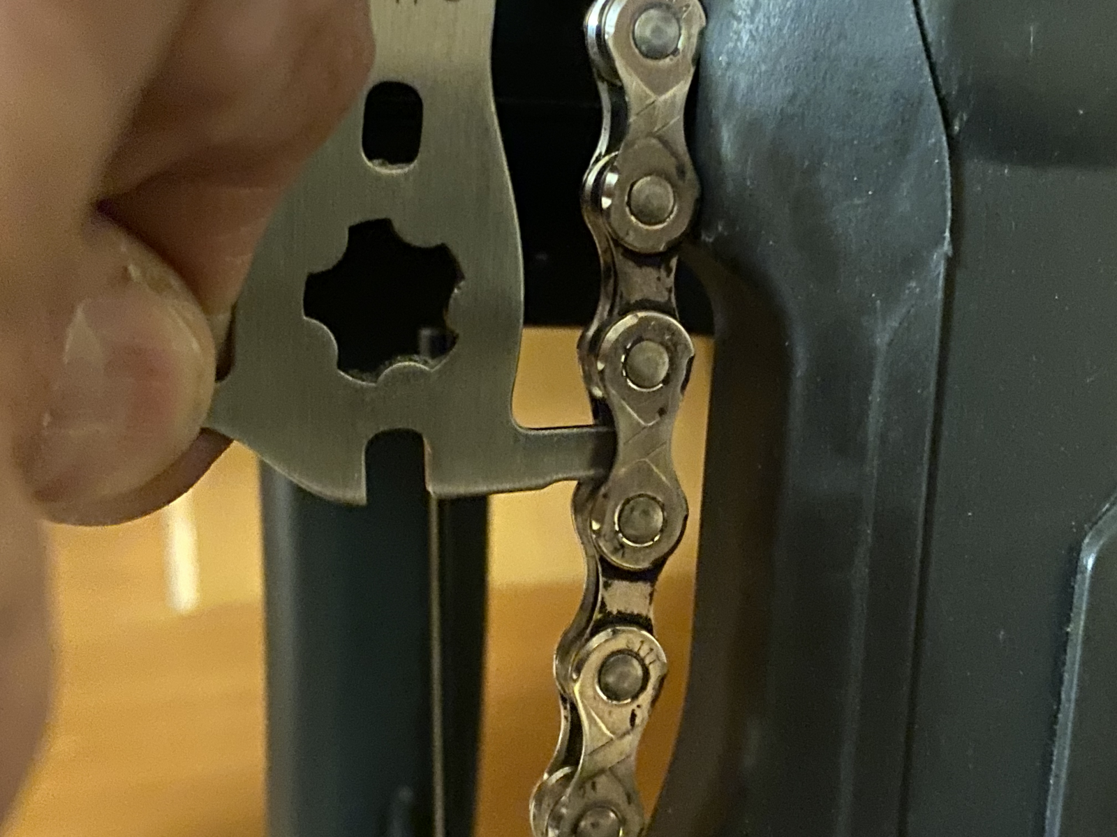

I have had my 2020 Turbo Comp for 16 months now. I ride mostly dry loamy trails that are rocky and root covered from time to time. Not overly dusty and I have ridden in very little mud. I also ride in the winter in with temperatures varying from 0 to -20C. I only clean my chain, chainring, and cassette when they look overly dirty. I only lube occasionally as the chain normally looks pretty good. I have had some hard shifts that concern me about the chain holding up to failure. I took my bike in to the dealer to look at the chain and perform the first free service, that is supposed to be done after 200 hours of riding. The odometer showed 2108 km. The bike shop tech used a gauge similar to the one I recently bought, a Toopre CR01. He said the chain was worn out. His gauge indicated 1% wear, and he said I will need to replace the SRAM PG-1130, 11-speed, 11-42t cassette. As well as the chain of course. (KMC X11ET, 11-speed w/ Missing Link™).
They ordered the a new cassette, and sold me a new SRAM PC X1 11 Speed Chain, 118 links for $41 CAD. When I got home, I used my new chain gauge. What is odd, it indicates less than 0.5% wear! Hmm.
I always use 3M teflon lube on my chains. I have used this lube on all my bikes for over 20 years. I have never replaced a chain.
SO, can you understand that I am having problems understanding what I have been reading? I am guessing that those who clean and lube their chains after every ride are doing so after bathing their drive trains in muddy water, mud or sand. Am I wrong to think that riding in conditions that do not cover your chain in crud will permit the chain to last much longer than what I am reading here? I think I can get another 500 km or more wear on the links based on chain wear, (Stretch). There are chunky bits taken off the sides of the links, but the rollers are still good. IMHO.
I will attach photos of my chain, my chain gauge on the chain and the depth of the wear indicator.
Please let me know if I am doing something wrong.
