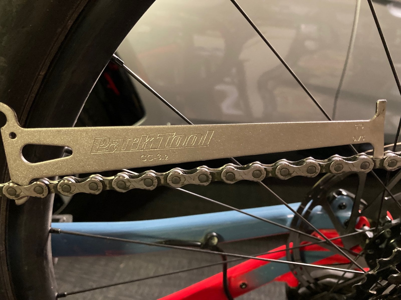

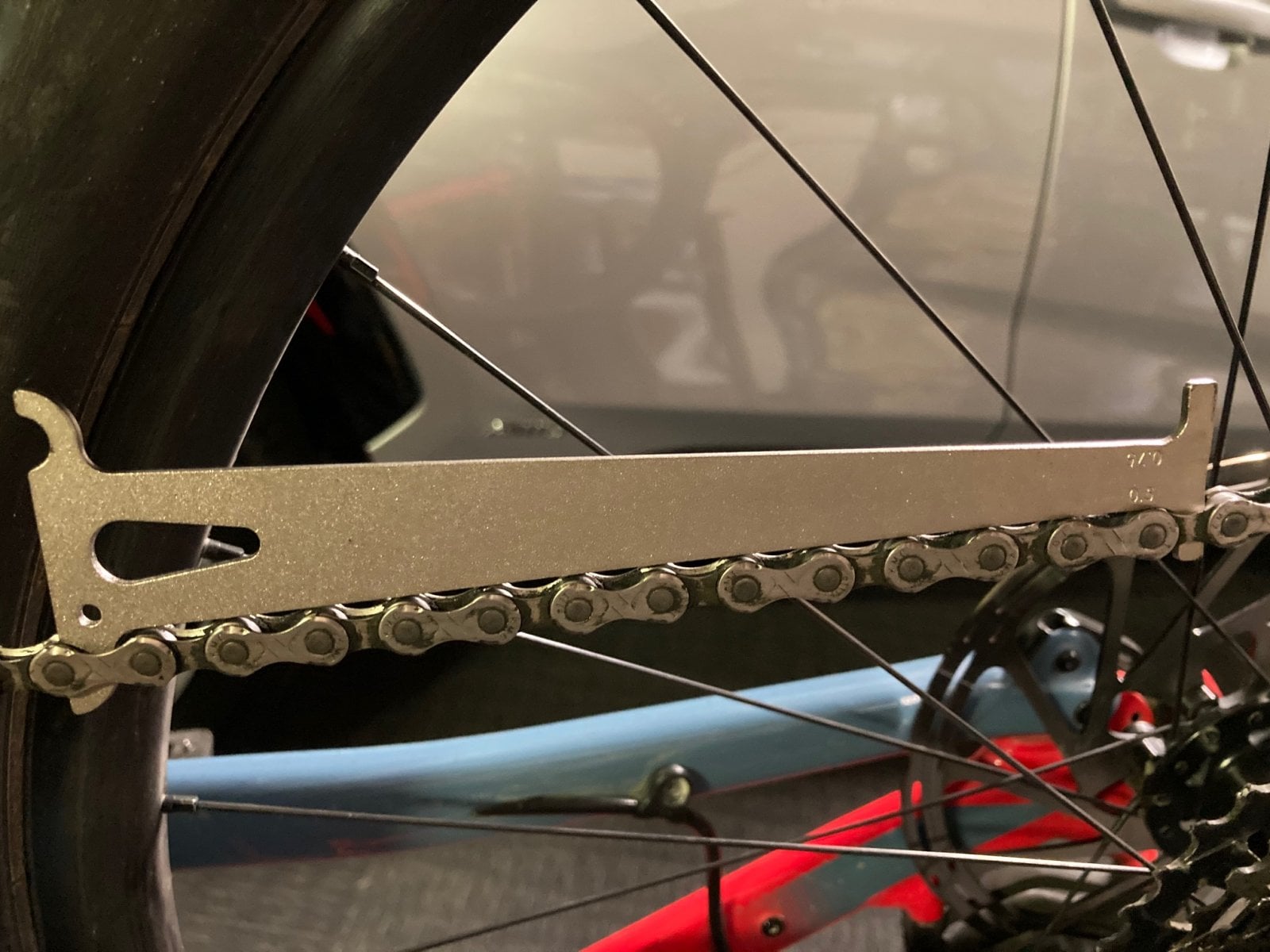

I just replaced my second chain with wear between .5 & .75 using the chain guage. I only logged 1,600 miles on the 2nd chain; 1st chain was approx. 1,800 miles. My new (3rd) chain doesn't slip, but it is making some noise up front when it's under load so guessing the chainring teeth have flattened out some. Will likely have to replace chainring and cassette after this chain goes. Overall very satisfied with performance of the OEM drivetrain; KMC X11E chain(s), SRAM XG-1175 cassette, Praxis 32t steel chainring.
If your chainring is making noise under load then most probably teeths are worn out and they will worn out the chain prematurely if not replaced.
View attachment 80863View attachment 80864
The measuring tool sometimes gives a different reading if you remove the chain . Read it on here to do that and it gave a less worn reading on mine. What one you go by is another thing ?
Yes, figured that. I replaced the chainring after a week (3 rides); couldn't stand the grinding noise. Stayed with the $30 Praxis steel 32t. I logged 3,400 quiet miles on the first one... plus 50 not so quiet.
