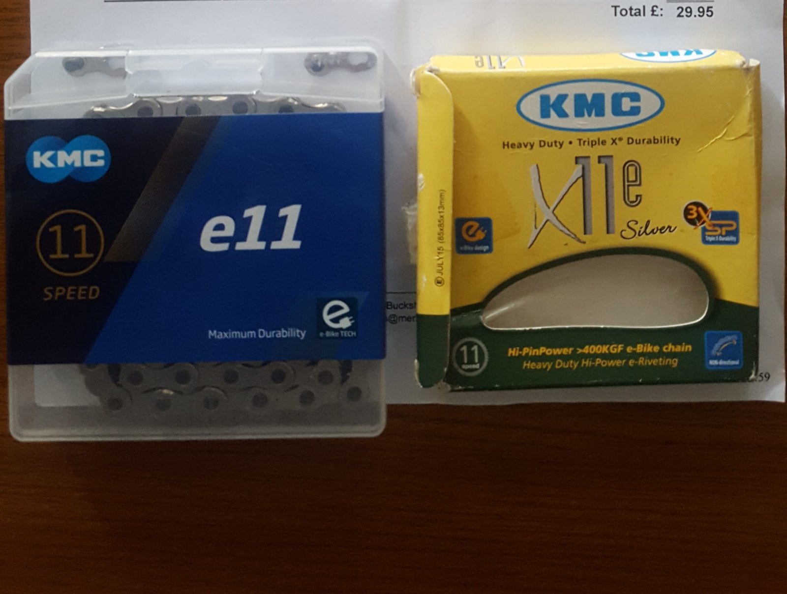

Hi there Iv'e attached a pic of the two KMG (marketed) e-chains. According to Merlin the X11E has become the E11 and are the same in all but name.
I'm getting about 5-700 miles before they fall outside the 1% stretch go/nogo gauge I use.
