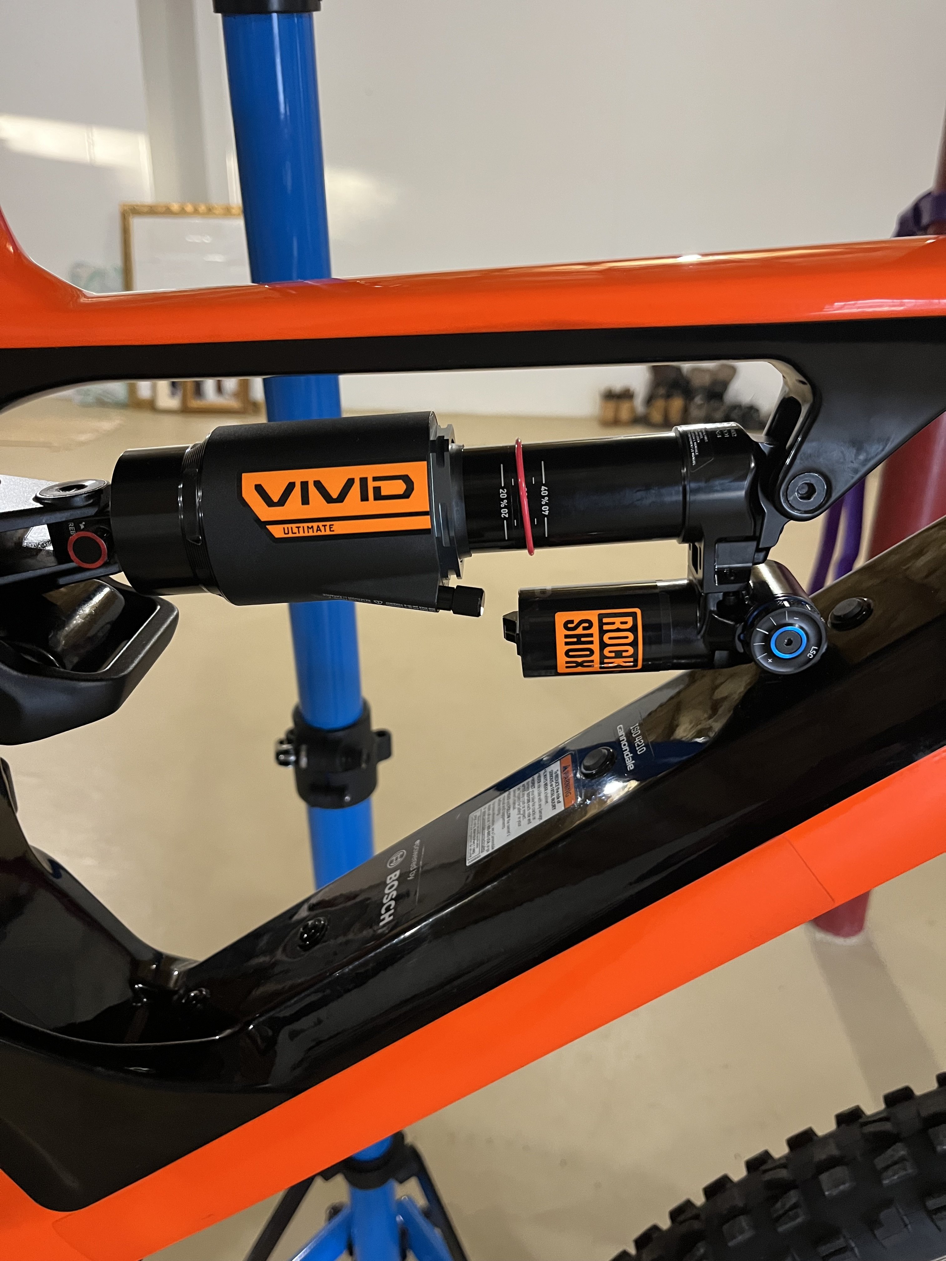

That should work well. I have one on my Forbidden core and it is really performing well. I had intended putting on a coil but I don't think I will.
Good to hear. My suspension shop owner said he thinks its the best shock on the market and feels there is no need to go coil with this shock.

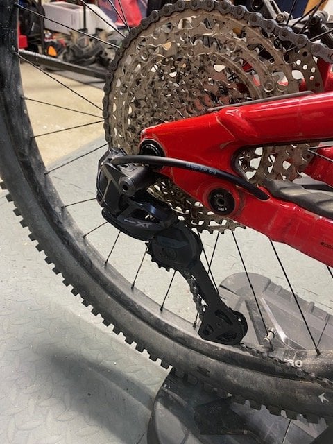

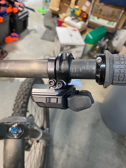

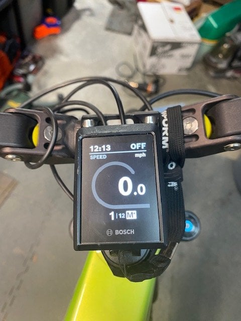

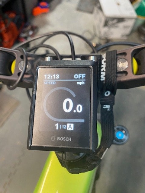

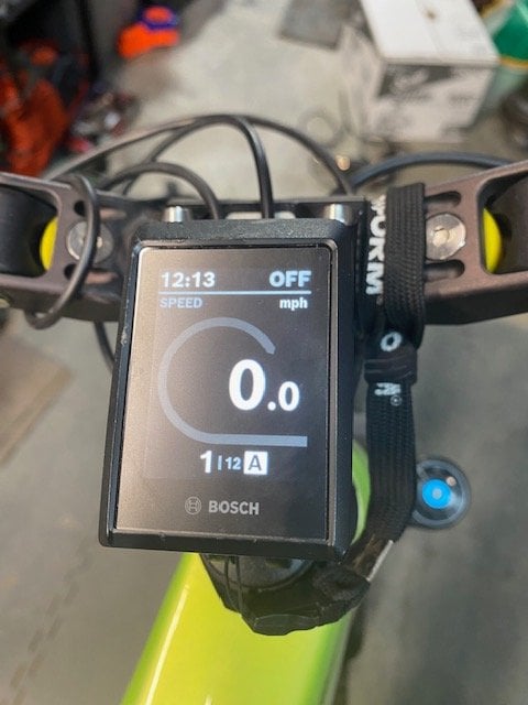

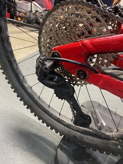

For all you Bosch Smart System riders out there I can confirm that the Shimano XT M8260 Di2 wireless derailleur can be retro fitted to your bike. You will need a Shimano EW-PS300 cable to make it work. Either length will work I have the 1600mm due to it being the only one i could get. You will have to take your bike to the dealer to get the HPP (High Power Port) turned on. Its yellow. I have a Gen 4. I don't know if the Gen 5's are already on. Here is a link to the instructions. https://si.shimano.com/en/pdfs/dm/BES3/DM-BES3-00-ENG.pdf
To get the derailleur to pair with Ebike Flow, you will have to press the pairing button on the derailleur. It will then show up with the other components. You will also have to update the firmware in the E-Tube app. In the E-Tube app when you are connected it will ask you if you want to change your password. You will want to press the later option. Changing the password will not let your dealer do anything without contacting you for the password. Updating the derailleur in the E-Tube app was weird. At first it did not say there was an update. Disconnected from the app and paired it again and it showed up. You have to hit the pairing button on the derailleur to connect to the E-Tube app. I does not connect automatically . To pair the shifter there is a QR code on the left side of the controller. Once everything was connected and the derailleur was updated it was good to go. The display for what gear and mode you are in only shows up on the speed screen on the Kiox. M+ and Auto does work. To change the mode just hit the button the the left of the shifter paddle. For auto to work you have to press and hold the menu button on the Purion with any screen other than the settings screen on the Kiox. You will see ride mode on the screen. Press the left or right button and you will see a cadence screen and just select your average cadence. Mine is set to 80. Press the left or right button to get back to ride mode. Press the up button to the closed option and you are ready to go hit the trails. Hope this helps anyone who wants this on their bike. I will say I did have a huge Oh _hit moment when there was no power to the derailleur when I pressed the pairing button. Cheers.
View attachment 173452 View attachment 173453 View attachment 173454 View attachment 173455
This is my next upgrade. Thanks for posting.
I have a Carbon 1 and updated the rear wheel with i9 hub and xtr casette so hopefully the wireless will work with my cassette.
It will just make sure to order the one with your current cassette gears.
