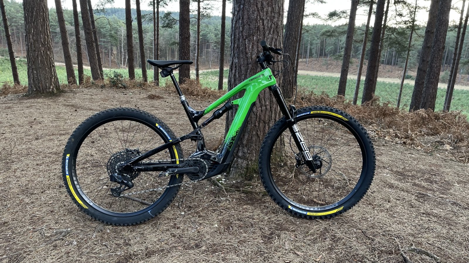

I'm riding a Moterra Neo Carbon. Fun bike to ride, really enjoying it. I also made a few upgrades.
I kept the base platform: carbon frame (great geometry and design), ZEB 160mm fork, and the powerful Bosch CX Gen4 (non Smart) motor, 625Wh battery and minimalist Purion display
I'm riding a Moterra Neo Carbon 2 (silver) which I bought in 2021. Fun bike to ride, really enjoying it. Fitted a Rockshox coil MM320 tune, DT Swiss HX 1700 wheels 35mm with 350 hub, 36T Sram alu chainring, raceface aero 160mm cranks, hope gravity 50mm stem, MTX red label brake pads, carbon handlebars, schwalbe Eddy current tyres, and the list goes on...
Yeah they are a great bike. Brilliant frame and suspension design well worth modifying to suit your particular riding style. Your upgrades sound well thought out. Good choice of wheels. Keep an eye on the internal motor mounts I have just broken a 2nd one and they are known to come loose. It's a Bosch issue and probably requires a new motor if you snap one off
There are two alloy mounting brackets attached with 5 mm bolts on each side tat the top of the motor and the main motor bolts are fastened into that bracket. It's the 5mm bolts that can loosen and if you are not careful they can break. Unfortunately you need to drop the motor in order to check that they are not loosening
