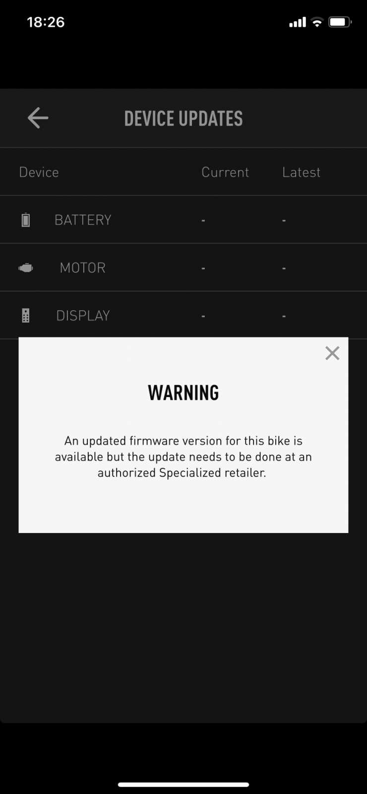

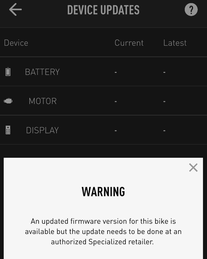

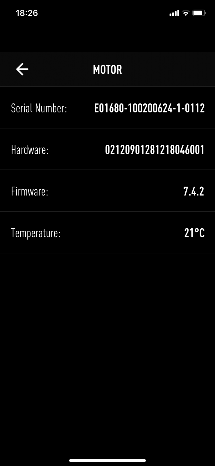

Updated firmware just a few days ago, and today have this in Mission Control, a warning about available update, and no versions listed, so can't tell which part needs an update. The versions are shown on each component's page, and they are: battery 2.4.4, display 1E.B.0, motor 7.4.2. The help page (the circle with the question mark in the upper right) does not list any newer versions. Could be a coincidence, but this happened after Mission Control update from Play store, so making me think this could be a Mission Control glitch rather than a real update available??

Hey @montivagant,
Thanks for sharing and sorry you experienced this issue. This was caused by a configuration change when we released our latest version of Mission Control 2.6.0.
You should no longer receive this pop-up and your bike is on the latest firmware.
Please let us know if the pop-up continues.
Thanks, Specialized Team!

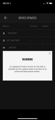

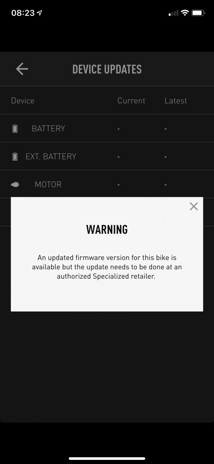

mathiaspap
Feb 23, 2021
24
Cyprus
Can anyone check the firmware on their Gen2 Levo please? Mine was up to date as of April but having just checked I'm getting the attached message? I've not seen any other threads for a new update.
Cheers!
I think its a bug of the Mission Control app. I updated my bikes firmware a few days ago and everything was fine. Mission Control had an update in the App store on Wed and since then I am getting the same message.
@Specialized Rider Care Can you please have a look?
Thanks

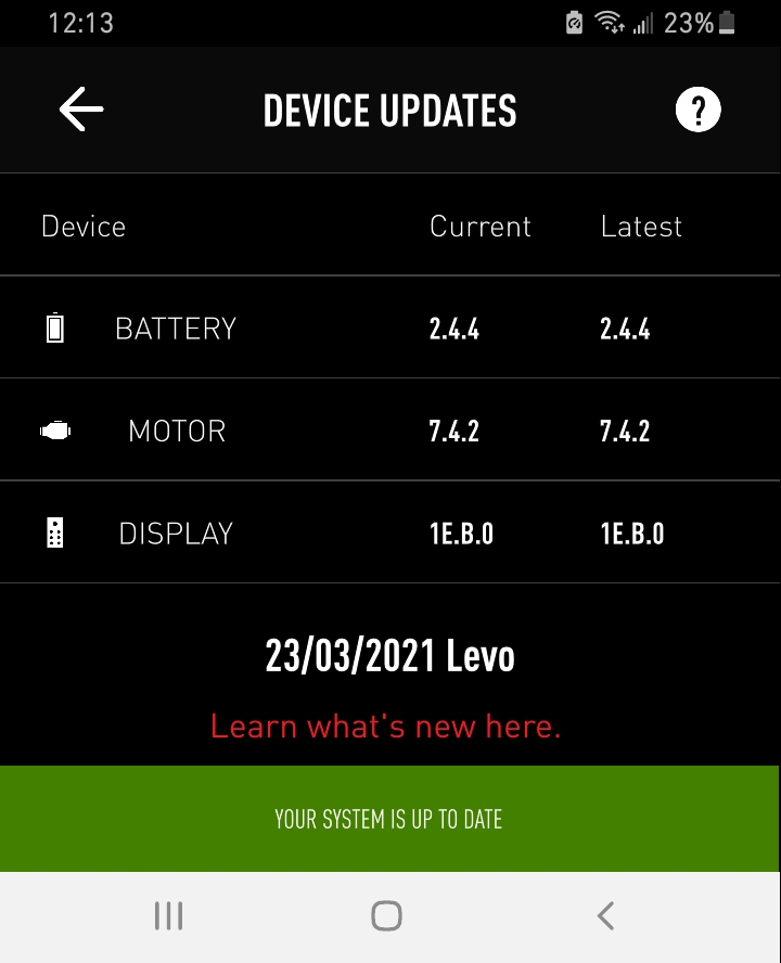

montivagant
Apr 11, 2021
14
18
BC, Canada
did you solve the problem ? I have the same
@sqter72 Did you try looking back a bit before spamming? I tagged you specifically in my reply yesterday:
@gingergirl @sqter72 I got rid of it by clearing data of Mission Control app.
"I got rid of it" means yes, I solved the problem, and today my Device Updates page looks like this:
I provided enough info, I even googled a step-by-step for iOS for @mathiaspap. Why do people think it's appropriate to ask basic stuff about their mobile device on emtb forums instead of using Google themselves, hello? An I have to keep it peachy or risk getting banned, right? End of rant.

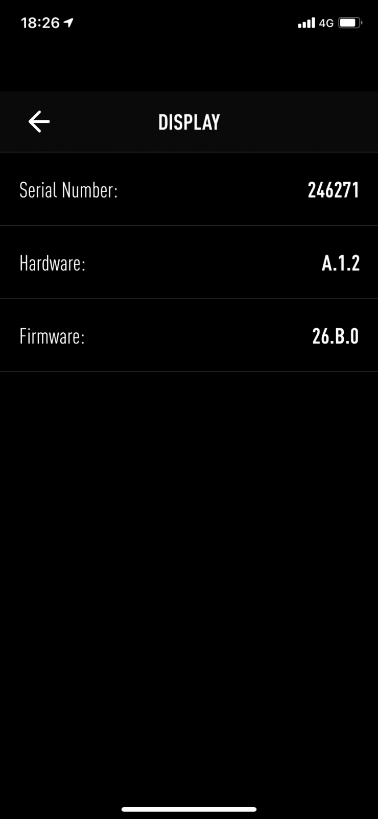

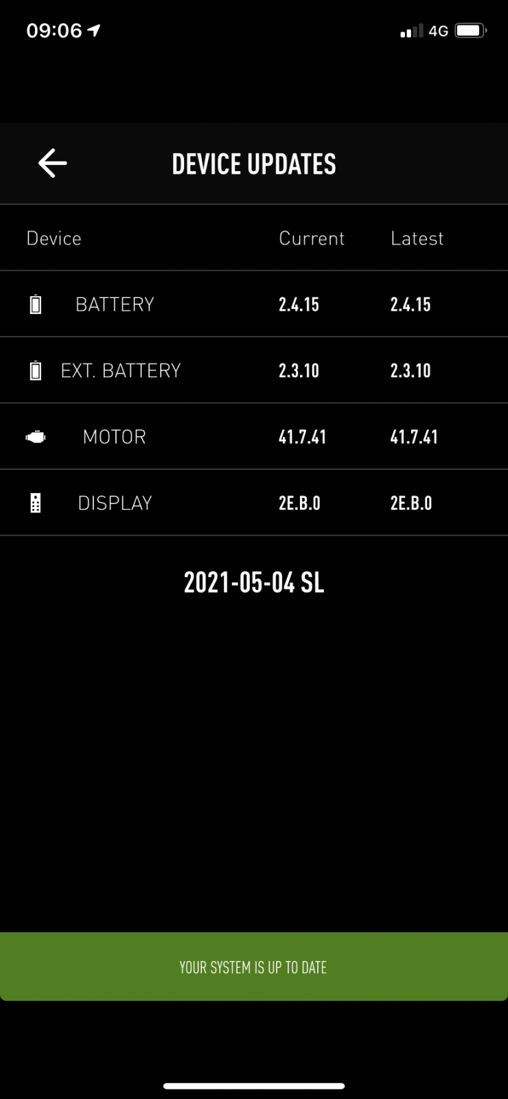

Mission Control 2.6.0 iOS is also "broken" for Turbo Levo SL:
SL recently updated to latest versions of Battery 2.4.15, Motor 41.7.41 & Display 2E.B.0 before Mission Control 2.6.0:
After update to Mission Control 2.6.0 iOS [iPhone XR]:
Tried full App deletion and re-install/registration and problem persists.
Please investigate and fix soonest. Thanks.

i had on my levo sl and uninstalled the app and now impossible to login
double check on the specialized site after login (successfully) seems that it's impossible to check registered bikes
@E759 sent a direct message. Thanks
