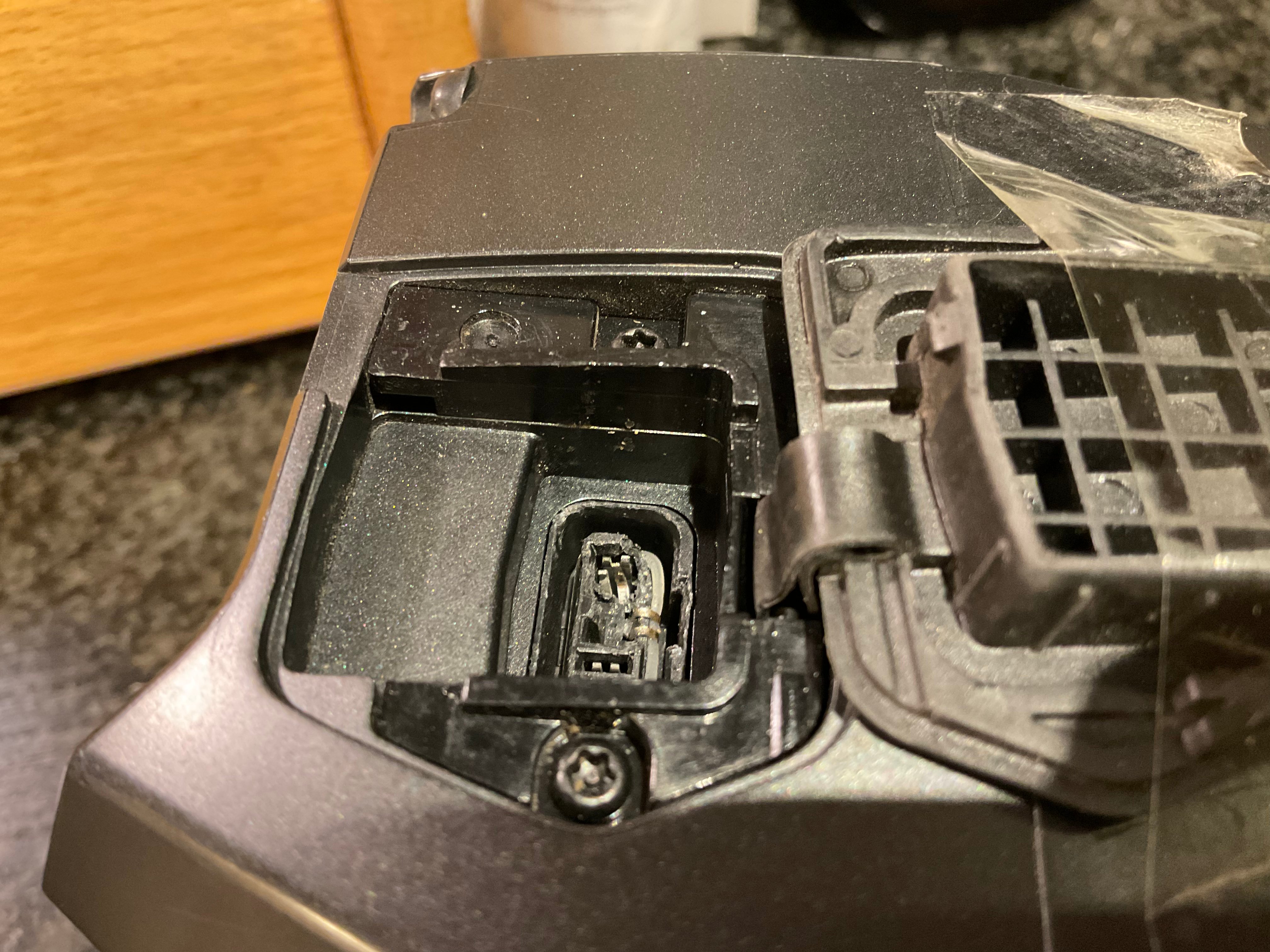

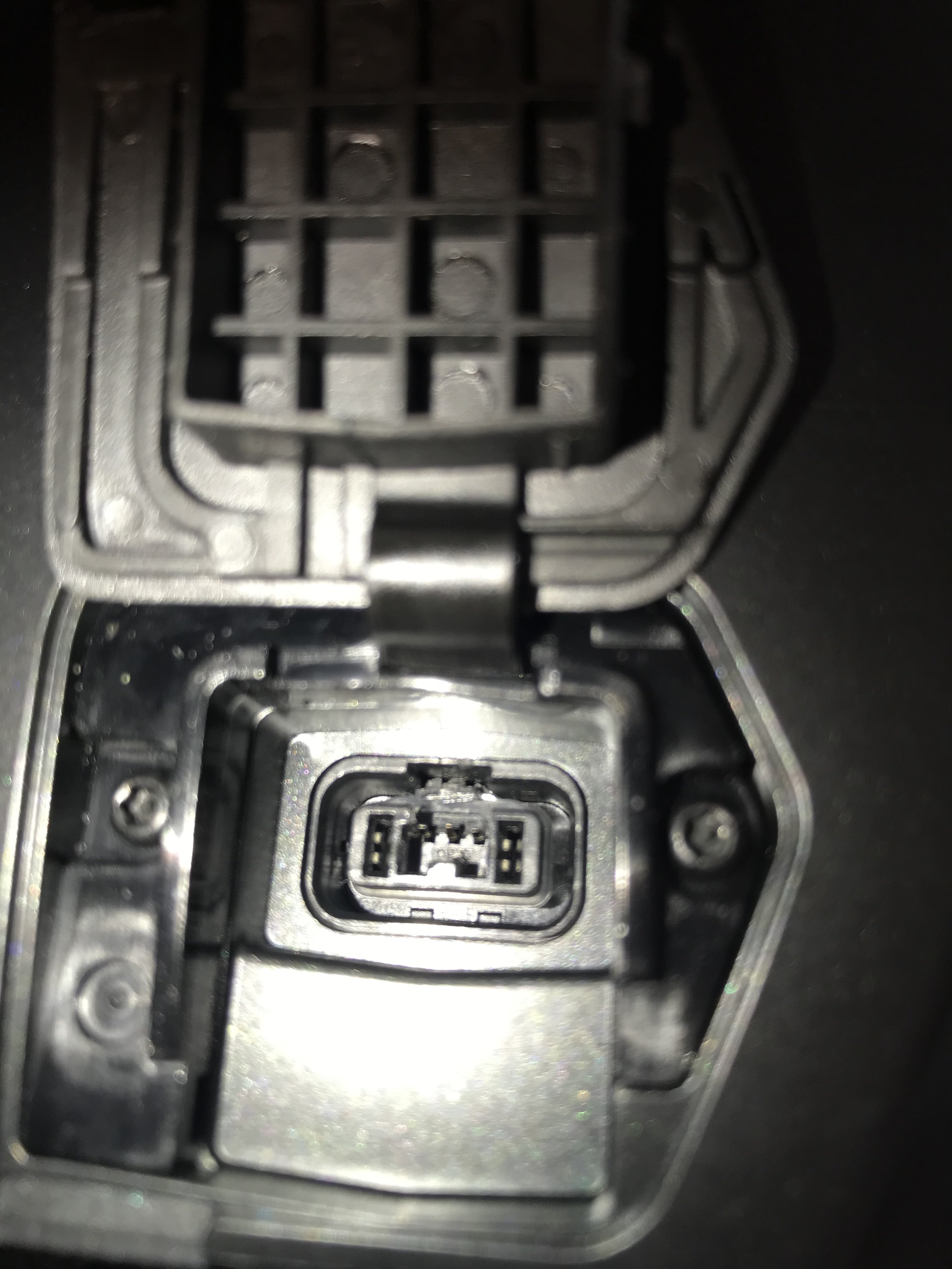

Hi …thx for replying. It’s a Merida E Big 7 300. The battery is a Shimano BT-E8010. It’s a tiny bit of plastic that is missing around the connector pins. I did take some photos but that are not all that clear. I’ll attach them…thx. The first photo is of our battery…the second is of an identical problem I found on this forum. Sorry…the photos have come out the other way round…2 nd is our port.
6058A827-C2BD-4AC5-B07B-3E1BF9AB9A8C.jpeg 68D0E98D-5E17-4D0E-B960-AD9468947E47.jpeg

Oh wow, ok so that's not what I thought I was going to see and I can see why you're going to struggle with getting spares.
I take it the battery is now not working or is intermittent as the contacts are not held in place?
Ask a silly question but whats breaking that part? (if you know)
No idea… they say the charger has been rammed in!! Not so… been super careful as broken one already… new one cost £570 and it was on only its 5th charge! The issue is that we can no longer charge the battery!

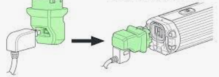

Normally, if the battery is mounted on the bike, there is a "charge port" where you connect the charger.
The charger you have should have an adapter on the end of it to charge the battery when it's not on the bike (using the port where it normally connects to the bike).
It could be that the charge port is getting damage when you put the battery on the bike, or when taking it off. Maybe it's not lining up correctly for example.

There is no adapter…it’s the same charger used when either mounted on the bike or off. The battery slides in to the bike by means of a key system which releases a kind of peg and then locks it into place. We don’t leave the battery on the bike in these cold conditions. There is an adaptor but because of the plastic mounting it won’t fit into the charging port. The battery slides into the battery mount from the back whereas the charging port is at the bottom on the side. I’ve left the charger with the bike shop to send back to Shimano to see if it’s the plug in bit that is faulty…fingers crossed.

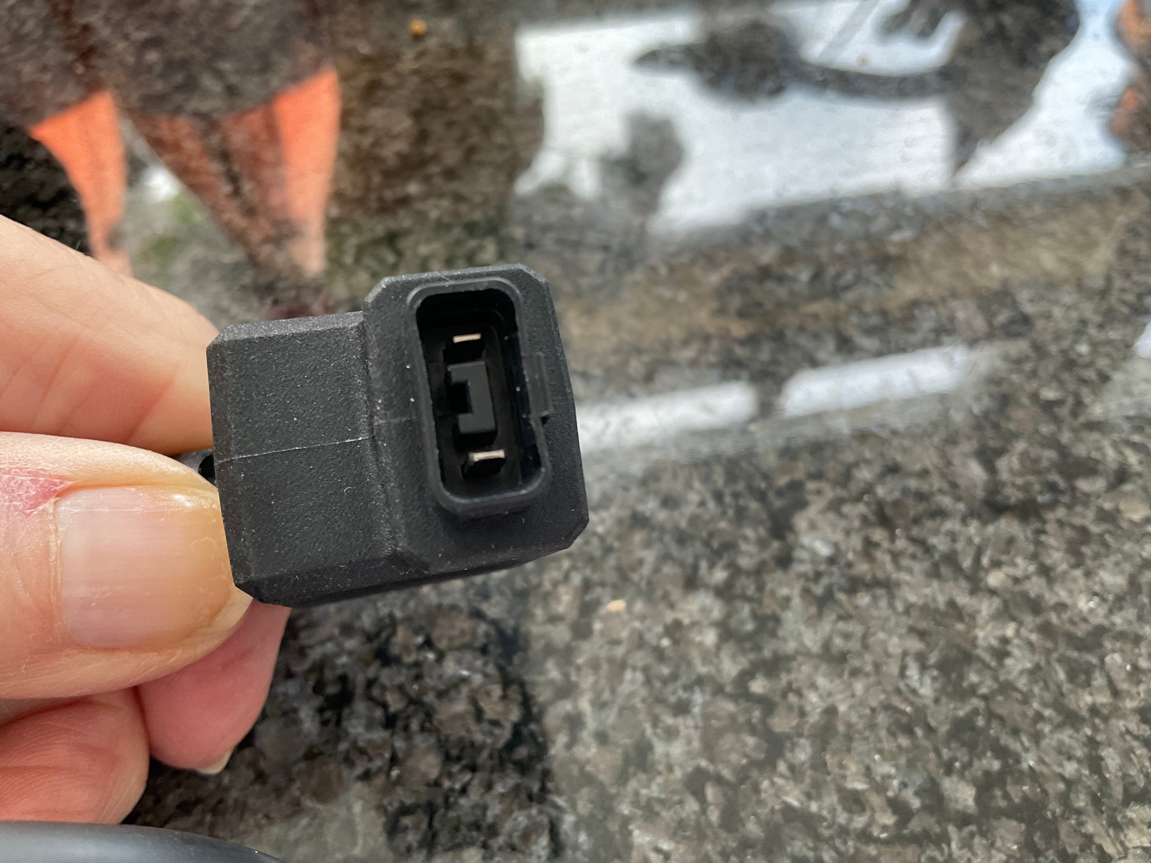

Thank you so much for your interest. The ‘new’ battery has been sent back to Shimano along with the charger. But because I thought it might be a charger problem originally, we bought a new one which is still in its box. I’ll get his original battery out and the new charger and try what you suggest. Thanks so much for your suggestion…I’ll let you know if it works.

If you’ll post a couple of well-lighted close-ups of the messed-up port and the plug end of the cable, I’ll offer an opinion on whether it can be fixed. I like teasing things like this out!

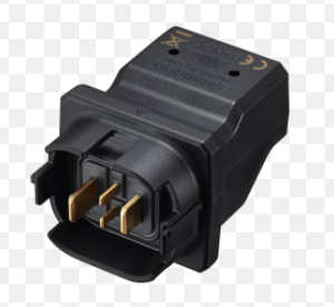

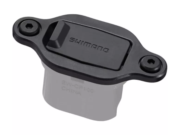

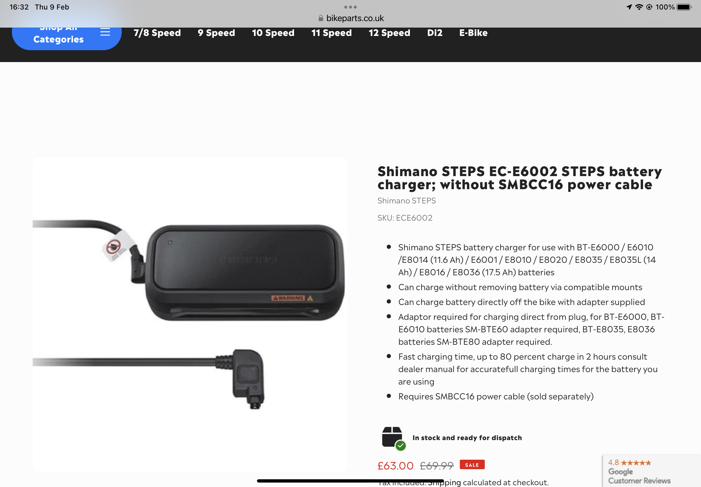

For anyone wondering about the "Satellite charging" option, that's the Shimano EW-CP100.
You'd have to mount the charge socket on the frame somewhere, which if it doesn't have a blanking port already setup would mean making a hole in your frame ! :eek:
Or you could just connect it to the motor and try to protect it somewhere, but the chance of water ingress or damage with the exposed sat port would be high :
This port gives an alternative way to charge the battery when it's mounted on the bike.

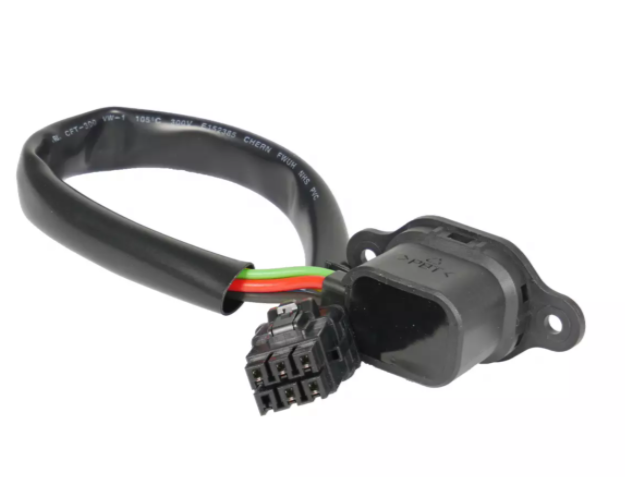

It doesn't seem possible to purchase replacement charge ports for the BT-E8010/14/16/18/20. The only ones I've read about which have been repaired are where people have bought the EW-CP100, opened up the battery, cut the EW-CP100 cables and soldered them to the original ribbon cable. You then have to enlarge the hole in the battery case to fit the EW-CP100 port where the original charge port was mounted and glue it in place.
I always thought you could use the BTE80 (normally supplied with charger) to just plug into the bottom of the battery (bike connector) and use that to charge with the charger. Have one sitting in a box somewhere. Maybe the plug shape is different though to the downtube support plug/connections.

Thanks Zimmerframe…thank you for responding positively. Yes I had previously seen this equipment and wondered if it would be a fit? I think that’s the adapter the bike shop showed me but alas it won’t go anywhere near the charging port. I need the adapter but without the obvious plastic trim around it! That would do the job nicely…shame about the plastic trim. I’ve looked for an adapter without the trim…no joy. Alas when we have previously charged the original battery on the bike…ie in the summer….with the BT 8010 you actually use the same charging port which is on the side of the battery and has nothing to do with the battery connecting to the frame which is on the bottom.
Idea…if I bought the adapter…do you think the plastic frame could be removed easily?
13,805
20,497

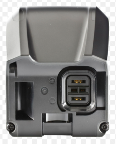

It wouldn't surprise me if the bike shop doesn't have a draw full of them from all the ones they've not given out with bikes as they were unnecessary.
The plastic looks reasonably easy to remove. If that's a good idea or not is down to the individual and the circumstances !
Without the plastic you also run the risk of being able to insert the adapter into the battery the wrong way round, so you'd have to mark it clearly with coloured tape for instance to make sure it was the correct way up.
The longer pin on the BTE80 is the negative :
Which corresponds with the bottom connector on the BT-E8010 :
You would also have to be VERY careful inserting the adapter as these ports are also known for failing.
It maybe easier just to repair the plastic on the original charging ports, unless the connections are also damaged.

Right…think I get it now. You use the adapter to charge via the bottom connector where it sits on the bike. Well, the man in the bike shop did say the adapter wouldn't fit because of the plastic casing on the adapter which is not meant to be used on the BTE8010. Can’t remember if he tried to put the adapter into the original port or the bottom bike connector. Think I was so shocked when he said it was broken! This is the charger end:

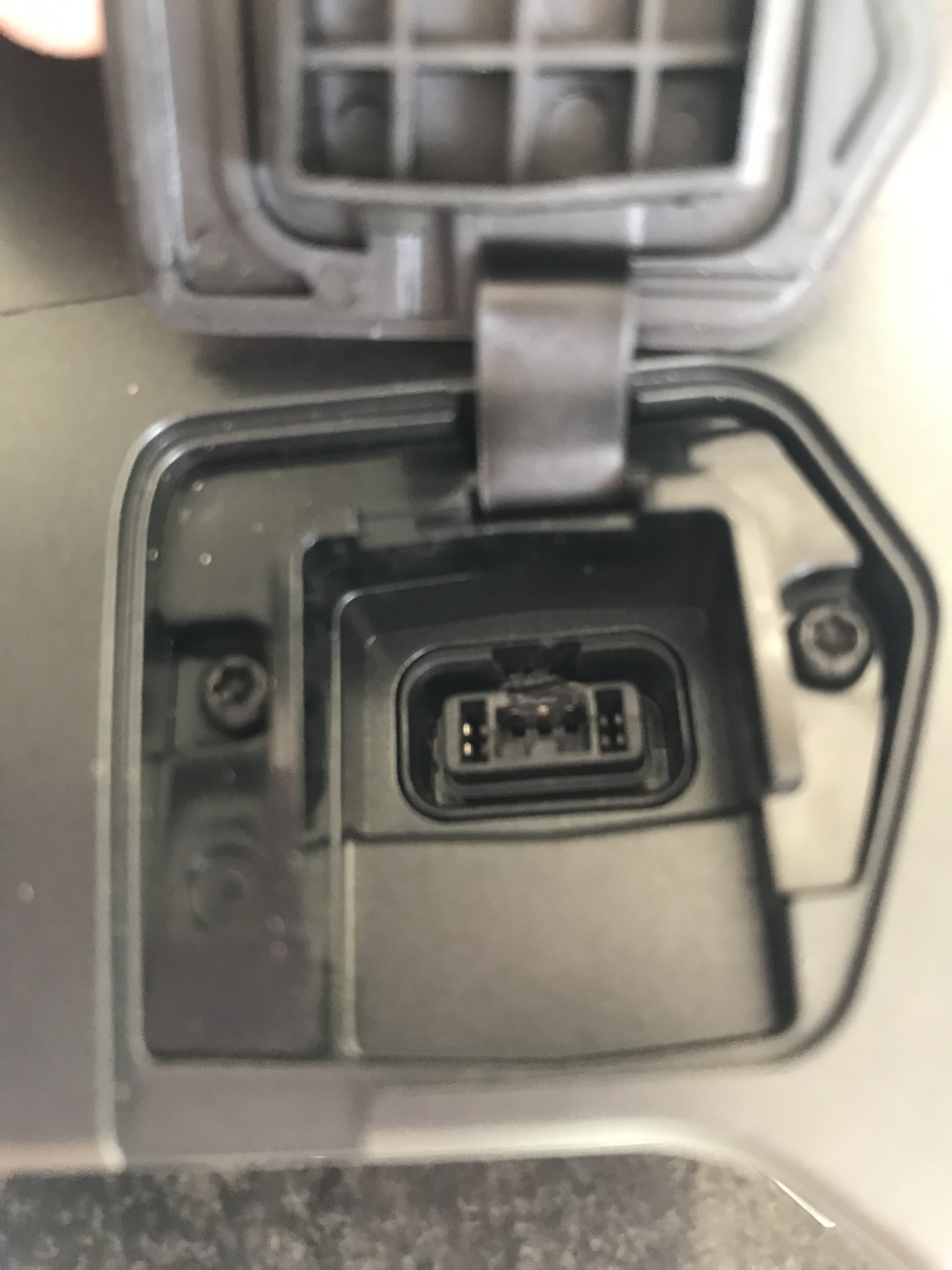

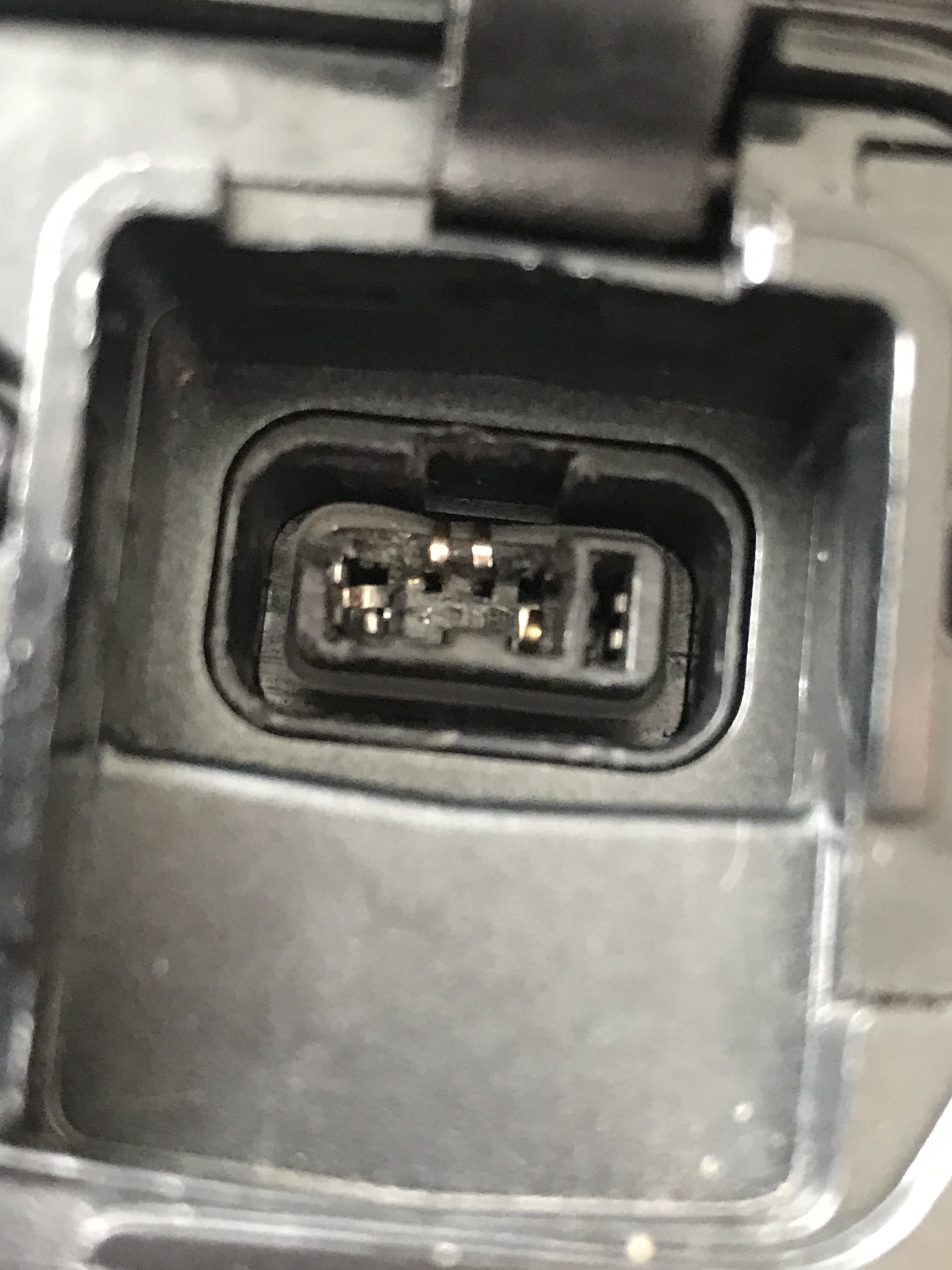

This is the original battery and you can see the plastic around the port itself is broken. There may be a damaged pin also. The newer battery, however, only has about 1/4 inch of the plastic missing and no damage that I can see to the pins! No one has mentioned mending the plastic which I agree seems the obvious solution….but only if it can be repaired! No idea how to go about finding out or who to ask if this possible😗😗

Somebody has already messed with this. See the two zip-tie loops at the back?

No one I know of has messed with this…we took it up to the bike shop when we realised it was broken…man had a look and said the plastic was broken so you wouldn’t get a firm connection. Not sure what a zip-tie loop is? I’ve added what I hope is a better picture
