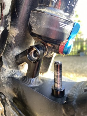

Whilst cleaning the bike (Jam 6.8)
IMG_8015.JPG and thinking about the slipping hub (second time, posted separately) how I fix or do I take to shop? I noticed a bolt loose. Started to tighten and just kept spinning. Then. found that it had sheared off??
After getting over the annoyance and thinking that'll be an hour on the web finding a new one, I suddenly thought how do I get the thread part out.... Ooooh, bugger bugger.
Any thoughts - here do I buy a new bolt and how the chuff do I get the thread part out??

I ve done a couple of them bolts in the past.
Found the best way to prevent this is to regulary regrease the linkage bolts and use a torque wrench to ensure the correct tightness. Never had another one snap.
I never use loctite on these bolts as you would then struggle to get the snapped bit out if it ever snapped again and i've never had one come loose without loctite.
Got new bolts from my LBS (Focus Dealer).
I got the old snapped off threaded bit out by making a small slot in the bolt with a dremmel then used a flat screwdriver to screw the old bit out.
With the new bolt i have sawn a slot in the end off the bolt so if it does ever snap i can just screw it out.

I’m guessing it’s a 2020 Bosch driven Jam 6.8, if so it’s the same as mine, now I’ll have to check my shock bolts for similar. If it was me first port of call would be the dealer for a warranty issue because we seem to get a lot of “little” issues on these bikes. I’m sure the procedure would be to drill the remainder out using a very small drill bit.

The exact same thing happened to me after only 735 miles. I took it to Rutland Cycling and they dealt with it under warranty. They had to order the bolt and it was going to take a while so they robbed a bolt off a bike they had in stock. ( :) ) They ordered a few bolts and sent me a spare bolt in case there was a next time. I removed the shock recently (2165 miles) for a service and the upper and lower shock mounting bolts were in perfect condition. Loctite Blue the threads when replacing.

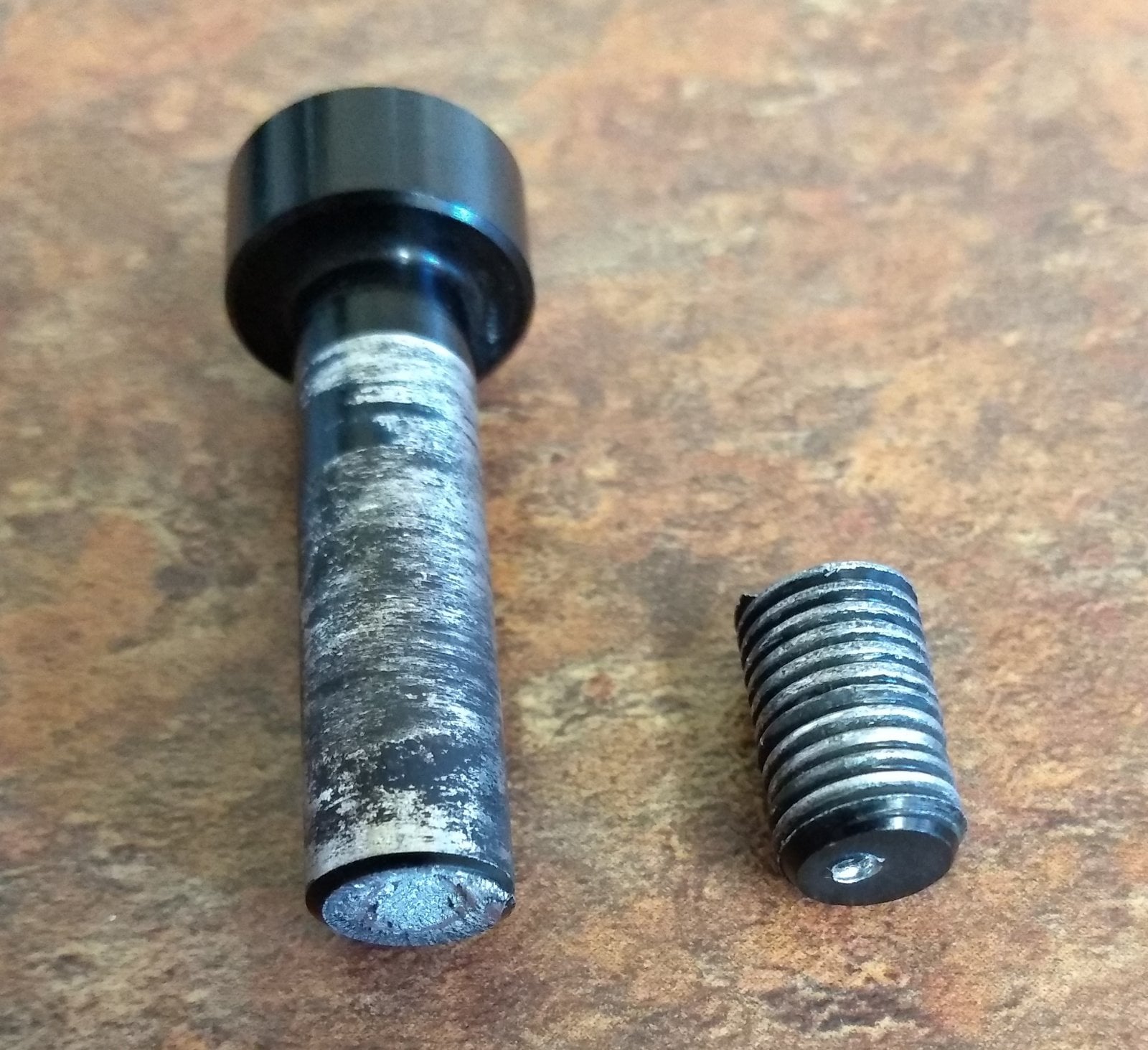

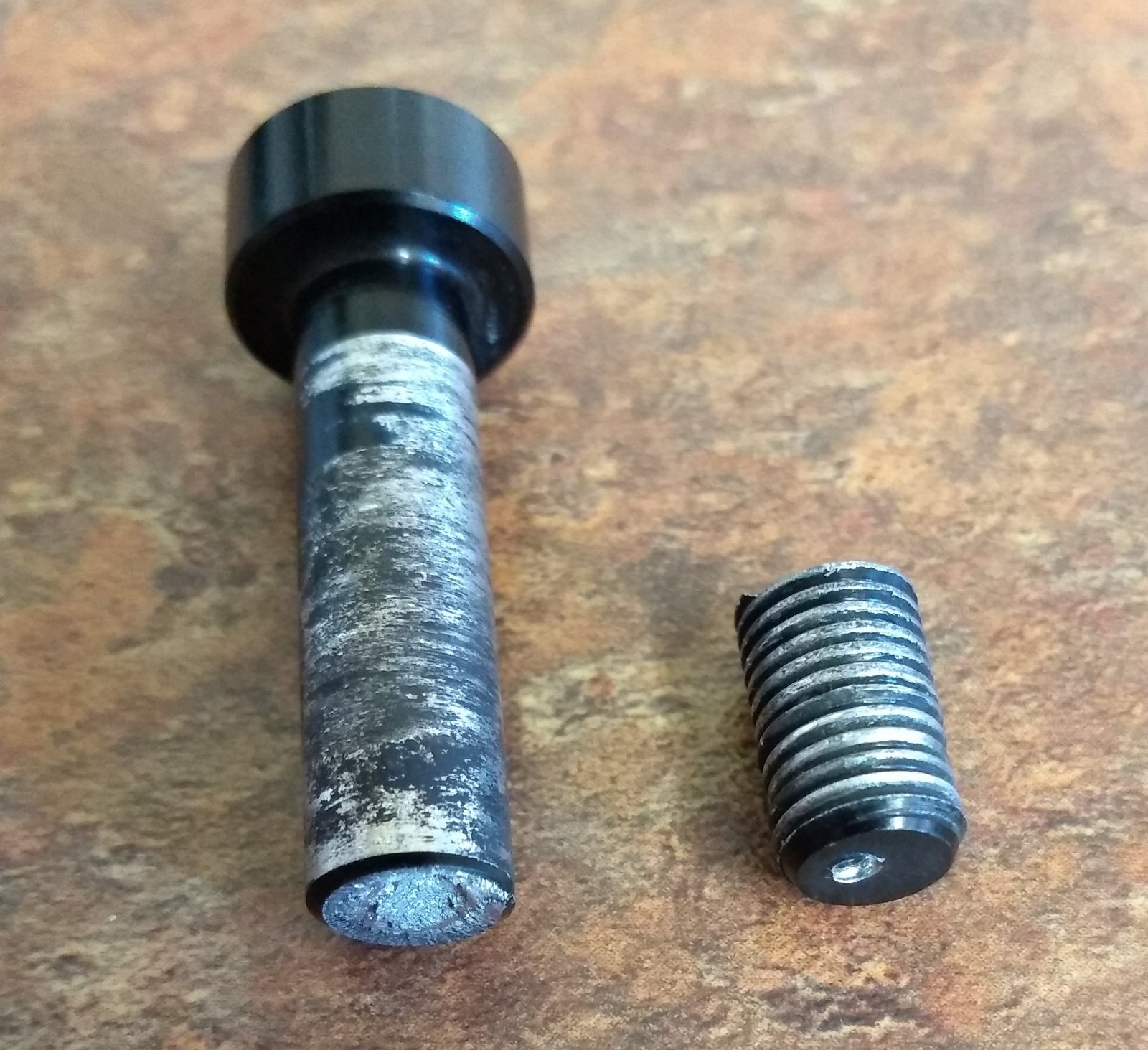

Nope. The bolt came loose and the shear point moved from the smooth round part to the spiky threaded part, which is where it sheared. The damage you can see on the smooth part is because the bolt was unsecured and the shock was actually hitting it. My bolt looked exactly the same as the OP's. see below
The dimple you can see in the end of the threaded section is where the drill bit started before it unwound the stub.
So if there's a bright side, it should always be easy to get the broken threaded section out ! Maybe someone needs to invent little bolt yellow plastic caps like on lorry wheel nuts, so you can see if your bolts are coming loose ! :)
