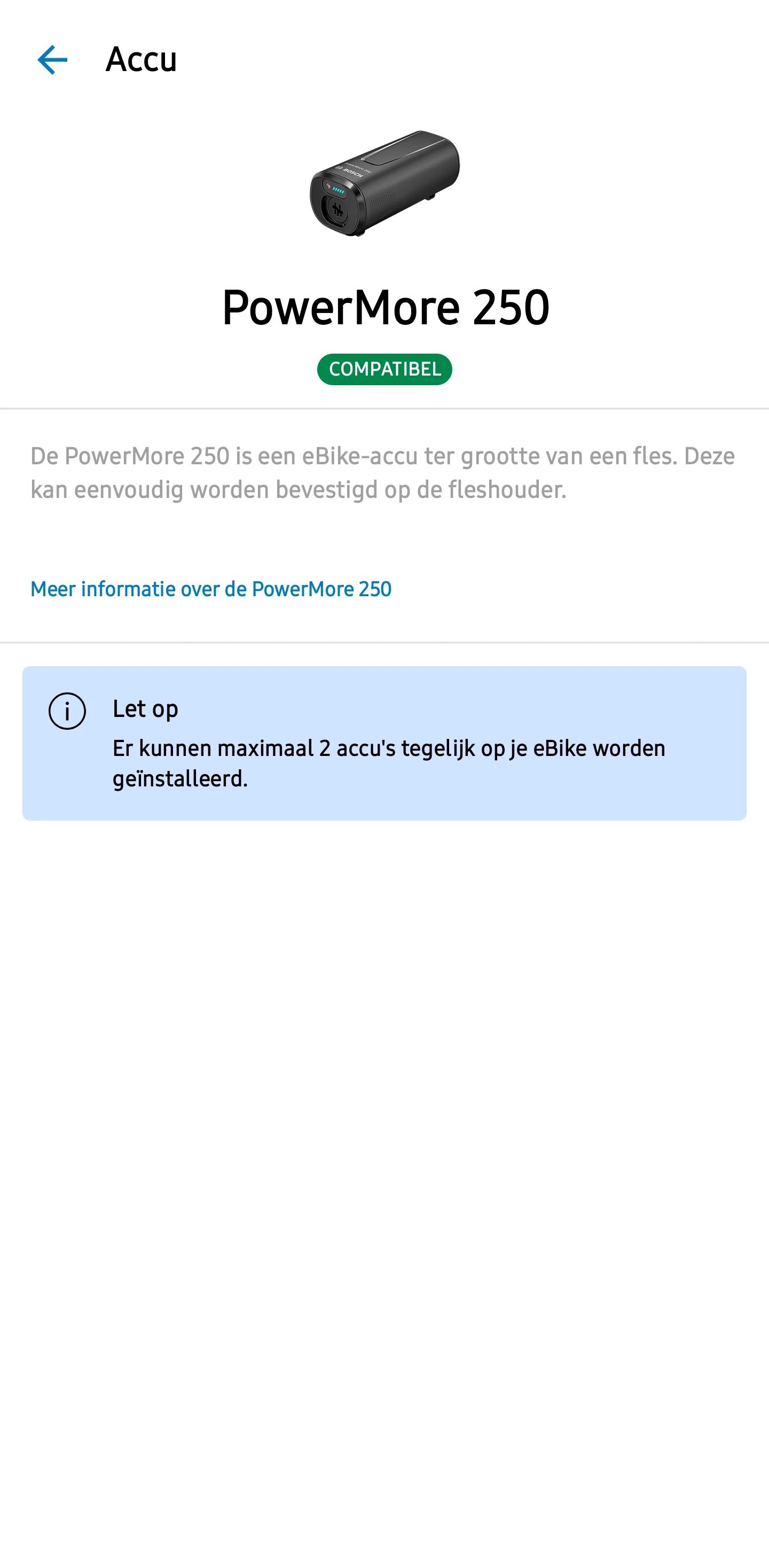

Bosch Power More 250W
PowerMore works alone, ONLY if it is activated in ebike configuration. You can verify it in Kiox or Cell Bosch Flow APP, you go to My Bike-Components-Battery and Powermore should be listed as enabled. If it is not there, it won't work
It has to be enabled.

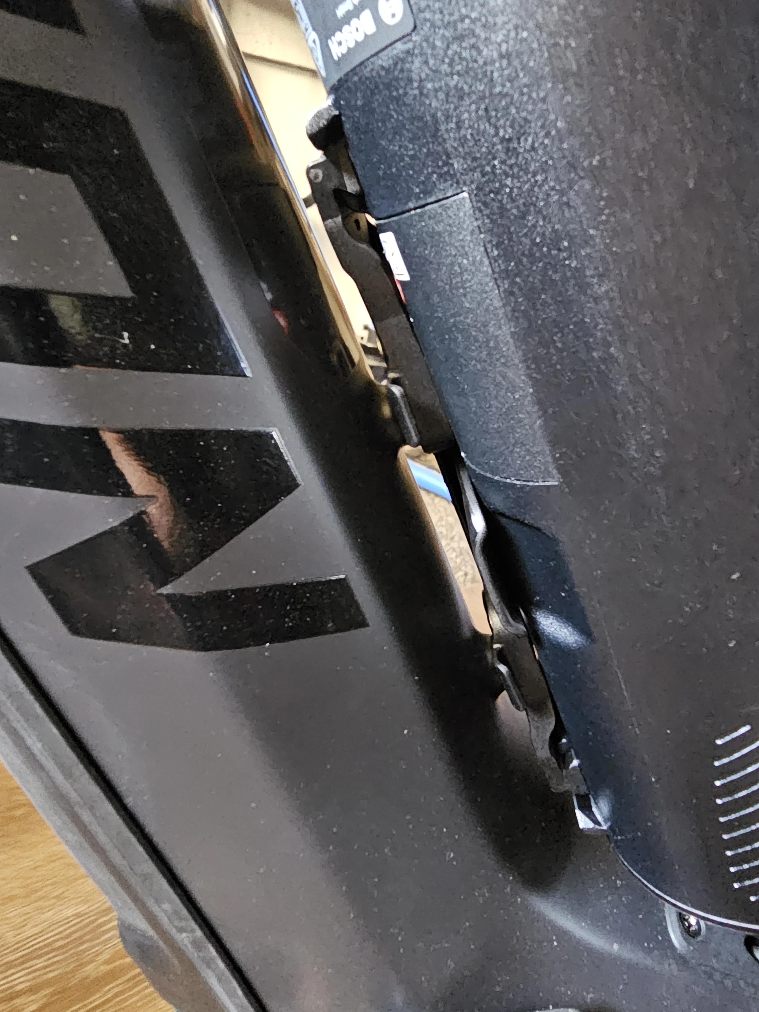

Another issue is that the Powermore 250 doesn’t fit inside the frame. The Deft comes with the high-performance Fox Float X2 Factory rear shock, which takes up some space. Maybe the Orbea adapter (mentioned above) could solve this problem.

Here is my experience with Bosch smart system and second battery;
August last year bought a new bike with smart system, assembled mid 2022. Also ordered a powermore, a 400wh battery and a short connecting cable to the bike charging port.
After update the bike system with Bosch Flow app I tried to connect the powermore battery.
Bosch gave me a critical error because powermore was not enabled. So I tried the 400wh battery, another critical error since the additional battery firmware was not updated.
The solution was to remove main battery, connect additional 400wh battery again and update its firmware with flow app.
After that install main battery again and, miracle, all green. The system recognized and work ok with both batteries.
So, powermore needs to be enabled but second battery does not.
Back to the bike Dealer, he could not enable powermore with Bosch Dealer software.
But using the Bosh software he started a "Bill" to the bike local distributer that sent him a code and finally the Dealer was able to fix the powermore.
After an update to the powermore firmware all was finally working.

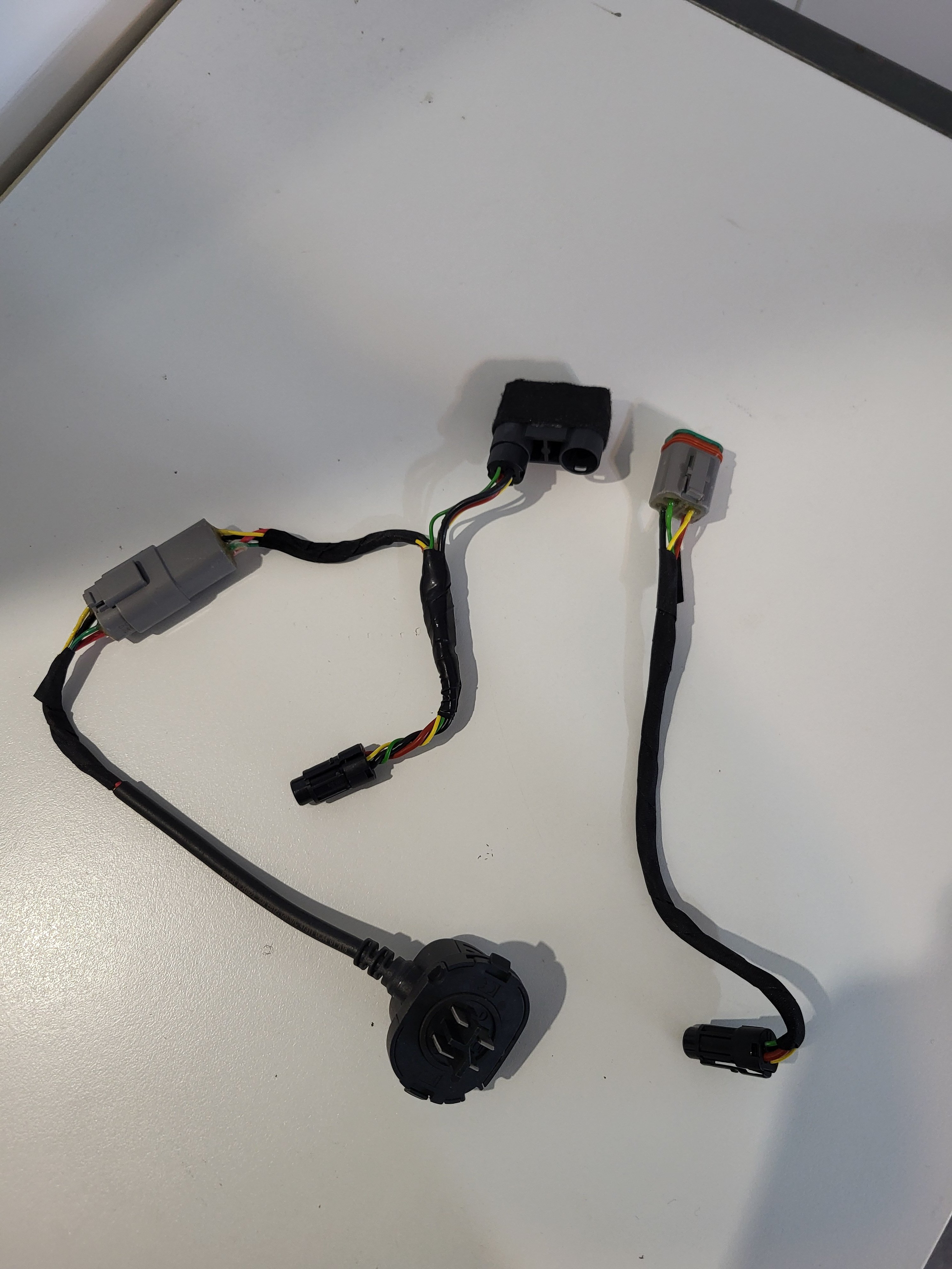

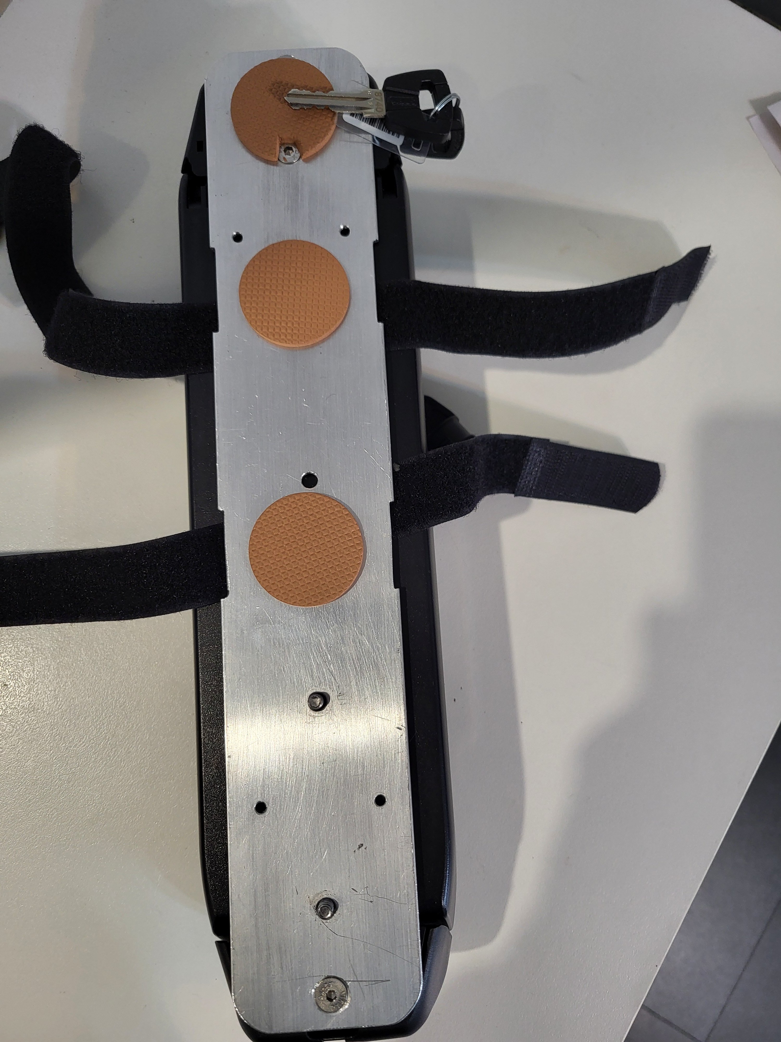

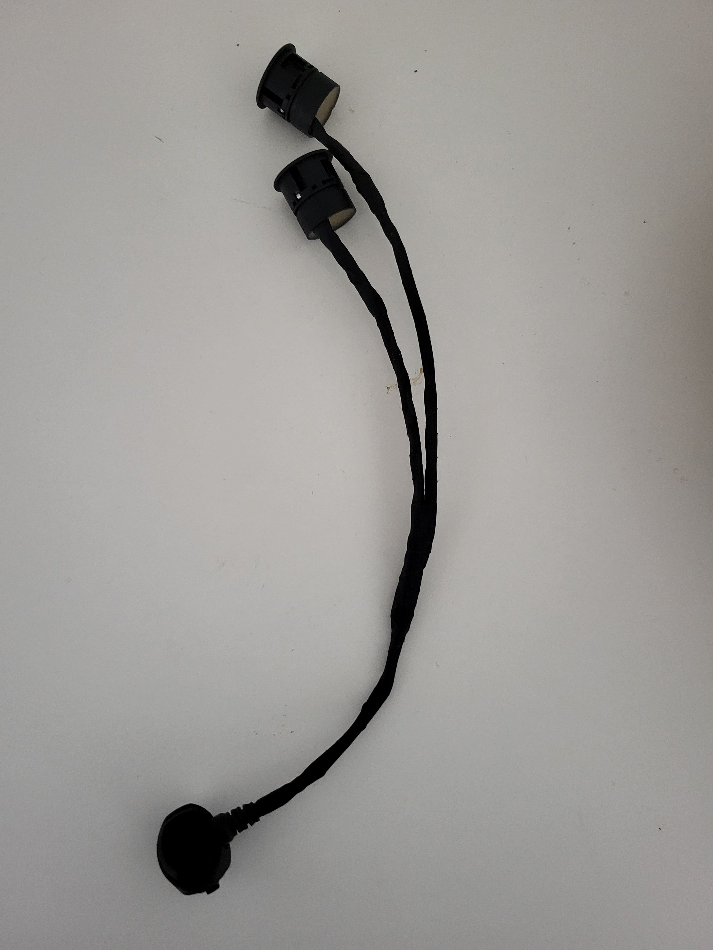

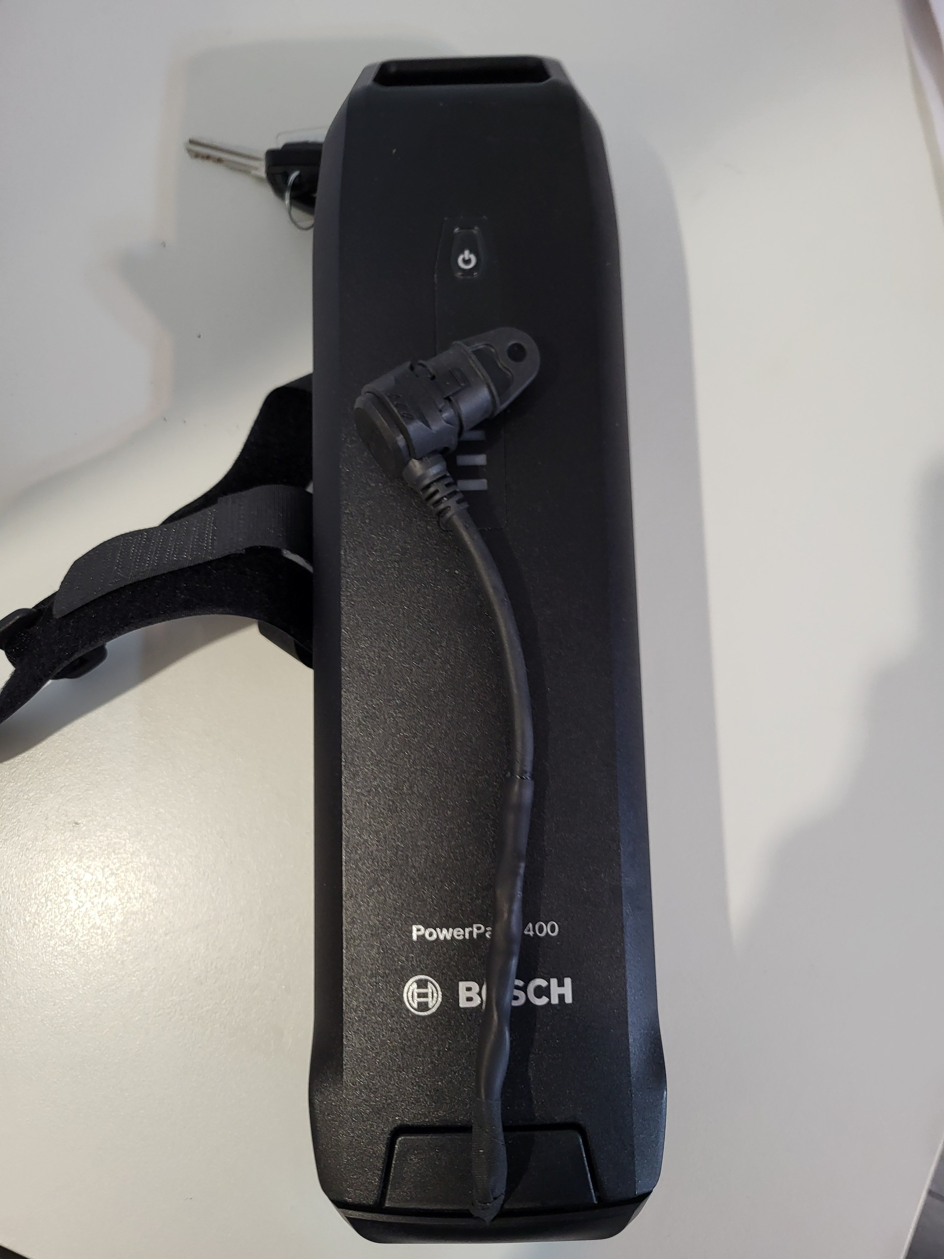

Hi, how did you connect and attached second battery? Also did you try to connect compacttube 400wh with powermore cable? I want to add to my 2022 mondraker second battery but still not sure what is the best way to do it.
The problem with compact 400wh is to attache it to the frame.
Powermore cable is not compatible with it, so If you use bosch supports, you need to use battery cables.
I made 2 cables ( 2 different solutions ) and an aluminum support for the standard bottles support.
The easiest cable can be made using one battery cable and a powermore cable.
Cut them to the size and crimp or solder the cables.
You will have a cable with a battery connector and a powermore connector, the small one that goes to the frame charging port.
Now, since this mixes two different cables you have to cross the yellow and green cables.
Red to red, black to black, green to yellow and yellow to green.
The second solution is more complicated because it involves non bosch connectors but it allows to connect the second battery directly to the motor, avoiding long cables and, additionally, charge the two batteries at the same time.
And you can also use it for the powermore.
It is also possible to make a parallel cable to charge 2 batteries at the same time.
Just remember to cross yellow and green cables when you use different bosch connectors.

View attachment 156510 View attachment 156511 View attachment 156512 View attachment 156513

Anyone else has the powermore mount not so close to the frame?
my frame has raised bottle cage mounts

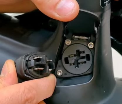

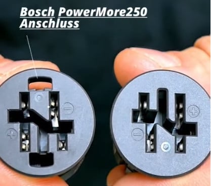

I just bough my Cannondale with Bosch 4Gen Smart System, according Serial Number label, it was manufactured on May 22th 2023, so I was checking if the new Power More Extender is compatible with it, and it isn't. I'd say Bosch is shooting himself in the foot, there is a huge market of older ebikes willing to use a Bosch Extender but they don't provide it.
Power More has a new plug that will not match older Charge Sockets, probably 2024 ebikes will have "Bosch 4Gen Release 2", and they will include the new socket.
View attachment 130743View attachment 130744
I found it in this video:

Change the charging port and you are done. I do this with my Trek.
