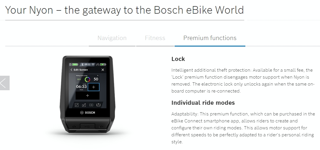

How do you tune the power used in each mode without a Kiox etc?
I think tuning is possible (only) with the new Nyon.
Before buying my first EMTB I thought that tuning is mandatory feature in bike. After my very first 400km and riding mainly with EMTB-mode I don't have any real reason or problem that I would fix by tuning. Maybe later on?
Had a Trance e+ prior to my new Rail and that needed tuning ability but this Bosch only needs emtb, job done, over and out! ?

It’s just a shame BOSCH decide what we need and don’t need instead of letting us chose ourselves, and if we want to tweak any settings, then I have to pay £500 for NYON and then subscribe to change to tweak each mode.
I don’t see why the KIOX can’t do it!

My bike is too heavy for ECO, TOUR is nice, and TURBO is amazing but not good for the battery, so SPORT was the perfect mode for me when climbing uphill.
I could say that these tuning & tweaking limitations have been very well known at the time you have made an agreement to go for Bosch closed E-bike ecosystem.
It's a bit hard to follow what you really need. You need more power, the TOUR is nice but EMTB is not. EMTB is bad because pressure but SPORT is good because pressure. Would it be easier to just not update your bike?
What do you actually need for your 23kg trekking/mountain bike?
* In the case of the Performance Line CX, eMTB mode can replace Sport mode. It can be activated/ deactivated by the bicycle manufacturer and the specialist dealer.
