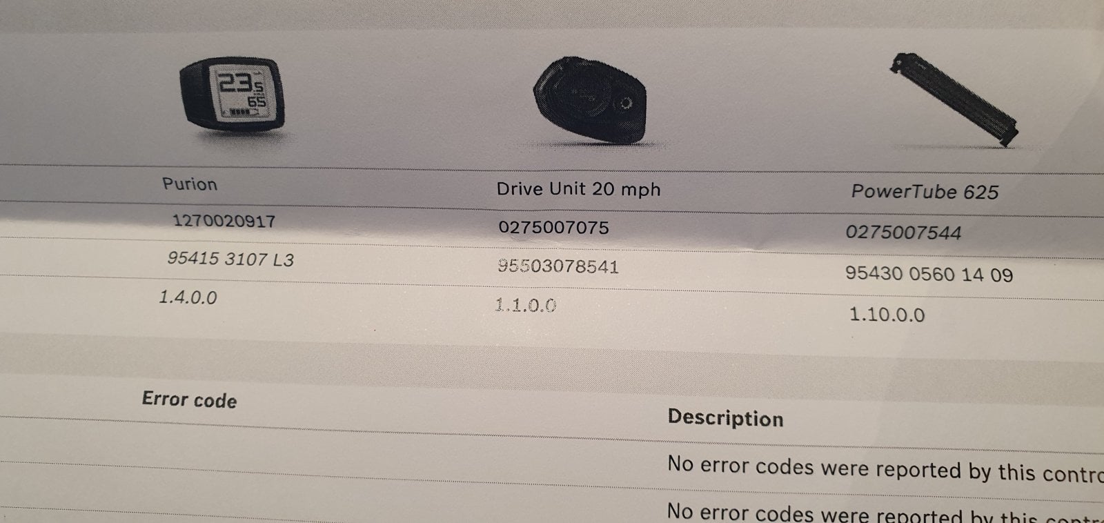

Yep correct, just had mine done today and got a printout checklist.
Purion will also display same, power off and press pwr up, down and power on buttons together and display will cycle through firmware numbers.

Just had mine updated today, transmission ratio is 3.45 max, 0.9 min.
Yes, I guess this is just the transmission ratio of the cassette to crank as some others wrote.... I was afraid it had something to do with engine torque/power
