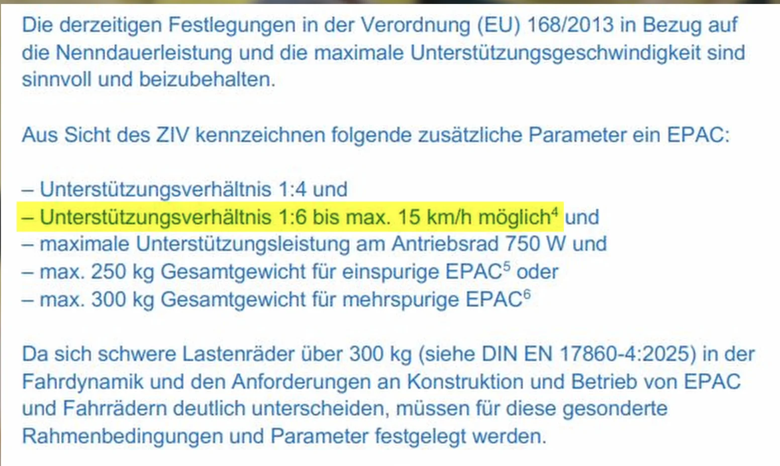

translation from google AI:
The current provisions in Regulation (EU) 168/2013 regarding continuous rated power and maximum assistance speed are appropriate and should be maintained.
From the perspective of the ZIV (Two-Wheeler Industry Association), the following additional parameters characterize an EPAC:
  • Assistance ratio of 1:4 and
  • Assistance ratio of 1:6 possible up to max. 15 km/h and
  • Maximum assistance power at the drive wheel of 750 W and
  • Max. 250 kg total weight for single-track EPACs or
  • Max. 300 kg total weight for multi-track EPACs
Since heavy cargo bikes over 300 kg (see DIN EN 17860-4:2025) differ significantly in terms of driving dynamics and the requirements for construction and operation of EPACs and bicycles, separate framework conditions and parameters must be established for these.

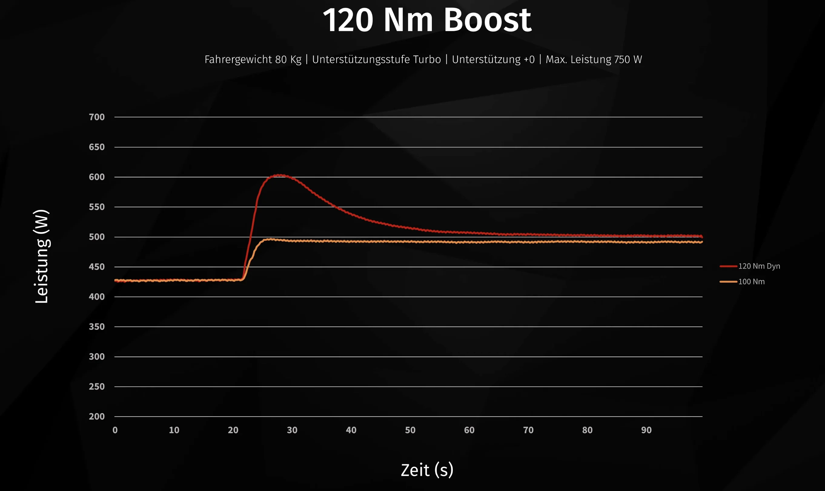

Not a continous 120Nm even if you maintain low cadence. I posted a graph from their video, showing its just a small bump in power and back down to 100Nm levels.

The input in 60 RPM and 100W, at 20 seconds they bump the input to 200W and you can see the motor respond with a temporary boost in power as compared to the prior 100 Nm update.

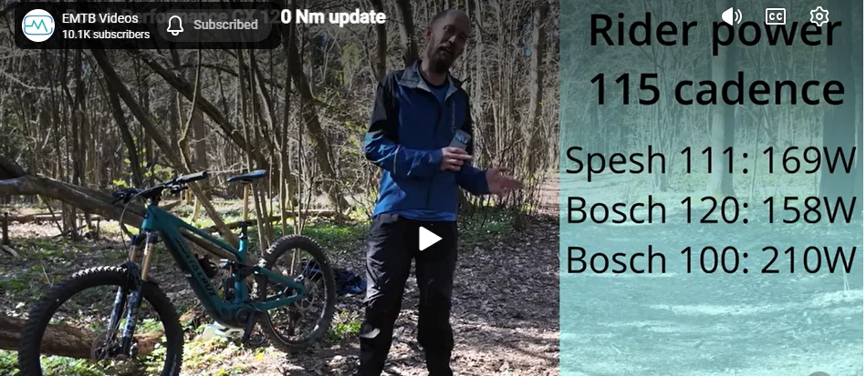

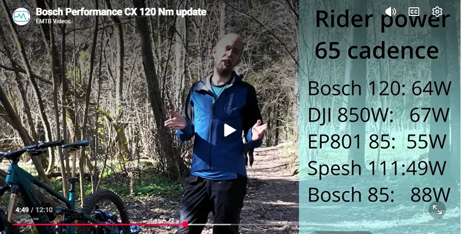

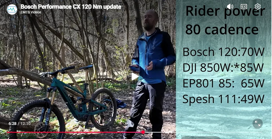

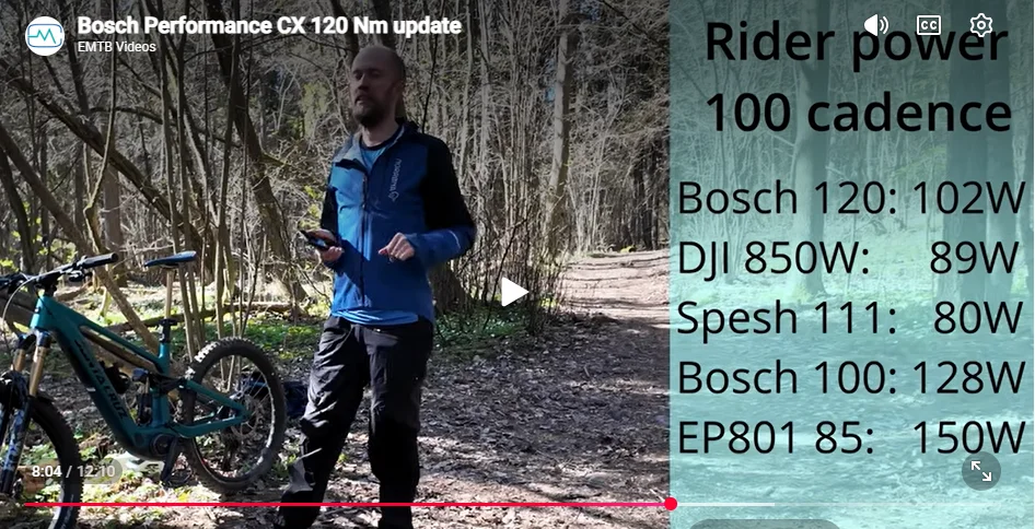

I grabbed these screenshots from Knut's video above as I thought they were interesting as they have normalized the climbing times and cadences, then they used power pedals to see how much rider input it takes to accomplish the more or less equal times (they were all within about 3 seconds, hard to get it exact). He didn't have a test for the Avinox at 115 RPMS, but who the heck spins that fast anyways!
The point being that it really takes some significant cadence before there is a huge difference. Interesting to note that the Shimano is grunty!
*The Avinox input watts were with the M1 at its initial power level of 850w. I don't know if the M2s only delivers its extra power at high RPMS, or does it do it everywhere?

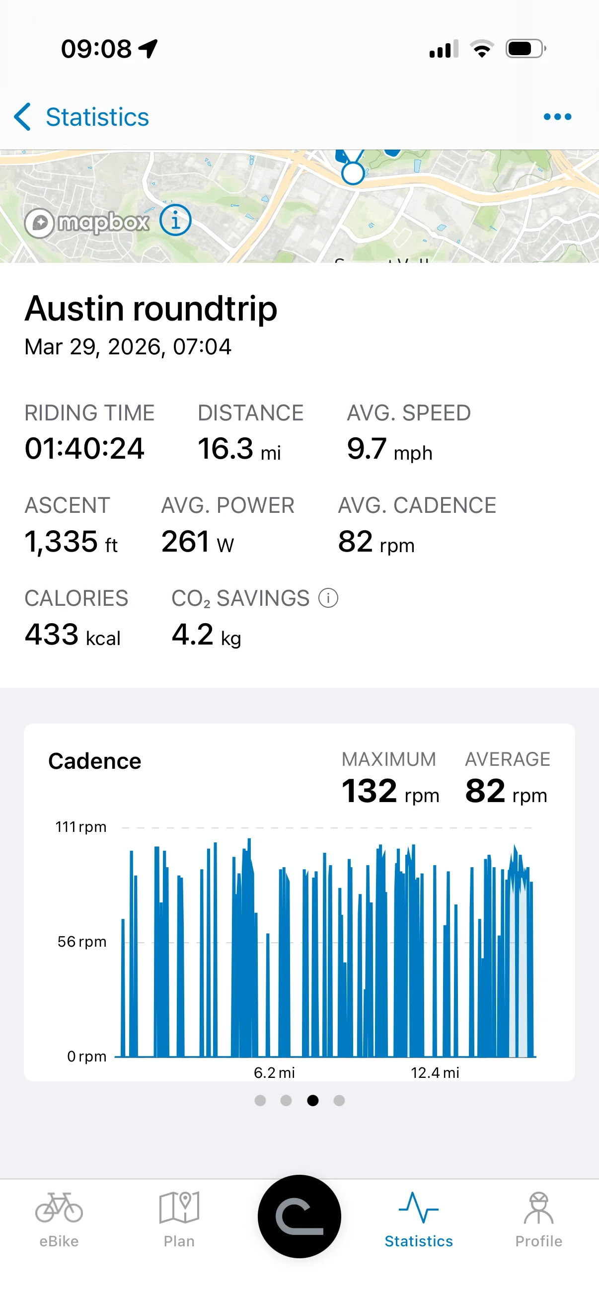

20-45 is extremely slow. Looks like my GB rides have lower averages than south side, probably due to technical sections and not pedaling. My average is still 80 and it looks like I never pedal below 60View attachment 183571
Matt, you're a proper biker though and ride your acoustic tons. But you averaged 82 rpm. At 82 rpm the Bosch 120NM takes less rider pedal input power than the Avinox 850 motor does at the same cadence. At a cadence of 100 rpm, the Bosch 120 needs 10 more rider input watts to achieve the same time as the Avinox 850. So, it's quite a competitive power level with what was considered an absurd amount of power just 1 month ago.

This one is interesting to me.
A few pages back I mentioned that Bosch was pretty conservative with the 750w limit, only testing about 700w. In the chart above I notice 2 things:
1) I think that a LOT more people spend time in that 20-45 cadence range than they care to admit, yours truly included. So there is a 'grunt' difference that will be felt. Think about when you come out of a turn and pedal up something steep, you rarely are spinning legs really fast but instead are more likely to stand and mash.
I’ve seen people mention cadences of 60-90 and that seems REALLY high to me. Not saying it isn’t possible but not many people I know ride like that. 30-60 seems more likely.
Is there a way to see cadence in the Flow app? I’d be curious what I really average at.
Edit:
And I immediately realize I was WAY off. After seeing some screenshot above I went into my flow app and looked at my last few rides. Lowest average was high 70’s and the others were 83 and 84. I’m genuinely shocked.

This bill modifies the definitions and regulations surrounding electric bicycles, or e-bikes, in California. It lowers the speed at which Class 1 and Class 2 e-bikes must cease providing assistance from 20 miles per hour to 16 miles per hour, though e-bikes manufactured before January 1, 2027, that previously met the requirements will retain their classification. The bill also introduces a new category for "cargo electric bicycles," which are designed for carrying goods or passengers and can be equipped with a motor up to 750 watts of continuous power. Furthermore, it prohibits manufacturers and retailers from selling or advertising e-bikes with motors exceeding 750 watts of peak power, and specifically limits Class 1 and Class 2 e-bikes to 250 watts of continuous power and a 16 mph assistance speed. Violations of these manufacturer and retailer provisions will result in civil penalties, not criminal charges. The bill also raises the age restriction for operating any e-bike with a motor exceeding 250 watts of continuous power to 16 years old, and allows law enforcement to require completion of a safety course as a condition for releasing seized e-bikes operated by minors.
Basically class I must be less than 750W peak and assist <16 MPH (currently 20 MPH). Maybe Bosch is waiting to see how the market and government react before jump head first like Avinox.
