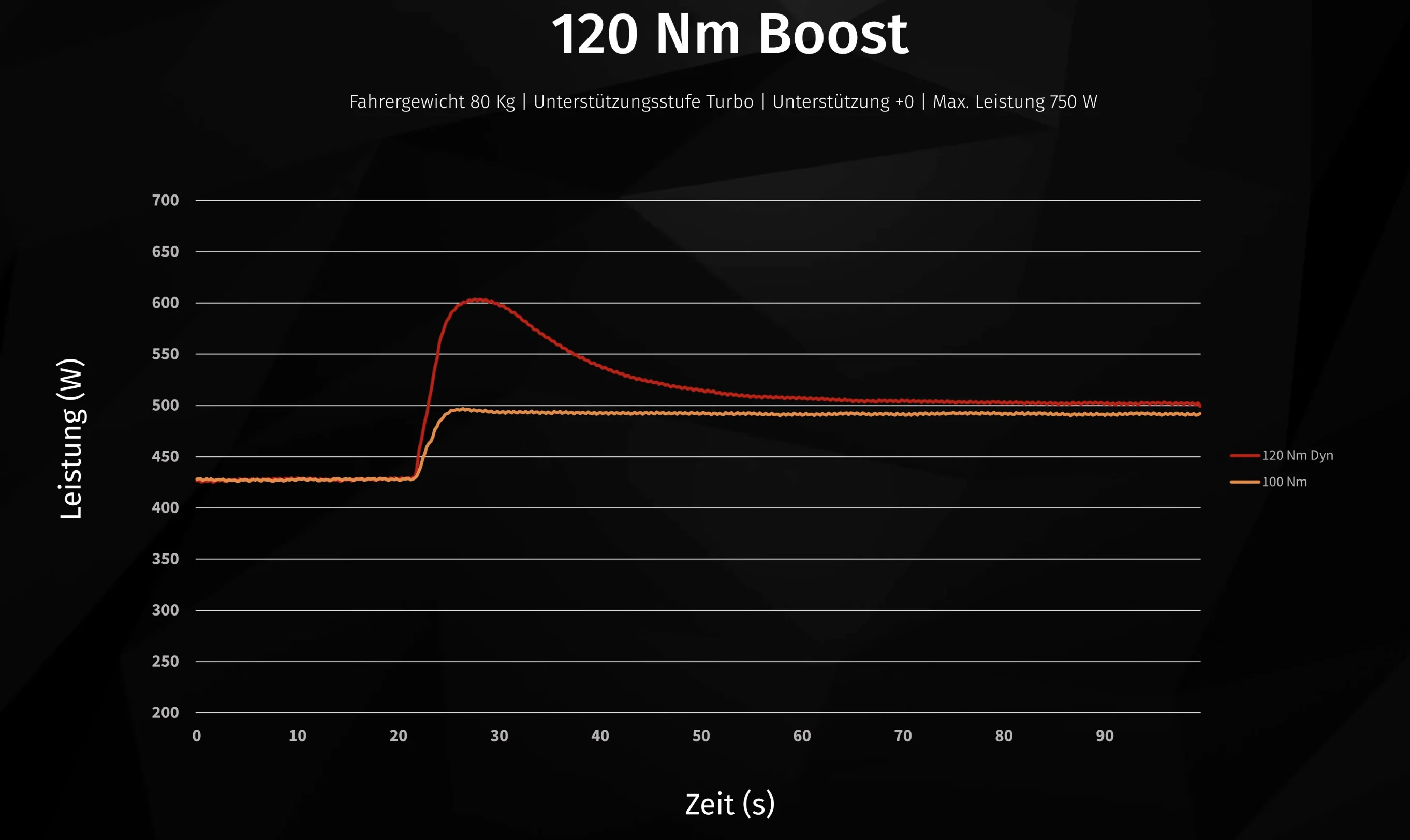

The video below really discusses the nuances of the power update... think of it as a short "boost" of power on the hardest part of your ride. Its not going to assist you up the entire hill, even at low cadence.
Overall, this is NOT a more powerful motor based on this update... it may feel like easier to achieve power (600% assist) and in limited cases you'll get a temporary 20 Nm boost.
The input in 60 RPM and 100W, at 20 seconds they bump the input to 200W and you can see the motor respond with a temporary boost in power as compared to the prior 100 Nm update.

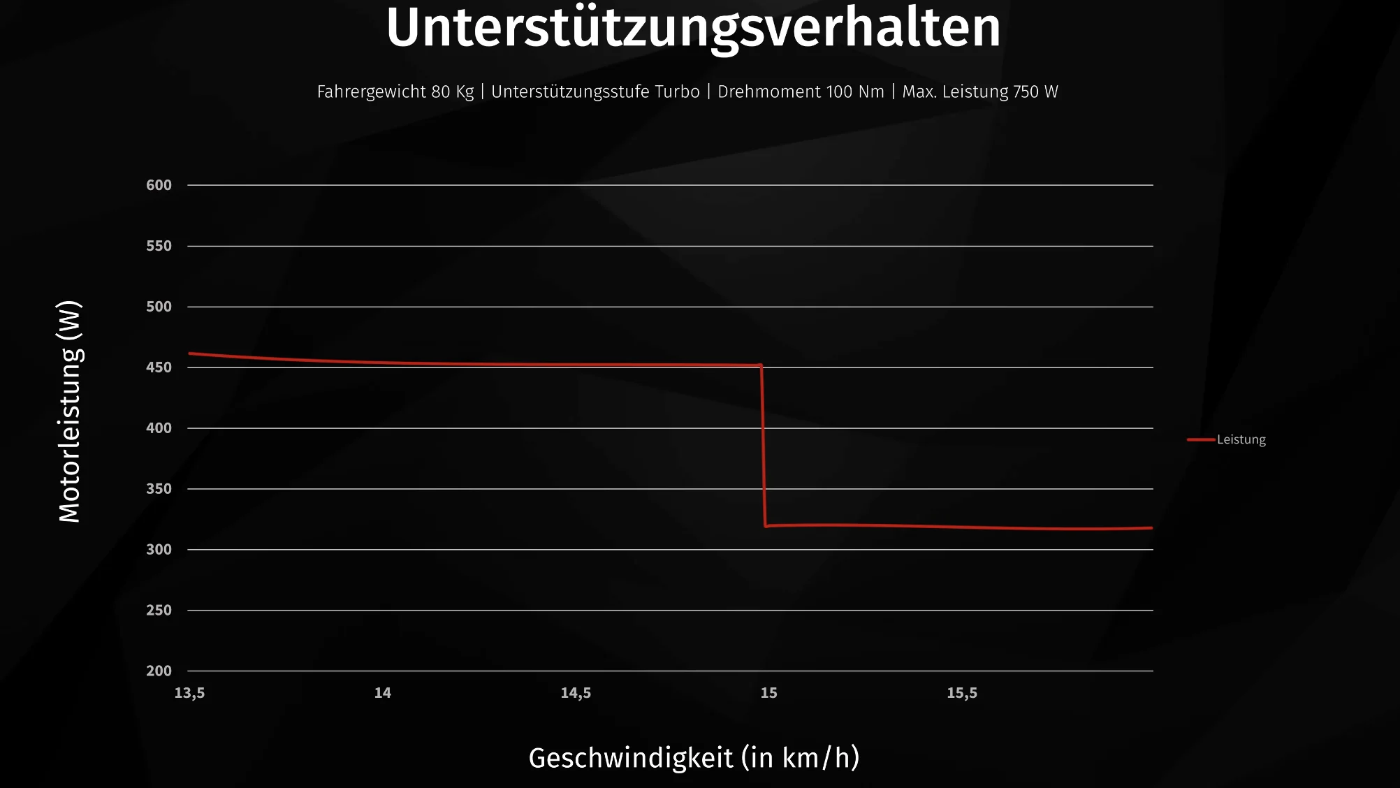

Here's a chart illustrating the 600% assist and cutout at 15 KPH. This may be an EU only restriction derived from ZVS (i.e. German bicycle industry), which Bosch CEO is member of. On Bosch US site, it notes 600% up to 20 MPH (32 KPH).
Velomotion states it quite abrupt as assist level drops right at 15 KPH and not smooth or gradual decay like the 120 boost.
WTF… up to 15 km/h and then it drops to 400%?! Sorry, but what a pointless load of nonsense. If Bosch doesn’t bring out a new, competitive system next year, that’s it. Most people look at the specs, and 1500 watts is simply double 750… and again — only up to 15 km/h?! This update is, and remains, a complete scam.

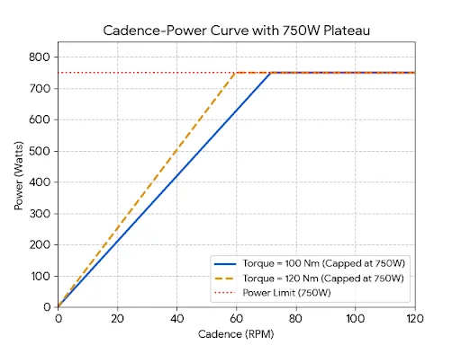

Something about that old formula, Power = Torque * RPM.
If they kept the high torque AND the rider was adding in high RPMs, they would blow past the 750 watt legal limit.
As a result, they can only offer the high torque at a low cadence.
