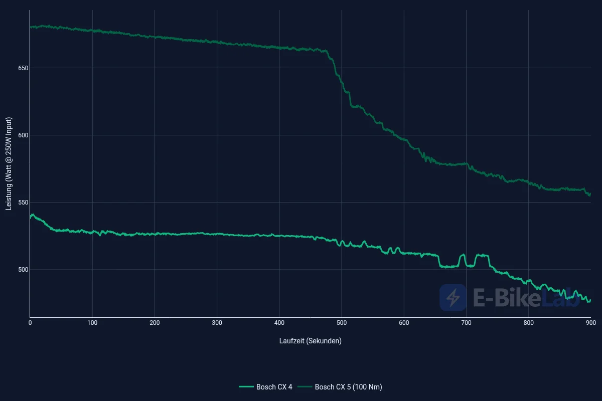

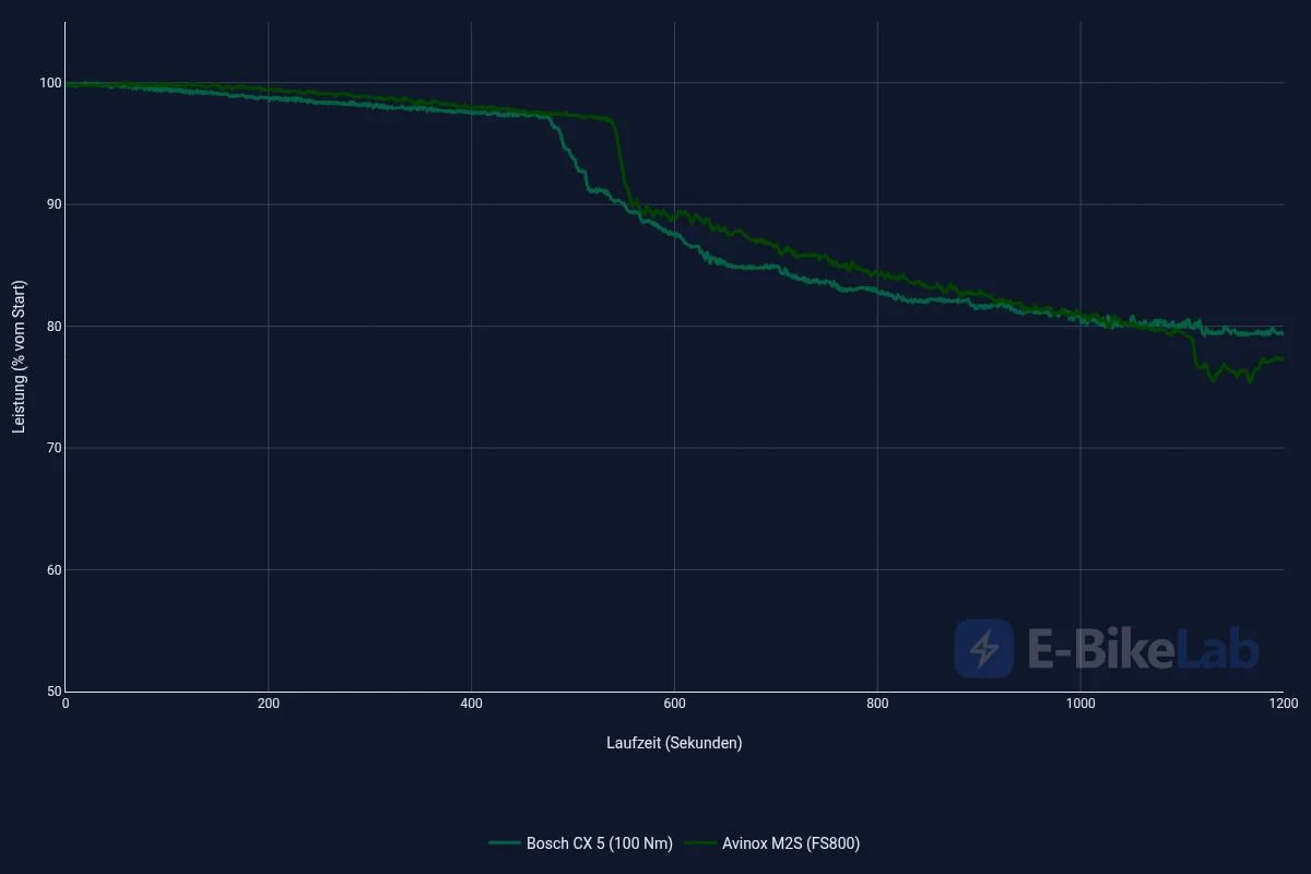

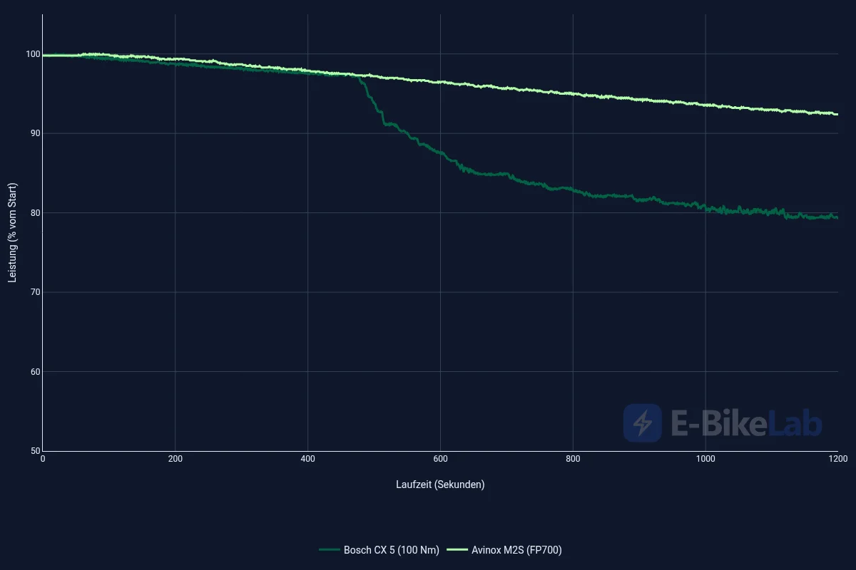

Just for the kicks...
Thermal behaviour comparing
CX5 vs M2S & FS700 battery - 20min --> CX5 derates (probably due to Batteries)
CX5 vs M2S & FS800 battery - 20min --> Very similar, may I say!
CX5 vs the "old" CX4 - 15min (funny how CX4 is more "linear")
Graphs and information from:
WWW.EBIKE-LABS.DE
Avinox M2S needs the special FS700 battery to show all GO

If the motor might deliver more torque, battery will have higher current draw, and will have a worse derate?
Meaning, in the 20min, the motor will reduce power quicker than maintaining current torque and power?
