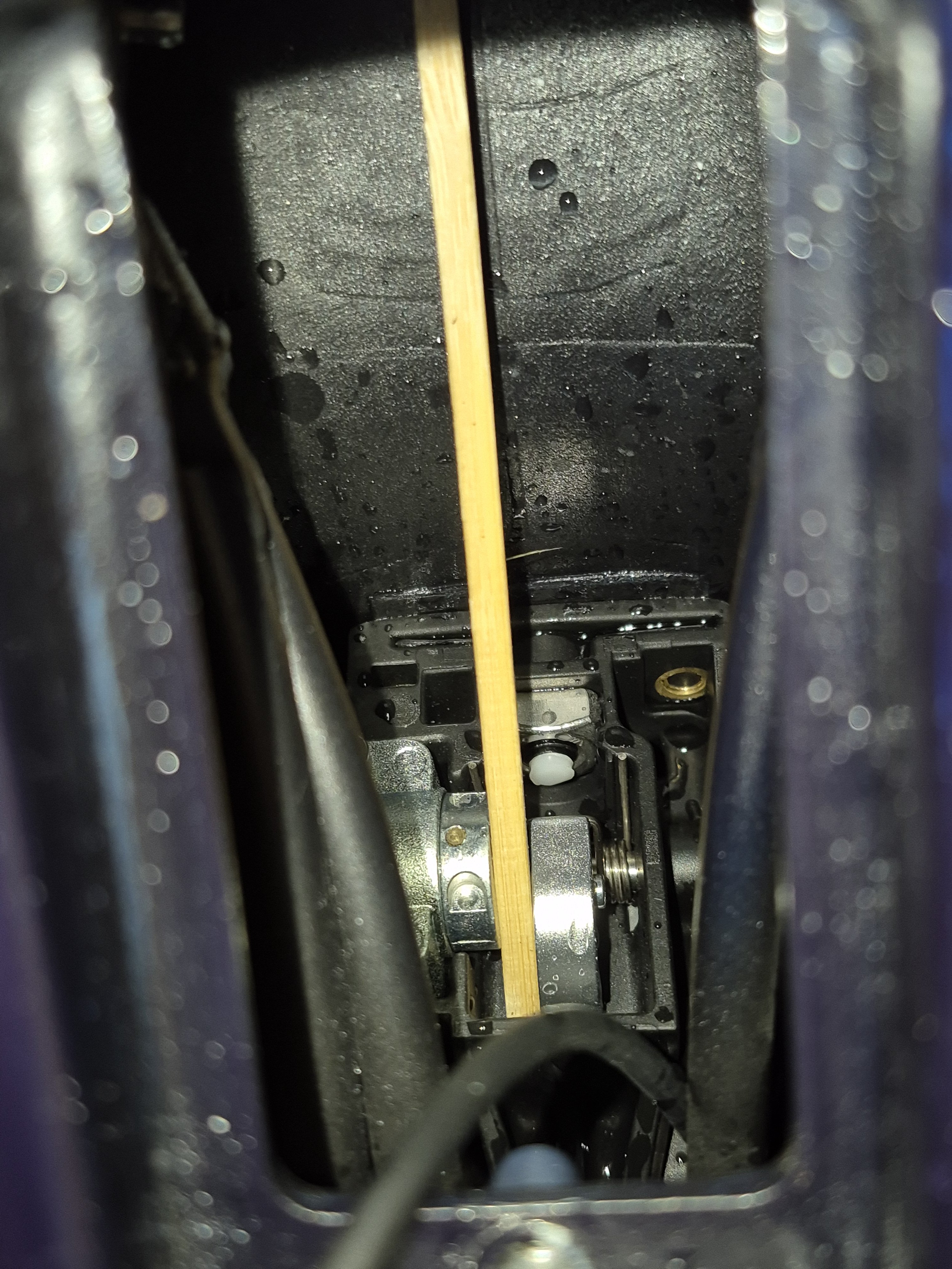

I have a trek gen5 and managed to pinpoint the rattle to the battery lock/release mechanism. It's very loose and rattles like hell. If the Vala has a smiliar one then this might be your culprit. It can be replaced witha n ABUS key, not sure if this will help so I'm just rolling with the rattle for now. It's not a big problem once you know what's rattling - at least in my case :D.
I have a trek gen 5 too and started to notice this rattle and tracked it down to the lock mechanism too.
I removed it this evening, it's straightforward to do.
Take battery out.
There are 4 screws with torx heads to be removed. Two are beside the mechanism under the downtime and two are down near the bottom bracket.
This will allow you to remove the mechanism and then will further screw to release it.
I removed the pin that the was the cause of the rattle on mine that holds the spring, put some thin tape around it and reassembled everything and rattle is gone.

Any more info on the specific part you taped? Pulled it all apart, there is the little latch cam with the spring, and then the pin that rotates it. Tape on that pin helped, or the main latch?

I can barely remember. I think it should be obvious when you shake the part when it's out where the rattle is coming from. I think I put the tape around the pin so it fitted more snuggly into the cam if that makes sense. Haven't had an issue since.

I can barely remember. I think it should be obvious when you shake the part when it's out where the rattle is coming from. I think I put the tape around the pin so it fitted more snuggly into the camera if that makes sense. Haven't had an issue since.

Gotcha - cheers. Size M you have to drop the whole motor to get that part out (did it yesterday) so just trying to make sure this is the last time i do it haha!

I've just over 1000miles on my trek rail with gen 5 motor. Bike had rattle when I got it new last summer. Quickly isolated the issue to the lock mechanism, took it out and fixed with some tape. Rattle free since. Those 1000miles have been rough with a heavy rider, not just cruising on tarmac.
I have 3k miles on my gen 5 cx equipped bullit, no rattles. I do have what might be a slipping sprag clutch... but zero rattles.
Yep you can take it out easily enough and wrap some tape around the barrel to sort it.
Did you have to drop the motor for this? I can tell my cam latch is rattling on the pin so I would like to remove it and give it a shot. Rail+ 9.7 gen 5 size large.
