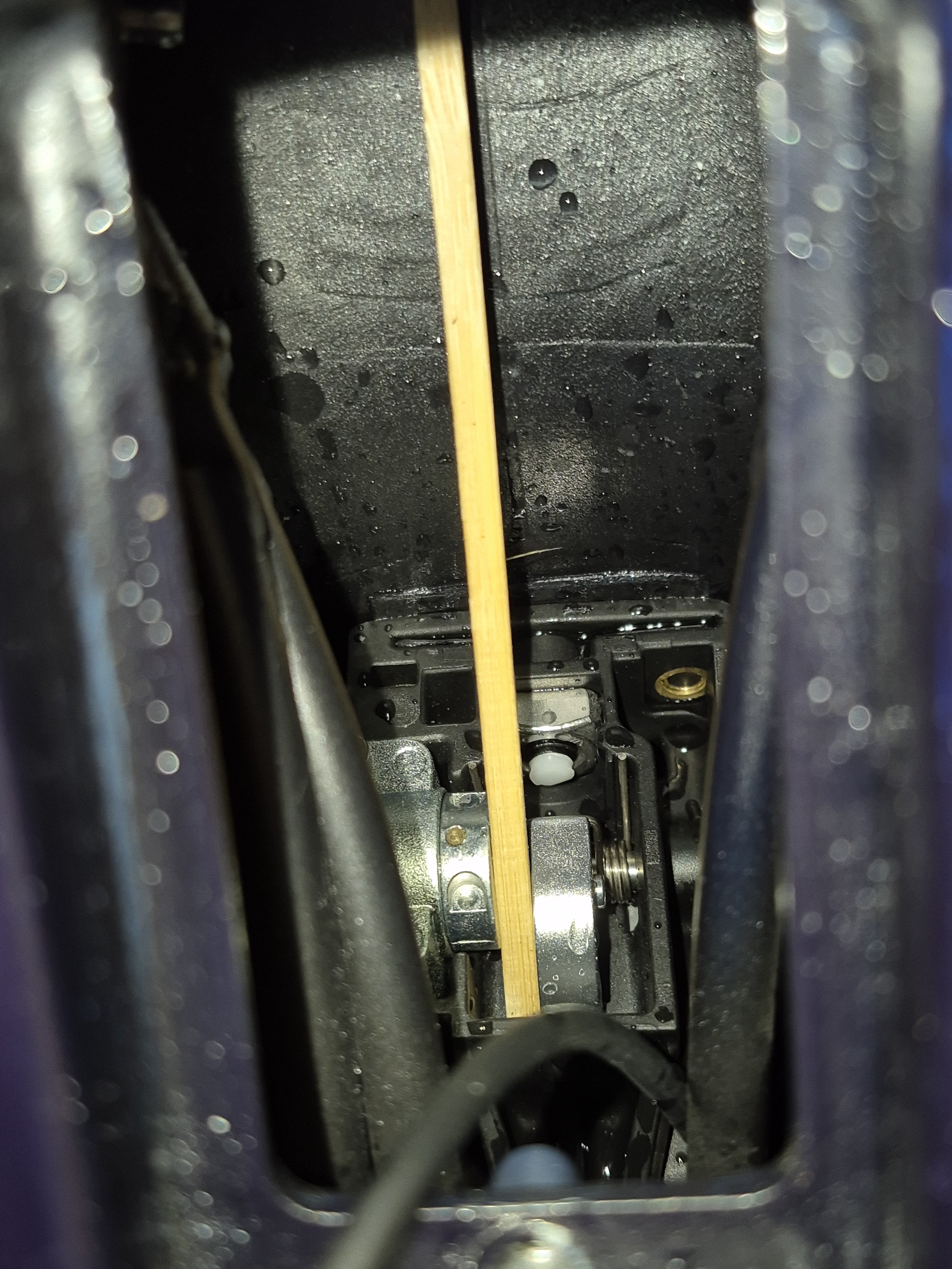

I have a trek gen5 and managed to pinpoint the rattle to the battery lock/release mechanism. It's very loose and rattles like hell. If the Vala has a smiliar one then this might be your culprit. It can be replaced witha n ABUS key, not sure if this will help so I'm just rolling with the rattle for now. It's not a big problem once you know what's rattling - at least in my case :D.
oh wow, thanks that's good info to have. Is that accesible by simply removing the motor cover? are you refering to Abus brand key? I'm confused 😅
//edit nevermind, I see bikes with removal batteries have those. mine doesn't :LOL:
This is the default mechanism on my Rail. It's very loose and was loose from day one. I can access it once I remove the battery, but can't find details on how to replace it - probably something available to Bosch service centers.
It uses a 6mm allen key to unlock and release the battery. I belive this mechanism can be replaced with and ABUS lock:
If this would fix the rattle I'd probaly go for it.

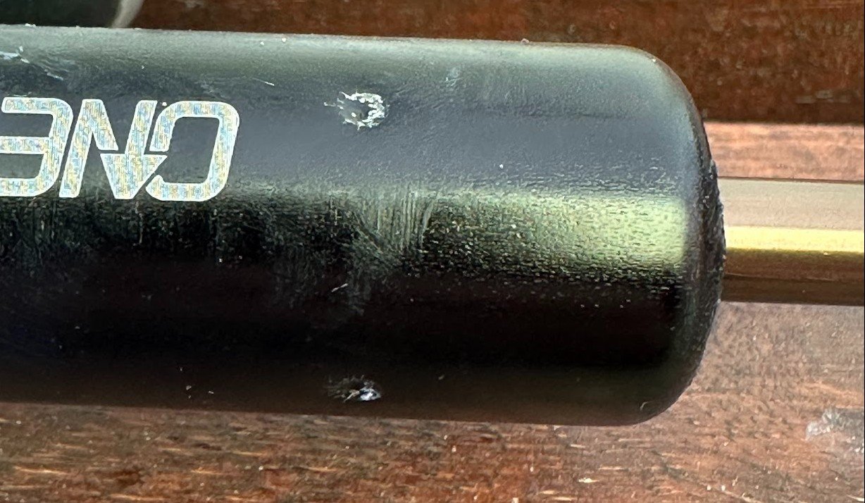

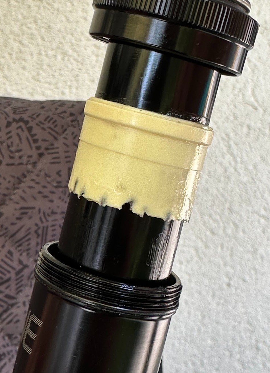

I think I found the cause of the rattle on mine. Took the dropper apart and noticed bushings are all chewed up and cartridge has visible dents on it from it hitting insides of the post. I guess it got loose after first 100-200km. I'm still waiting for response from OneUp
Few months ago serviced my OneUp dropper with the new service kit after 4,000 miles (naughty, I know 😏).
The bushings were of course worn but nothing like as ugly as yours. Will be interested to hear what OneUp says ...

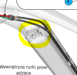

Yes, my Trak Rail+ has same problem, my solution is on picture. I contacted my dealer to see if an Abus lock would solve the problem. I waiting for answer
