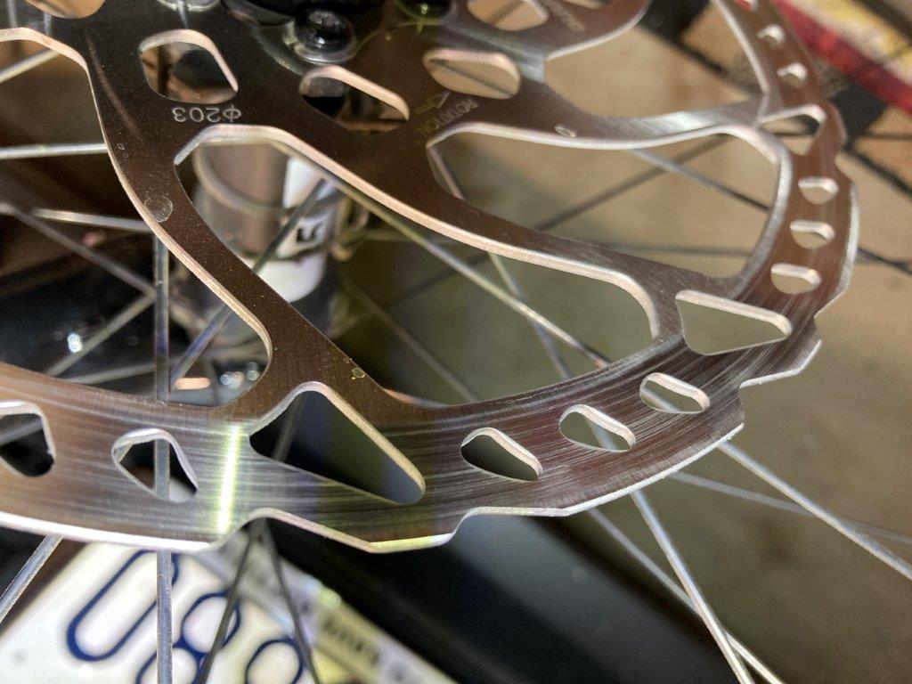

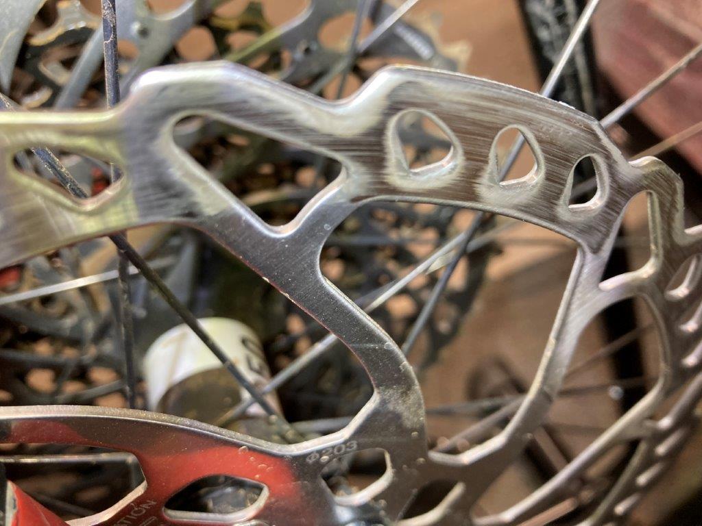

OK I finally had a quiet ride with zero squeals from my SRAM Code RSC brakes. And as I suspected the centerline rotors were the cause of all the noise. They are just not stiff enough at their 6 bolt attachment points causing a lot of resonance. The least expensive Shimano 203mm rotors (SLX, RT66 I think) produced zero noise and performed great. I love my SRAM brake now, lol.
sdcoffeeroaster
Jul 22, 2018
557
205
San Diego, CA
Here is another update on switch to shimano rotors. The one I used on the front came with the retail box. I only found the 2nd online at Commencal and it was an obvious OEM that came without the std packing and much less money but looked genuine. However it is not wearing the same as the std one I have on the front. The punched features look to be much more distorted and not making as much contact with the pads as the more expensive boxed version. I only bought the one from Commencal, still only $28. because I could not find them in stock anywhere else and they still are not in stock anywhere else. But they must be 2nds or knock offs based on this. Not noisy but this probably affect braking and cooling a bit. Seems to be a quality issue with the Commencal part and I've written them to question this.
