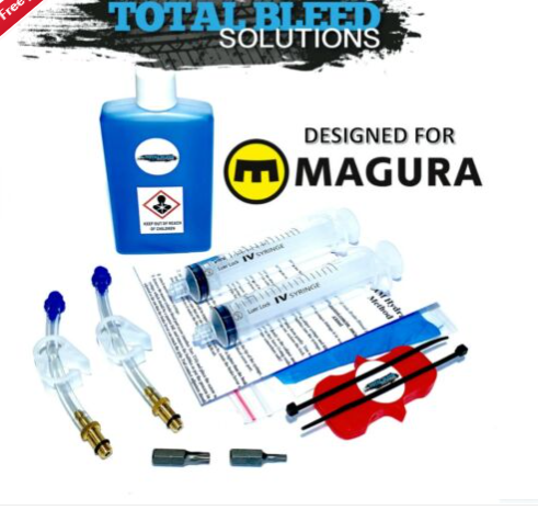

I ordered one of these kits from a UK supplier ( I see you're in Belgium but I assume you can buy similar locally) and I've bled 3 bikes and still have 50ml left.
You may find a quick bleed (just using a syringe tube in the reservoir and pumping the brakes with the brake lever horizontal) may cure the problem.
Also on Magura brakes be VERY gentle with the reservoir plastic screw as it is very fragile.

I've already bought a full kit on AliExpress US $4.53 29% OFF|Universal Bicycle Hydraulic Disc Brake Bleed Kit For Shimano Magura Hope Tektro Sram Avid Mula Hayes Bike Repair Tool Kit R0202|Bicycle Repair Tools| - AliExpress
As the local shop here sold a less complete kit for double the price. Only needed the oil.
I assume your oil bottle it 100 ml or 250ml?
