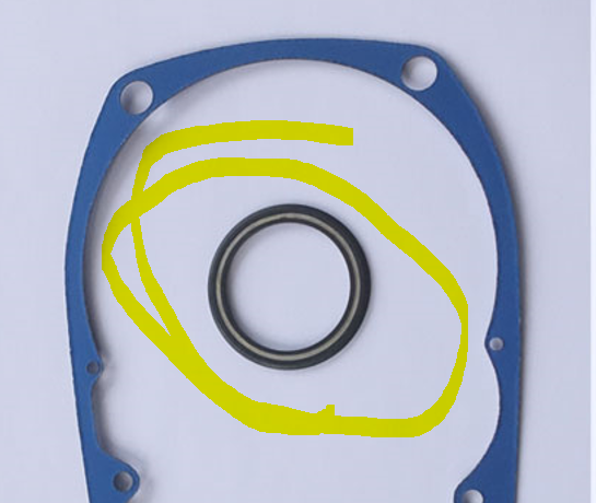

Hello guys, can you give the cue, please, about the size or/and article part number of the mudguard seal?
