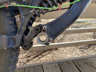

I know this thread went dormant a long time ago, but thought I'd ask if the OP is still having the bike run well with frame adjustments. Truly an awesome build! In fact, I ran across this, only after finding the exact same frame, year, model, and even color. I did not do as extensive of cutting, and just to get my BBSHD motor to fit, I still needed to cut out the bottom. So was hoping to ask if I still require welding.
(Edit: I re-read and see that you bent/bashed the frame, rather than cutting... but also see you later reference cutting on a different frame. I'm simply inquiring as you would likely know much better than me, and I may have ruined this frame already.)
Truly fantastic build! If you happen to see this, I'd be curious if you think the cuts to get the motor in would need welding. This was the minimum to get it to fit (with uttering). So any input is appreciated.
Again, awesome build. One of the best I've seen ever! I found yours online as I happen to be trying similar, but I may need input on the frame cutout before moving on. Thanks in advance!
