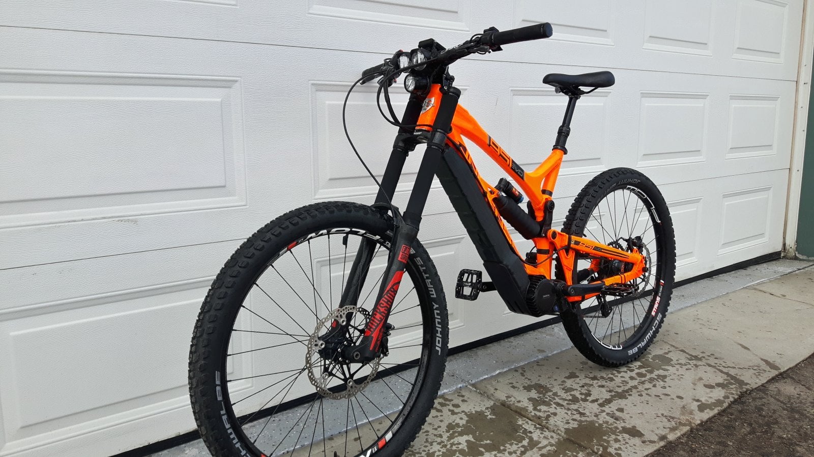

hello all.
here is my custom intense 951 Hyper E-bike build.
i was gonna call it a "super" e-bike, however after looking around i have yet to see anything come close to the performance of this bike both in terms of electronics and the donner bikes mechanical specs. so its a "hyper" e-bike IMO haha.
specs of this bike:
-BBSHD (1500w) motor
-1,600wh (1.6kwh) battery , (126 samsung-E 3500 cells, aranged in a 14S9P 52v pack)
-BMS is a 40A 52v with thermal cutoff.
-230mm rear travel (fox) with titanium spring
-203mm front travel (rockshox)
-220mm front rotor, 200mm rear, quad piston Avid brakes
-100mm dropper post
-27.5 FLOW rims, with johnnywtts 2.8" e-bike tires
-triple LED projector style lights (45w total) with triple horns
-11s drive
- comfort gel seat and gel grips
-62lb's (28kg) total weight
- aprox 100 km/hr top speed
-range as short as 50km as far as 400km's
please let me know what you think.

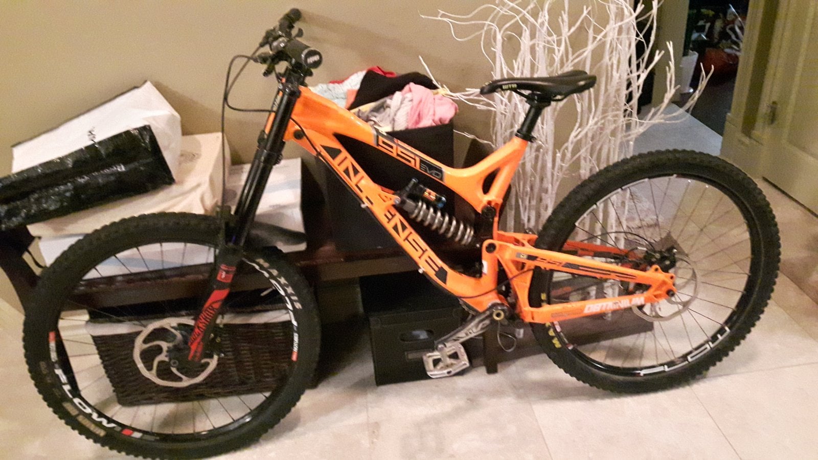

this is how it looked like before i started the project.
i had this bike for the entire 2020 season and racked about 2000km's on it before i started the ebike conversion in late fall.

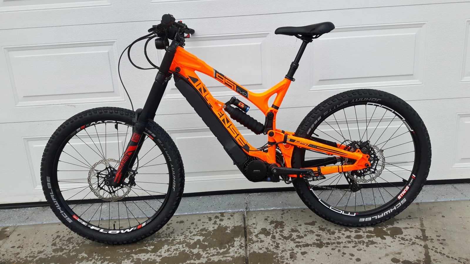

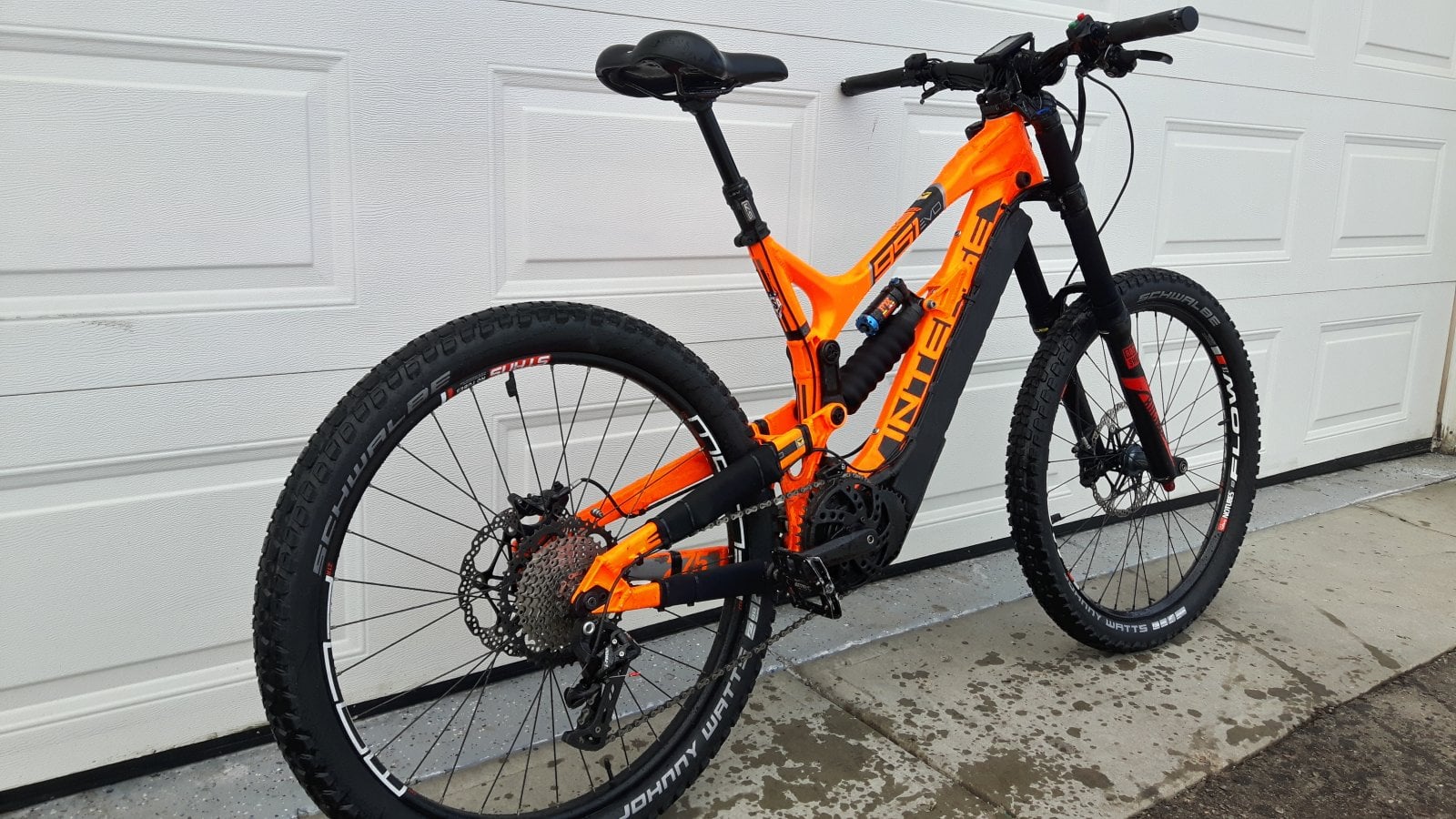

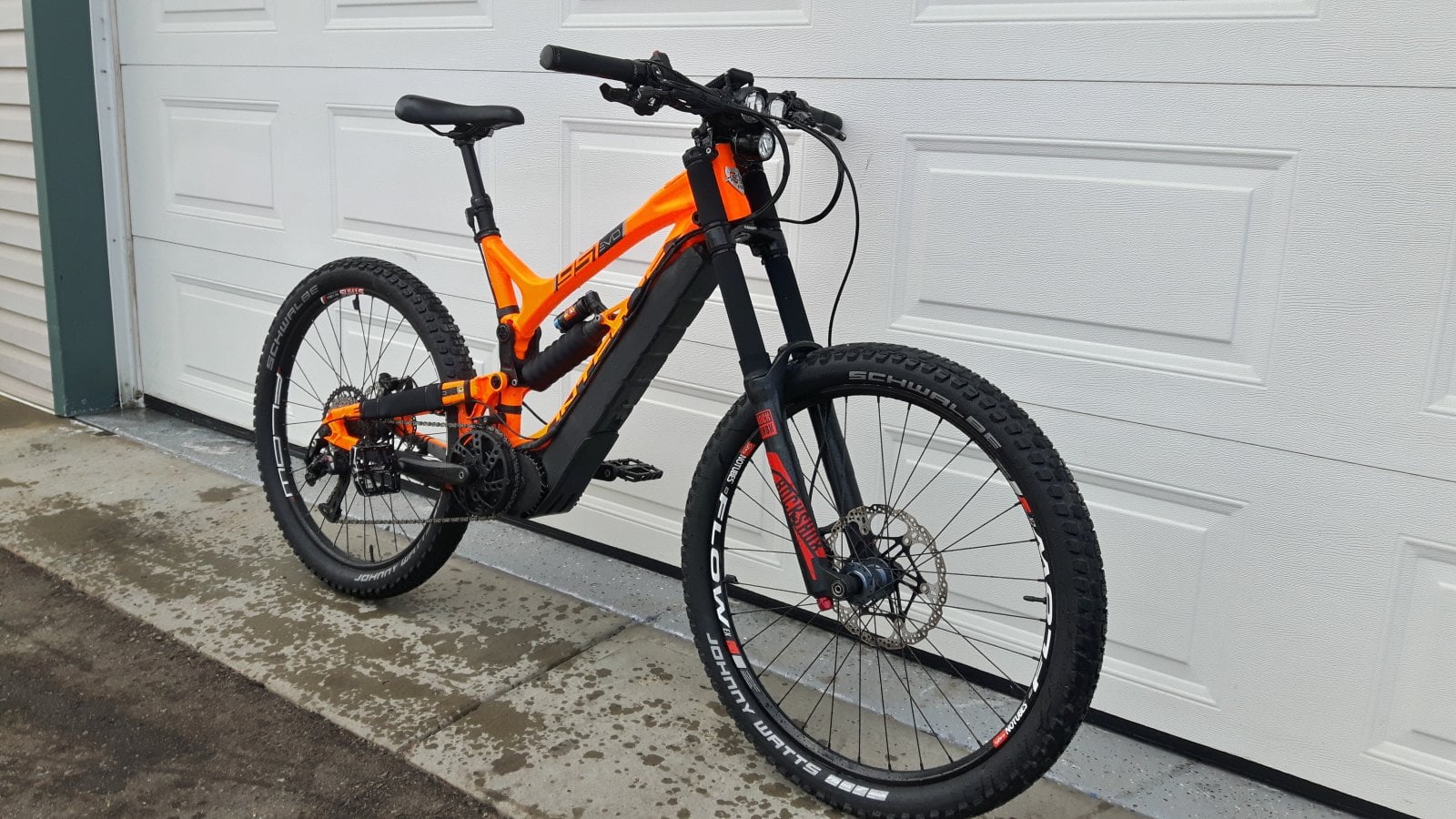

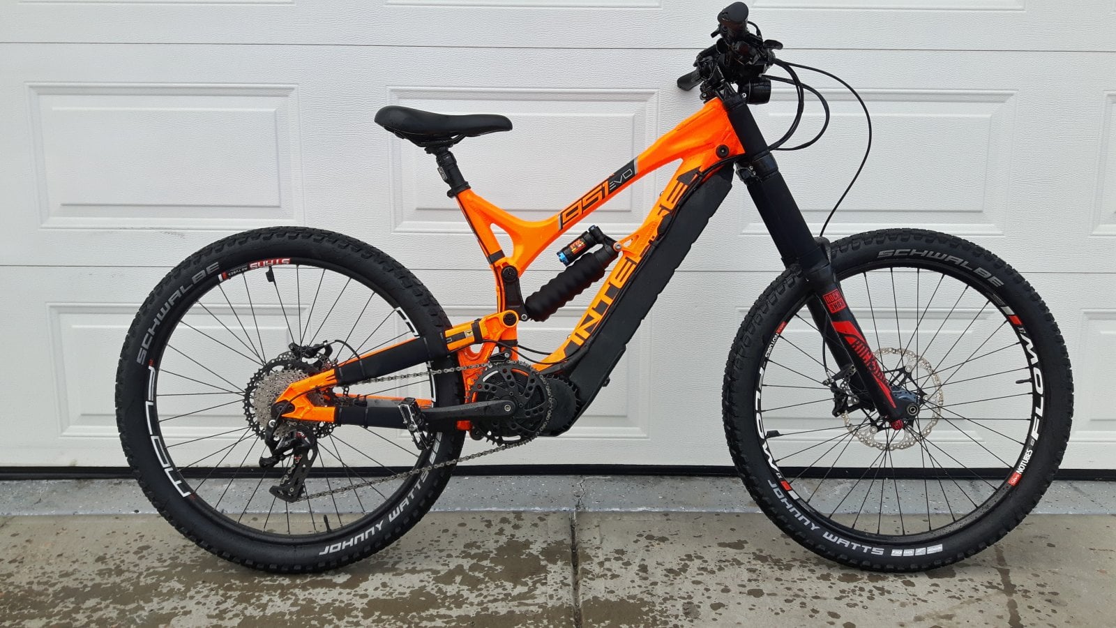

after i finished the conversion, it looked like this. i had a set of DHR2 and DHF on there but the rear tire wore out in about 1,000km's.......
so i ended up replacing it with the schwalbe jhonnywatts 2.8", so far ive ridden about 2,000 kms on these and the rear has hardly worn. so it stays!
obviously the DHR/DHF is a far stickier tire, but with over 1,800 peak watts running through the system the rear tire gets worn out way too fast.
it also wheelies in the 3 largest gears from start , so im sure that wears out the tire alot faster too...

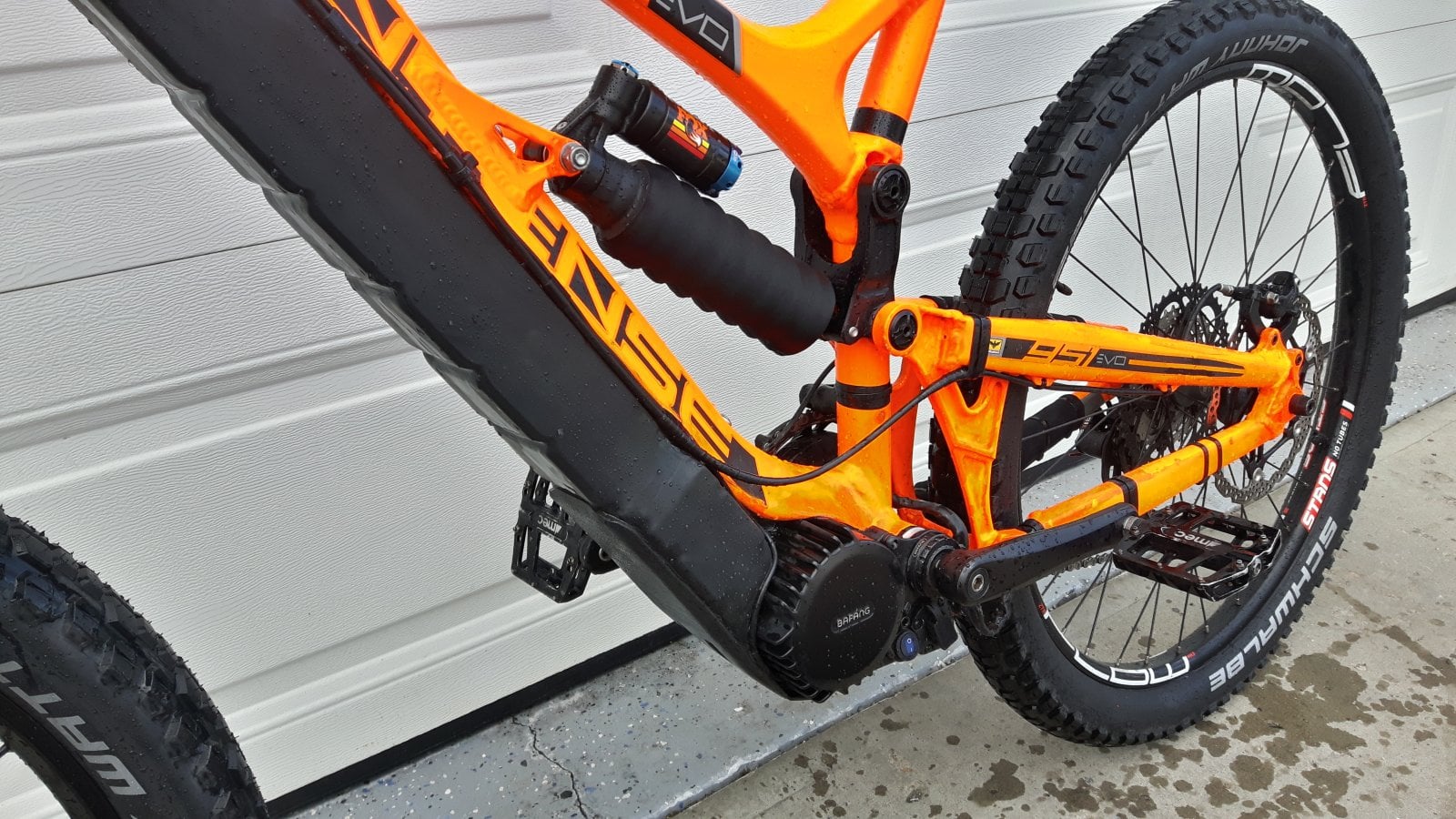

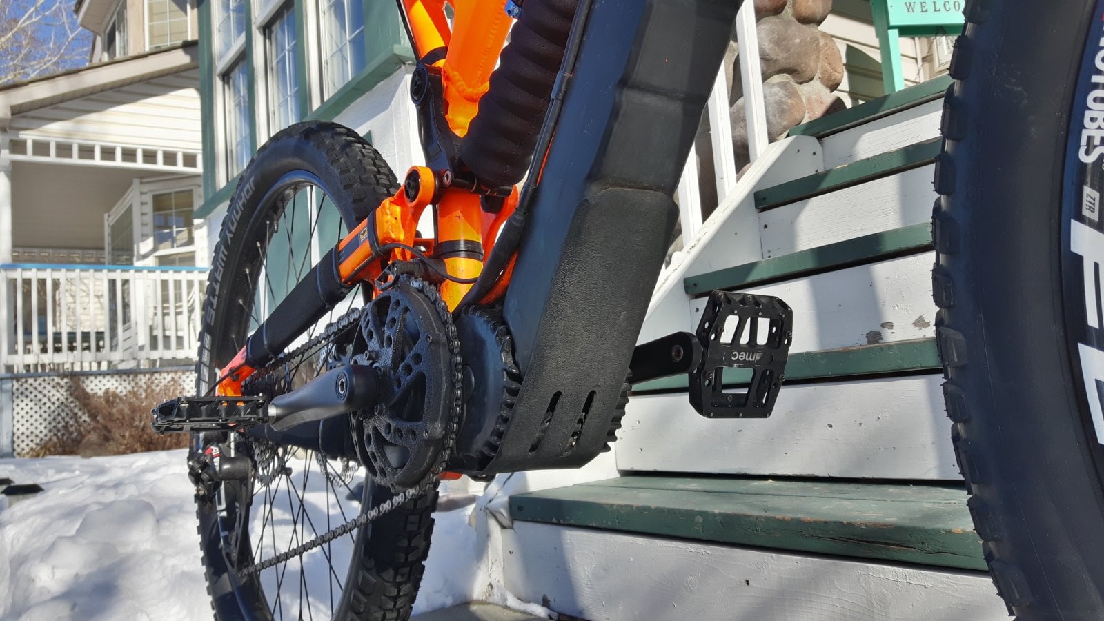

made a custom skid plate with two cooling channels for the controller and motor.
im loving the jhonnywatts tire also because they are far quieter and the improvement in rolling resistance gave me a noticeable improvement in range.
Ive since added custom neoprene protectors on the forks and the shock, changed out the rear gear to smaller ratios, painted the front sprocket, and tweaked the tuning of the controller via laptop to give me better power ratios in each mode.

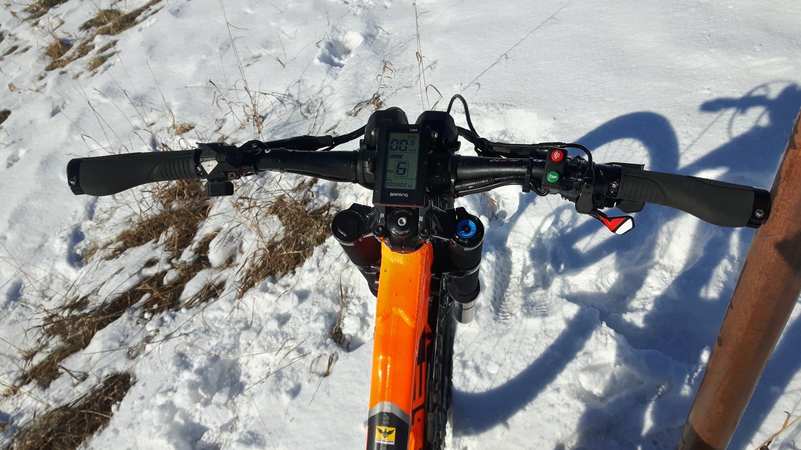

9 power modes:
level 1=60w
2=120w
3=200w
4=260w
5=350w
6=450w
7=650w
8=900w
9=1200w
and the thumb throttle overrides everything and gives me the full 30amps, which averages around 1500w as the voltage drops.

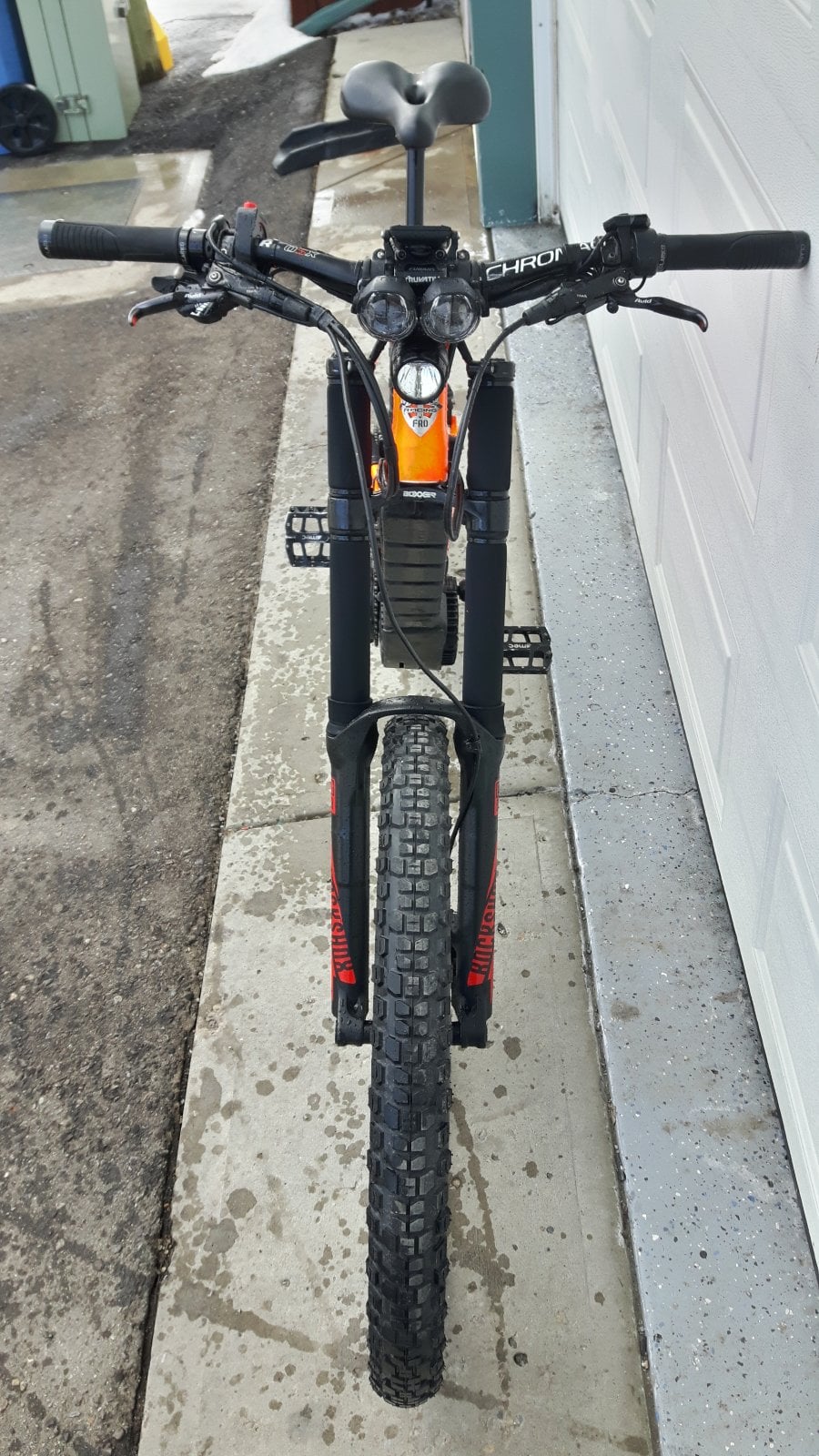

the lights are bright as fu#@$@ and have a nice cutoff as to not blind people on the paths/road.
the triple horns are loud as fu@#$%@# and i like it that way :)

What modifications did you need to make to the frame to fit the motor and battery?
michael.kozera
New Dad ! 👶
Feb 3, 2021
106
203
calgary
o. I forgot to mention.
I picked up the bike for 2g (canadian dollar) used. spent aprox 2g in parts. so total cost was 4g cad. maybe another 500$ for new tires .brakes rotors. and sprockets.
and of course alot of my time to make it all look and perform perfect.
I should also add. I milled out a motor heat transfer plate/cradle. it is sandwiched between the motor and the frame so heat can be transferred from the motor into the frame. basically using the aluminum frame as a giant heat sink.
michael.kozera
New Dad ! 👶
Feb 3, 2021
106
203
calgary
the battery is housed in a custom plastic enclosure which is then bolted to the frame through 3 small inserts I pressed in.
as for the motor, the bbshd unit goes through the BB as most know. but the motor "uttered" too much for my liking. so I had to bend the lower part of the frame alittle to make the motor come up. I then had to mill out a aluminum cradle/ mount to help reinforce the lower part of the frame. not really necessary IMO since I don't jump higher the a few feet usually. but I figured I'd put it in as a " just in case " .
an added bonus was this motor cradle helps transfer heat away from the motor and into the frame.

hello all.
specs of this bike:
-100mm dropper post
-11s drive
9 power modes:
level 1=60w
2=120w
3=200w
4=260w
5=350w
6=450w
7=650w
8=900w
9=1200w
top speed is aprox 100km/hr and pedaling cadence falls off around 90km/hr
without pedaling the bike hits aprox 70km/hr
range can vary greatly, as the shortest id ever got was about 50kms
while i once rode all day exclusively in level 2 (120w) on the road/gravel and hit over 400km's before the sun went down and i still had 10% battery life.
the bright orange and insane speed give me alot of looks and i do have to try very hard NOT to ride like a baboon. i rarly go above level 4 (250w)
I have to say that for me it looks better than the official Intense offering, congratulations on a very well executed build.
