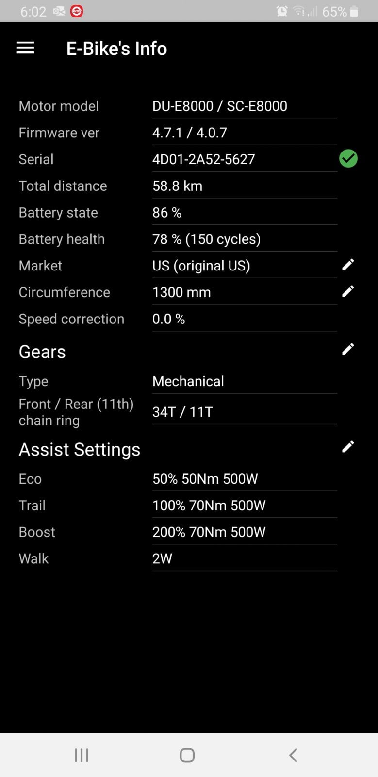

Approx 8000km on 4.5yr old battery. Original E8000.
Just bought a new bt-e8010, arrived today. Range was around half of what i used to get.
Interesting to see on the bottom of the new battery that the cells are produced in Singapore and the pack assembled in China.
My old original battery from 2017 had cells produced in Japan and assembled in China.
I hope i get the same longevity out of this new battery.
