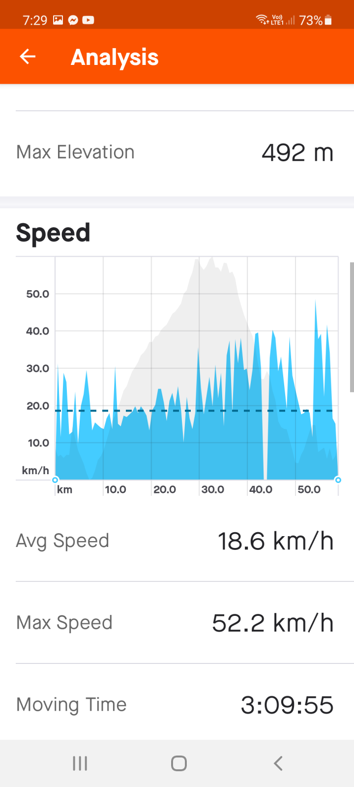

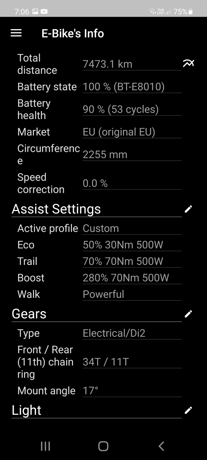

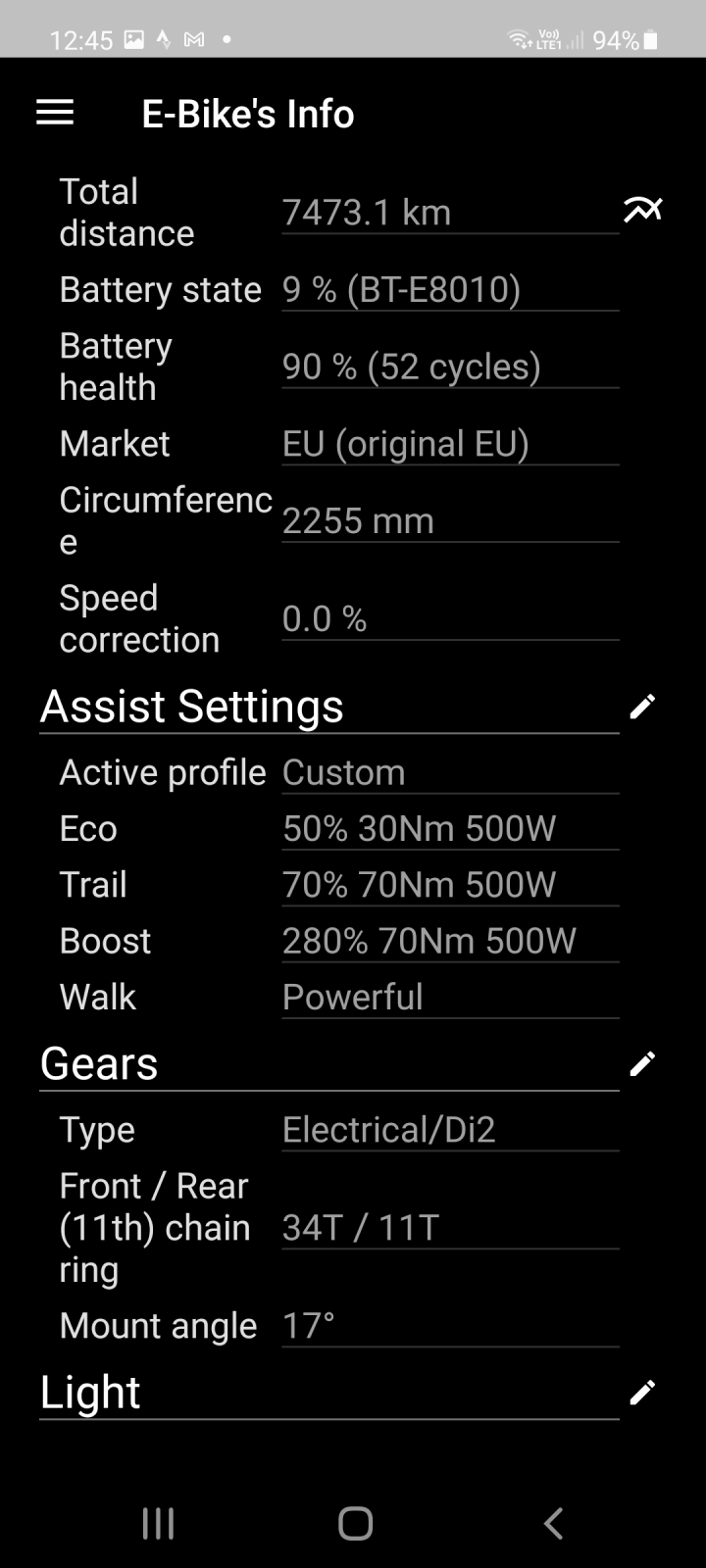

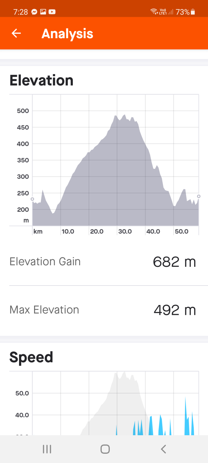

Ok so some data from today's ride. When this bike and battery was new, the possible (estimated) range indicated on eco was 100km. I havnt looked for a while but fully charged this morning it now shows possible (estimated) only 89km so a 11 km reduction. After a 60km ride today with approx 70% on eco and 30% on trail I achieved 60km to battery fully depleted. Yes I understand a lot of variables.. so battery info post ride shows 9% battery but can't select any mode incl walk, power for Di2 only. Attached are screenshots before a full charge and after. So still shows 90% avail at 100% charged. Approx temp during charge was 25c and took approx 3hrs before charger auto shutoff as my usual charge method. I checked and on eco the possible (estimated) still only 89kms ?. Cycle count increased by 1 as expected.
Ok so some data from today's ride. When this bike and battery was new, the possible (estimated) range indicated on eco was 100km. I havnt looked for a while but fully charged this morning it now shows possible (estimated) only 89km so a 11 km reduction. After a 60km ride today with approx 70% on eco and 30% on trail I achieved 60km to battery fully depleted. Yes I understand a lot of variables.. so battery info post ride shows 9% battery but can't select any mode incl walk, power for Di2 only. Attached are screenshots before a full charge and after. So still shows 90% avail at 100% charged. Approx temp during charge was 25c and took approx 3hrs before charger auto shutoff as my usual charge method. I checked and on eco the possible (estimated) still only 89kms ?. Cycle count increased by 1 as expected. View attachment 63420
Oh I should mention that my bike has been derestricted from pretty much new so provides assist up to final gear ratio which is around 46kph. Some ride stats below. This is not my usual type of ride. Normally full enduro, today was gravel trails no real tech and more about getting the kms done to use the battery.
