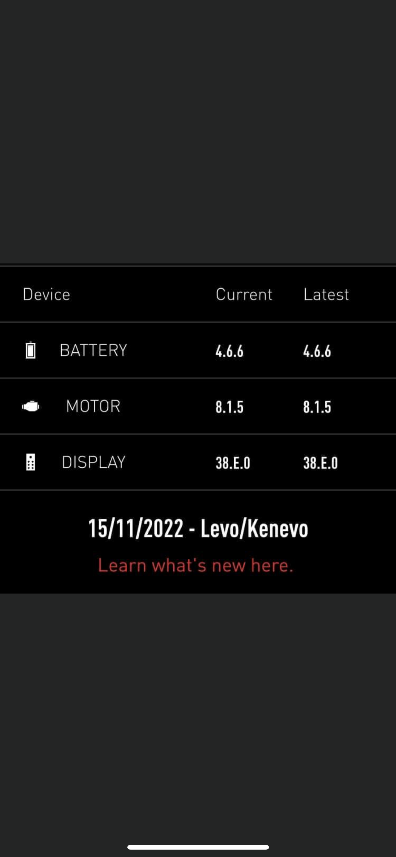

I def noticed a decrease in battery life since the update now my ep8 on my sc bullit blows away the brose setup on my sworks levo 2022 with same spec settings on our local trail loop , ride mainly in eco with some trail 20 miles 2k elev , levo finished with 39% remaining and my ep8 on the bullit 70% remaining somthing is def not right with this update my local shop updated my levo 2 days ago photo of my firmware enclosed
50A5DECB-BB9E-4260-81AA-FE22A0E2DC75.jpeg 7C258DD4-2AA3-48D0-A293-CAE52A22F90B.png
I looked to see when BLevo was updated. According to the App Store, the latest version is 3.7.9 and was released in June of 2022. So, technically, it is out of synch with the Specialized app/updates.
Anyone think that might have something to do with BLevo's difference in reporting?
