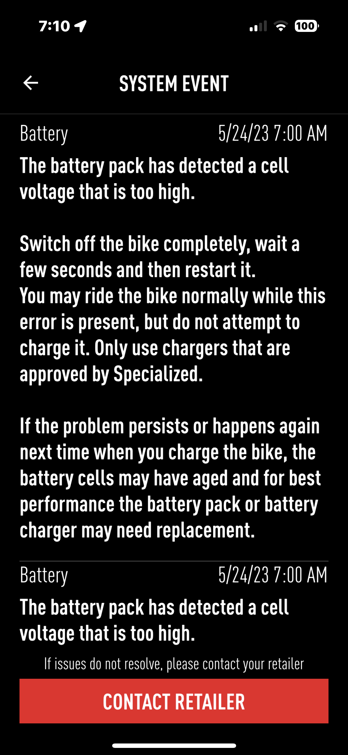

I had the battery update done a month ago. Since then, every time I charge to 100%, the TCU shows flashing red (1st bar) and blue (5th bar) which indicates a battery error. The diagnostic in Mission Control says that a cell voltage is too high with some additional info and that it may be the battery or charger. As soon as I start riding, the TCU error goes away, shows full charge, and everything works fine until I charge it again.
My LBS loaned me a charger, but the same problem occurs with it. Now they want me to leave the bike at the shop. I never had this problem before the update.
Has anyone had something like this happen?
It might be a good thing you updated the firmware. What if you actually have a faulty battery pack?
You've already proven it's not the charger.
It could be a bug in the firmware but why not have the battery replaced under warranty regardless.
It is possible that the new firmware is better at detecting battery faults. The bike is 2 1/2 years old so not covered under Specialized warranty but the shop I bought it from extends the warranty to 5 years. I’m bringing it in today.
