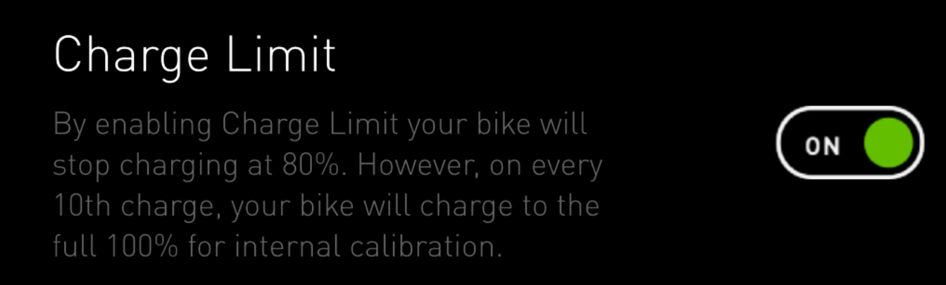

Just select whether you want the limit or not in the app. Of course, if you have the limit turned on you will have to turn it off to charge to 100%.
So you can actually turn it off ? They mentioned a toggle switch confirming it was on but I never found anything clear about turning it off again or maybe I missed it. I do require 100 percent quite a lot .
In the "Tune" page within Mission Control :

You can turn it on and off as you like and when turned on it will charge 100% every 10th charge for internal calibration.
I updated this using app earlier on . The charge limit toggles to on and then goes off after about a second. Saying system is up to date .
