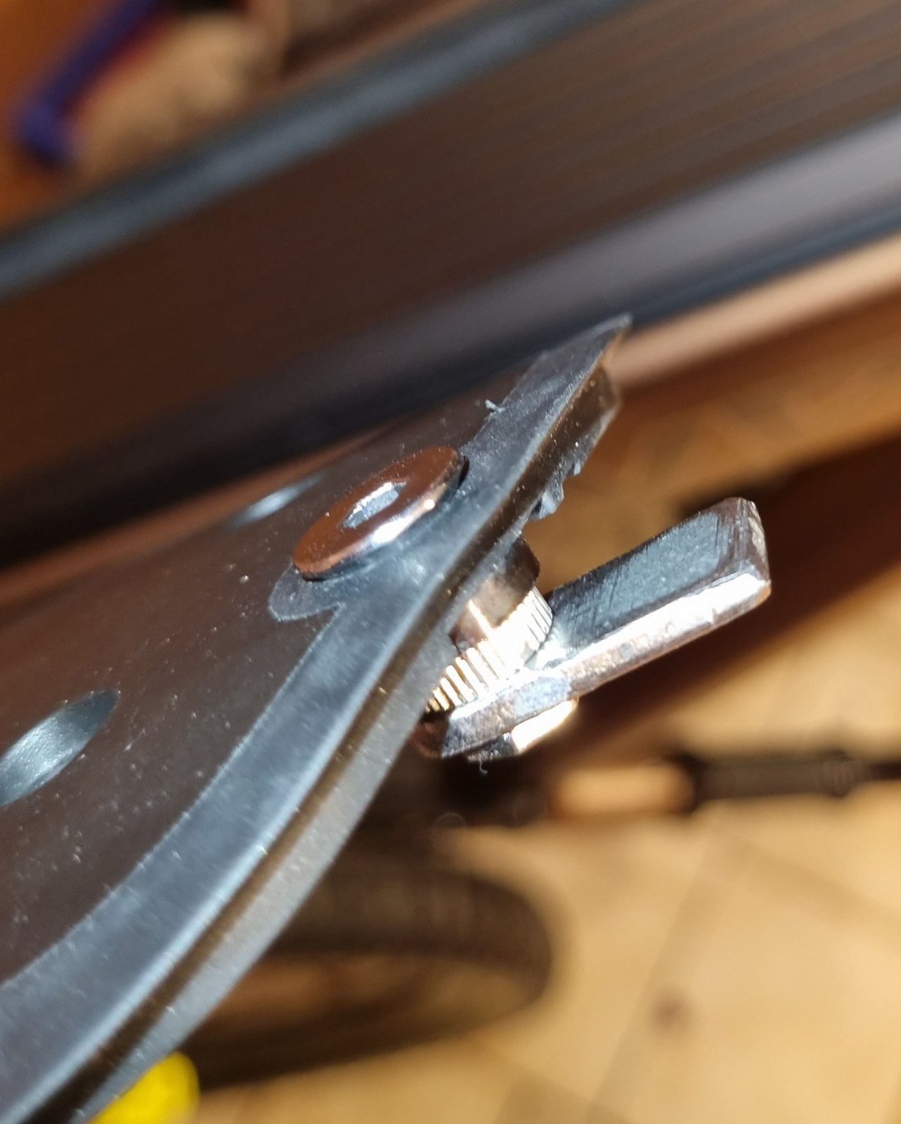

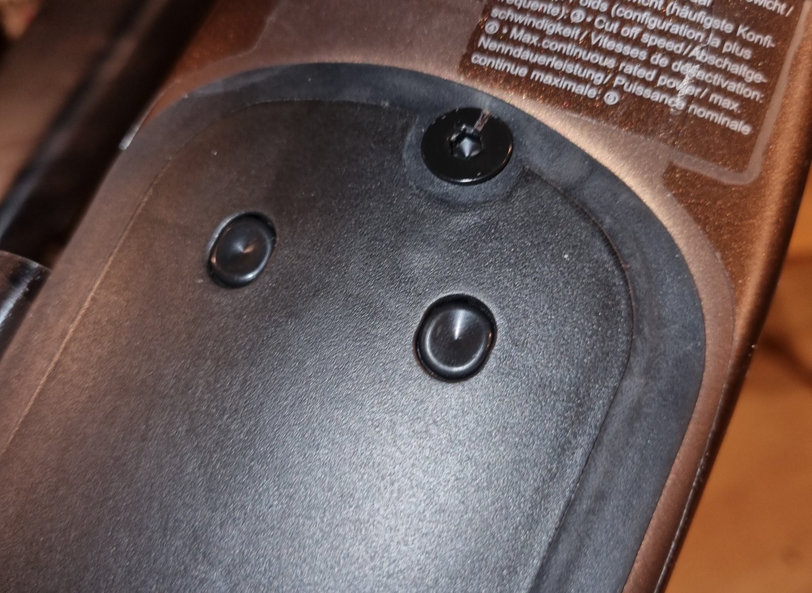

Hello Guys
Not much help from you, so I helped myself 😉.
Using a screw for fixing iscg chain guards, one curved washer from brake caliper fixation, a valve lock nut, a piece of aluminium and a flat nut plus some loctite and et voila, separated cover fixation.
Some rubber thread filler nipples for the four holes in the cover.
Battery clean to put it in the rucksack. Only one cover needed. Cover to close frame when transporting.
Have fun

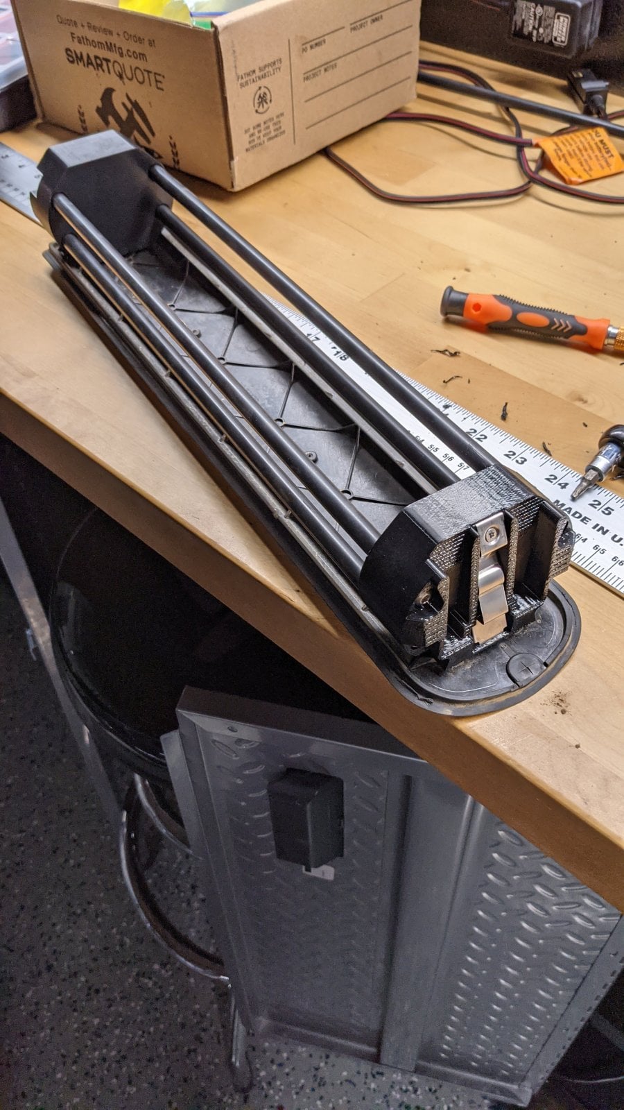

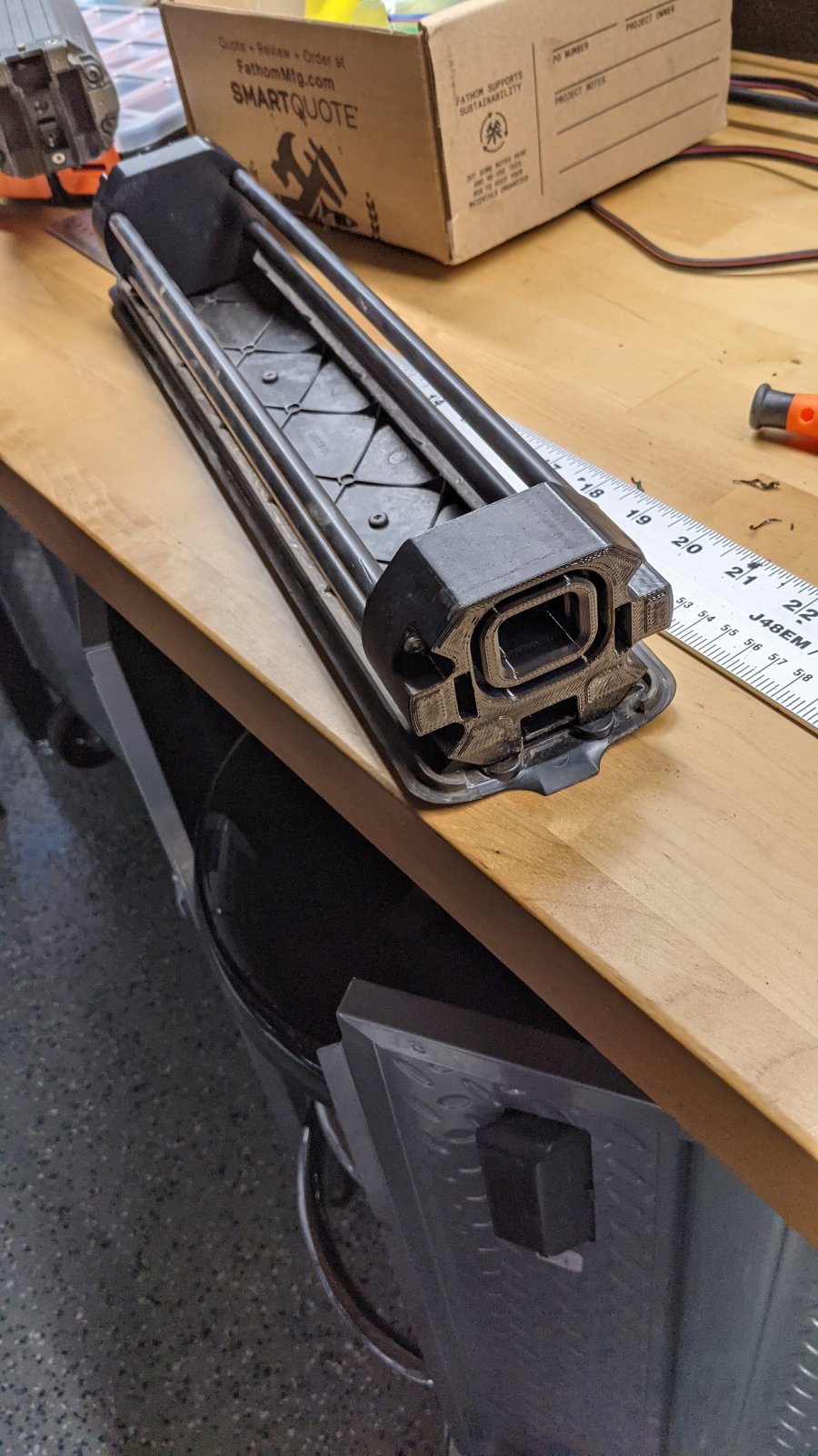

I built one using the OEM cover and some printed parts. It uses all the OEM mounting points and latching so it works just like the battery. Plug and play.
Works a treat when I am riding where emtbs aren't allowed!

As a one off, I think they cost me about a couple hundred bucks... The spring cost I would have to look up again.
You've made an awesome job 👌 would you be interested in making another set?
I can certainly make more, but they are not inexpensive so I am not sure it is worth it for you?

I don't want to steel the thunder from mdmtb, but mine is a much cheaper and more simple solution. In addition you can use the one cover with different batteries and without battery for zero cost, if you have some parts left in your bike part box.
Bye
All good! Definitely a more cost effective solution. I just wanted a plug and play option for myself.
