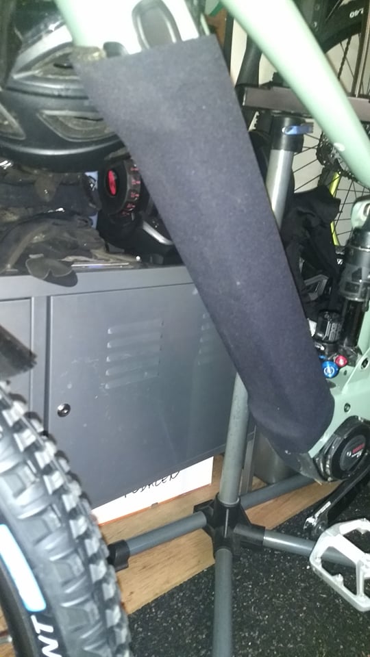

Check this out: Fahrer e-bike battery cover
I made a foto for you on my scott ransom eride without the battery:
9,185
Personally I wouldn’t take the risk of riding it aggressively without the battery.
IIRC the internal batteries from Shimano weigh more than the external ones because the casings are designed to take more load/stress due to how they are integrated into the frame.
potentially getting hold of a dud battery and stripping out the guys to use as a dummy light work, but I wouldn’t ride with nothing in there
