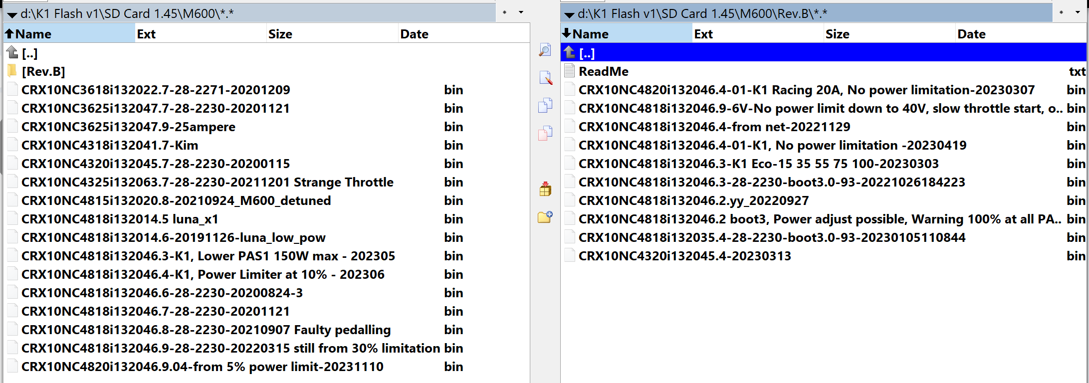

Hello Damien.
K1 Flash dont care about serial numbers of controller or passwords and will run calibration, also you can flash firmware. A lot bin files coming on SD card.
Consider also upgrade to M560 in the future - much much better motor.
