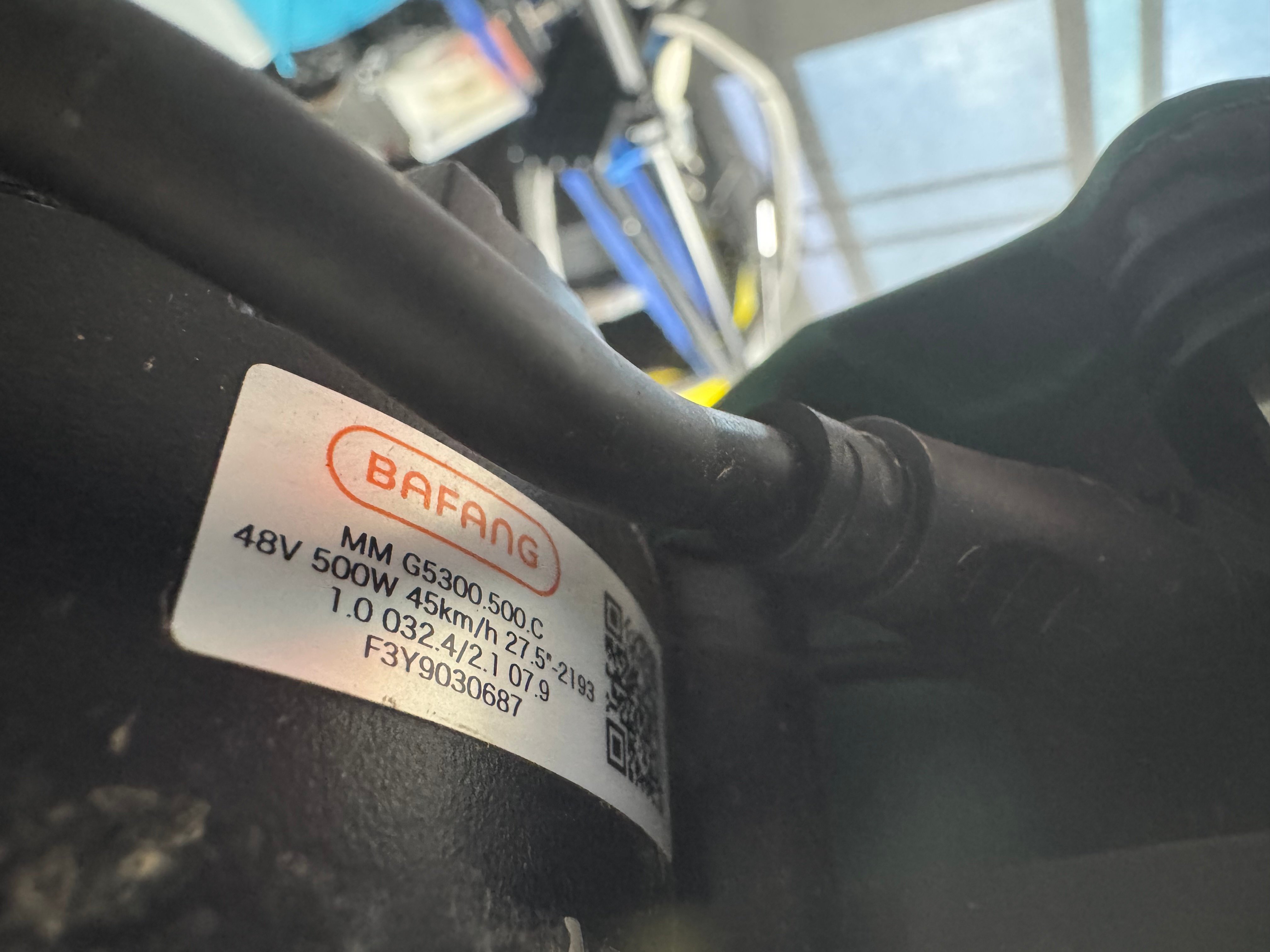

Hi all, first post here. Recently bought an eMTB with Bafang M560, this thread has got some good information in, thanks for sharing.
I’ve deduced mine is a new 500W as it has a sticker (not etching) and has only been offered for my bike for a couple of months, replacing the M510.

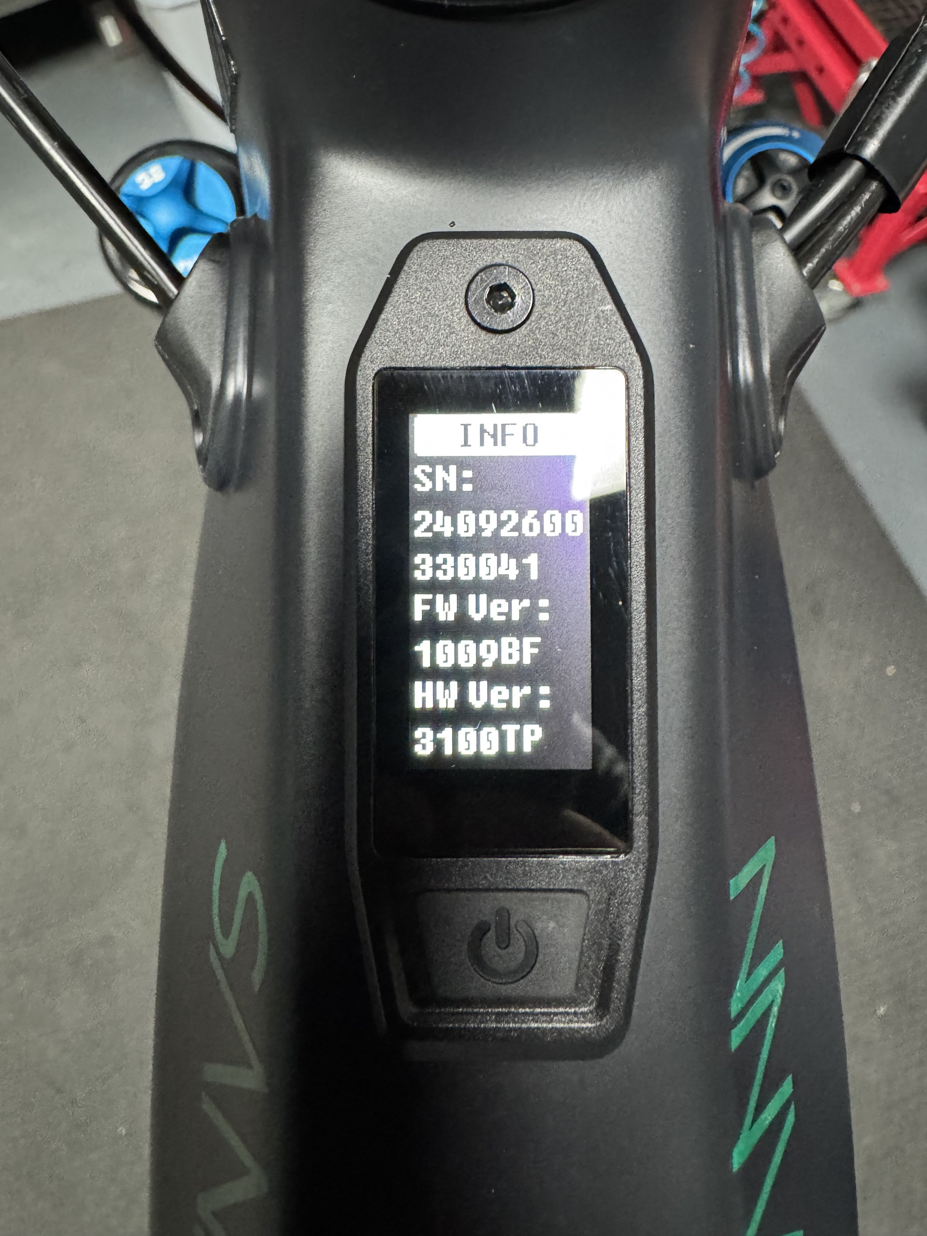

Can you show us the firmware version and does it have massive overun when you stop pedalling?
This is what I see from the info section of the bike display. 1009BF.
As for overrun, it's a fraction of a second, just enough to skip a pedal if I need to glide over a rock. I certainly wouldn't want less overrun. With my limited experience i'd say the overrun is perfect and consistent with my friends M600 on a similar bike.
Can you screenshot from the bafang app? This info is not very clear with regards of the controller fw.

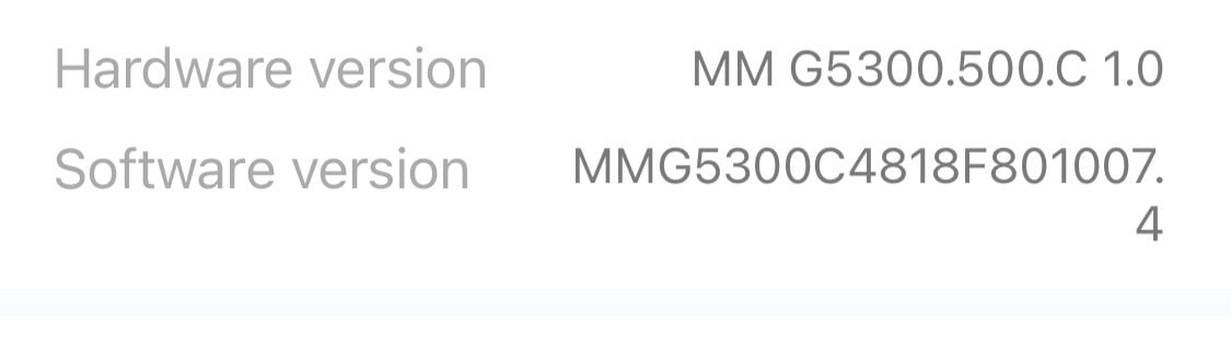

Unfortunately I can’t access the Bafang app with my bike according to the brand (Hybridizer). I tried anyway and the app won’t find my bike so I guess they have a tweaked FW. The screen (in frame) does have a Hybridizer splash screen so I assume this.
According to them my FW version is MMG5300C4819F801007.4

You need DPC245 v3.0 and also good firmware there - v1.2 works. And maybe also correct controller firmware.
Anyway that version 7.4 you have I am not sure if is OK, that 7.4 versions was very first beta test version. I would reflash to 25A (instead of your 19A) version - much more fun.

Thanks. What would be the difference and how do you suggest I update it?

If i am not wrong, the 25a has different bootloader. The first gen may not be able to flash it.

Yes, there was some controllers with different bootloader. Looks like it was USA version of motor in the begining(now there is max 750W version, and 500W).
I have firmwares also for this motor version. Also one USA motor on the bench for testing. ;)

Do you have the 750w for this firmware. 1st gen m560.
Yes, I do have. From HW or SW version we dont find out if it is USA boot code motor version. You just find out when you will be flashing if refuse or not. But definitely I would flash with 25A firmware version . You have now 18A.

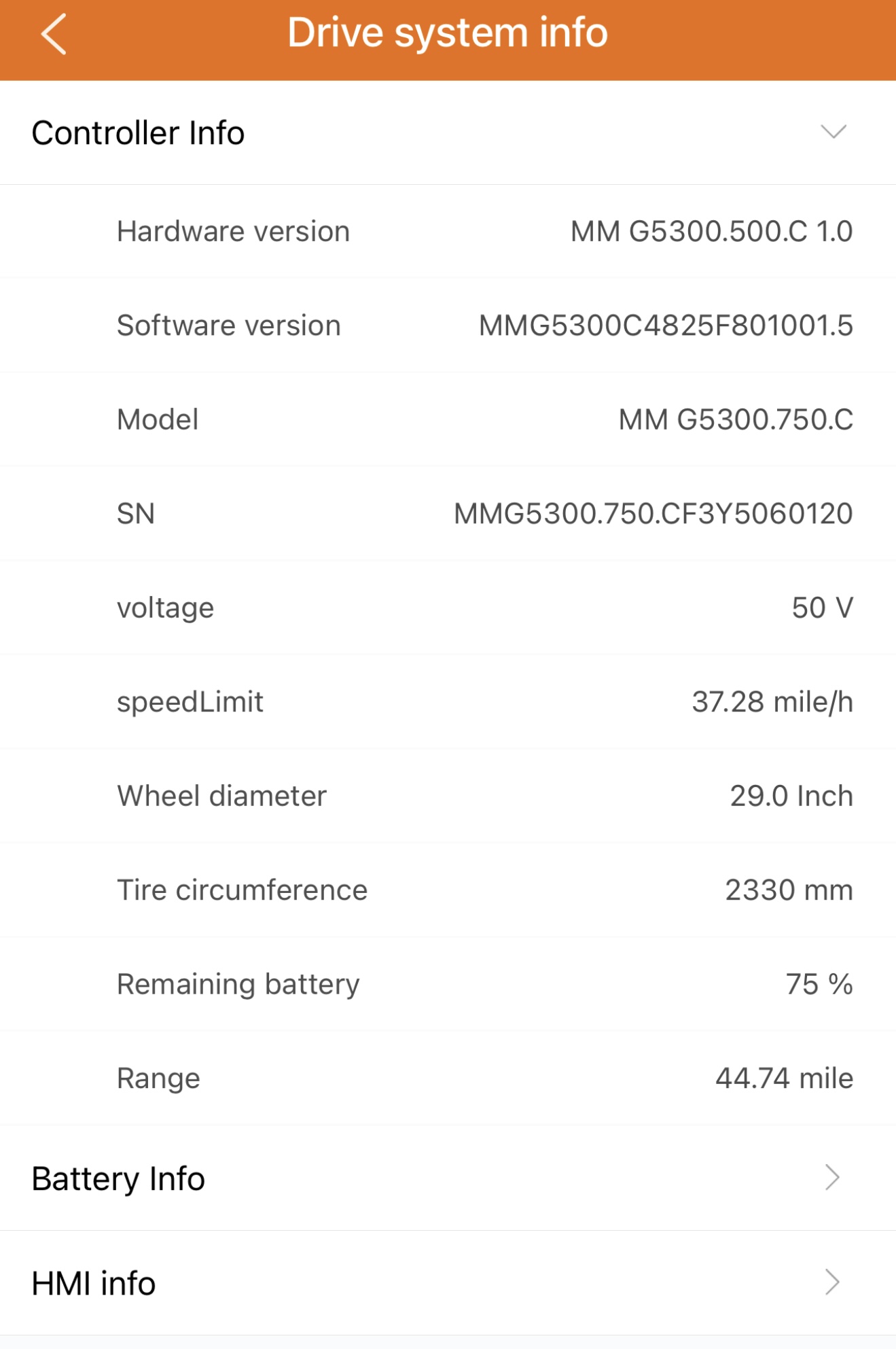

Here’s what my 750W “quiet version” shows. I set the speed limiter/circumference in BESST Pro but it's the firmware that it shipped with. I think this is still the current one for 750W or did they release something newer since? I know I've seen a newer 500W come out since I got mine.
Yes, have not seen other version then v1.5 so far.

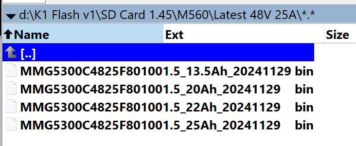

Have just some v1.5 compiled for battery capacity (which is stupid from bafang, why we can not set battery capacity over Besst?). Usefull for people with DYI battery with no CAN communication to show "good" range estimation. Range estimation by Bafang was never accurate. ;)
